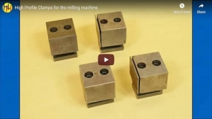

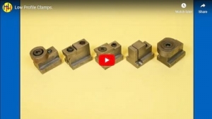

    Low profile clamps are available commercially but my high profile clamp, called that because they are based on one of my low profile clamp's design I think are unique. This, unless you compare them to the two piece vices which are available.
    There are five designs of the low profile clamps so you have a choice of which to make.
    The pages on my website relating to these can be found here
    There is just one design for the high profile clamps.

    I made some of these clamps a couple of years ago for my little bench mill and they have been a real boon. Thank you Harold!
