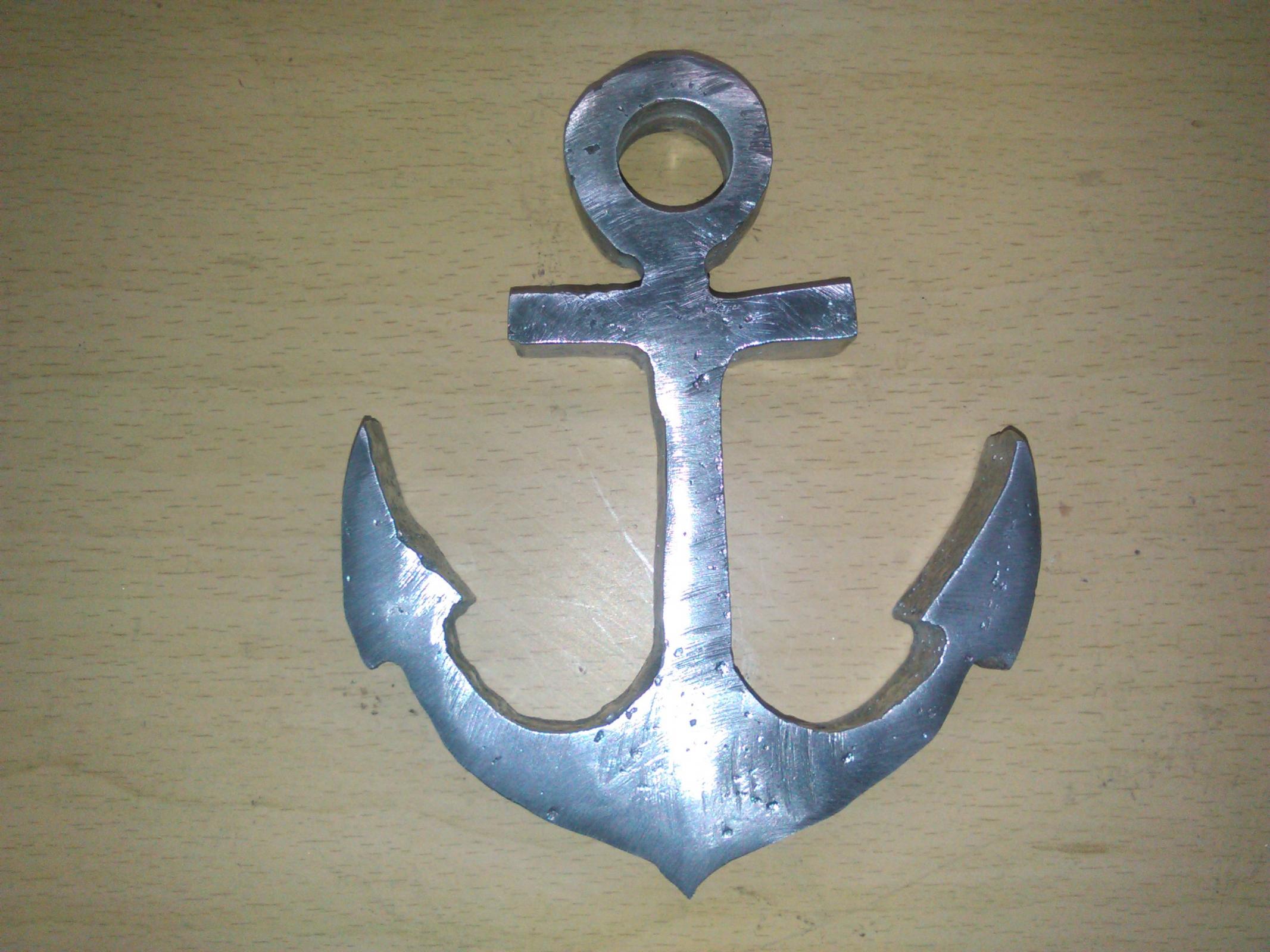

    LOST STYROFOAM CASTING

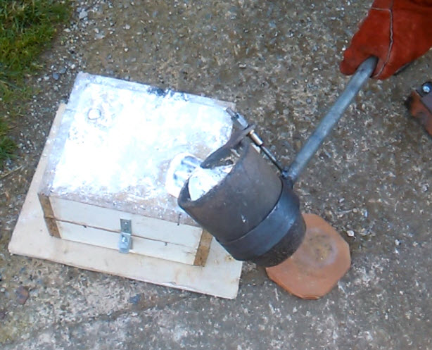

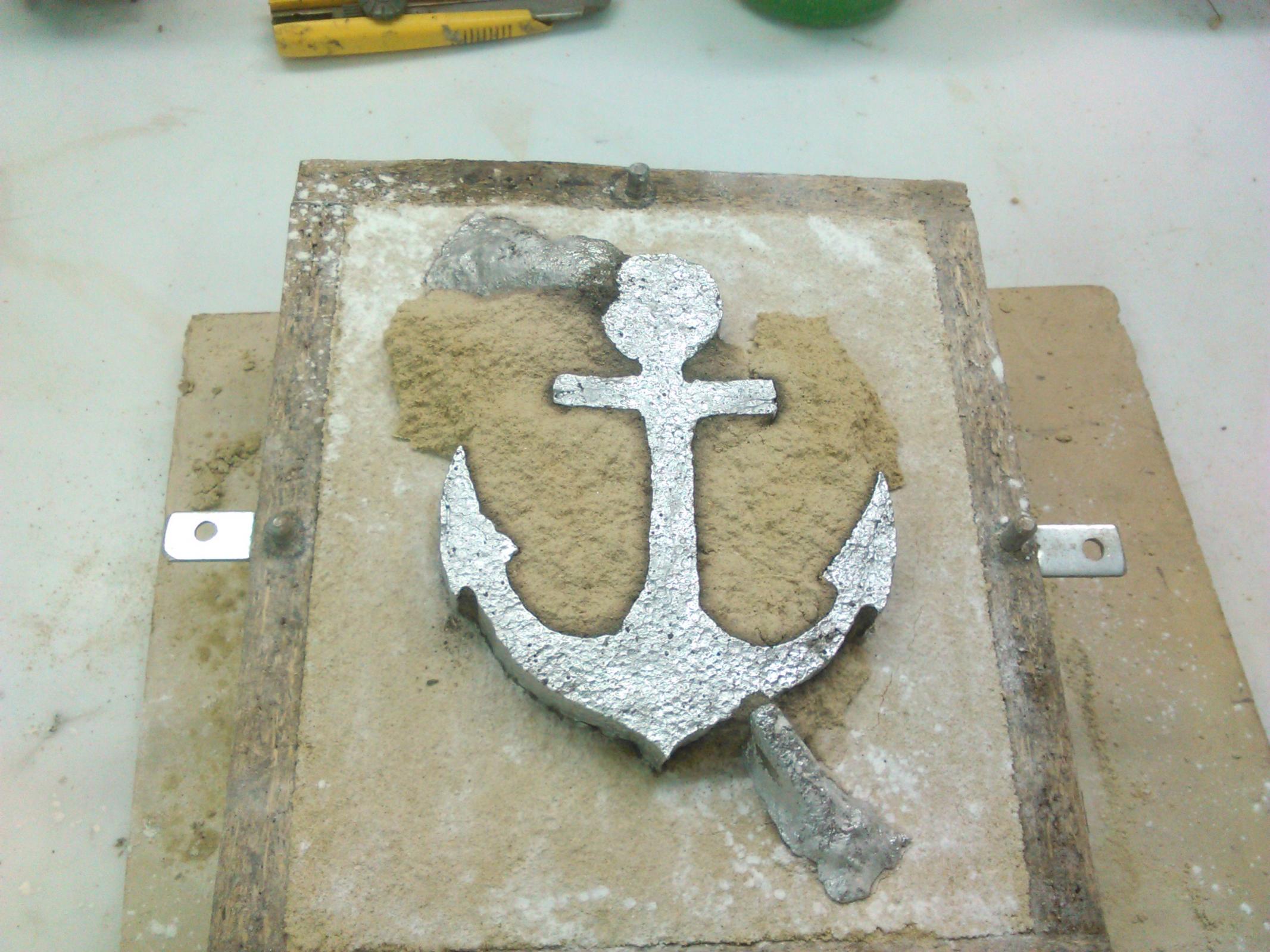

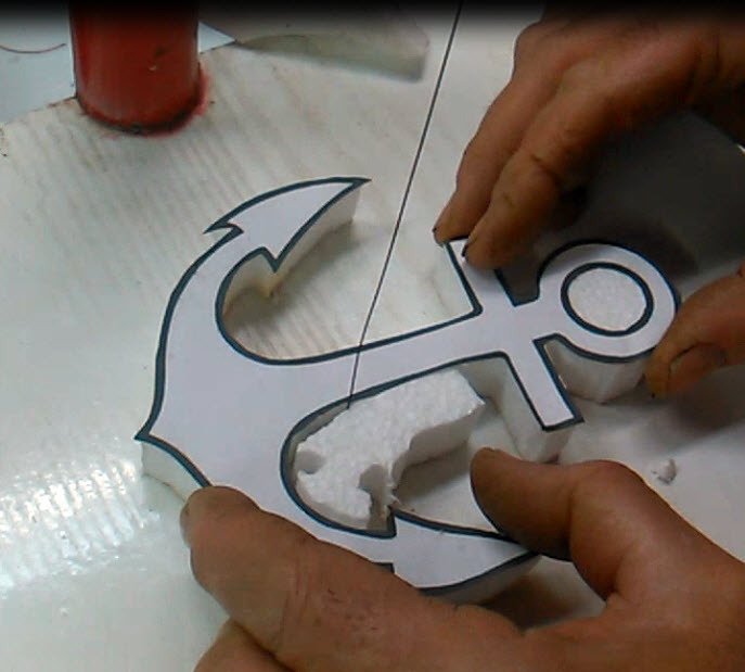

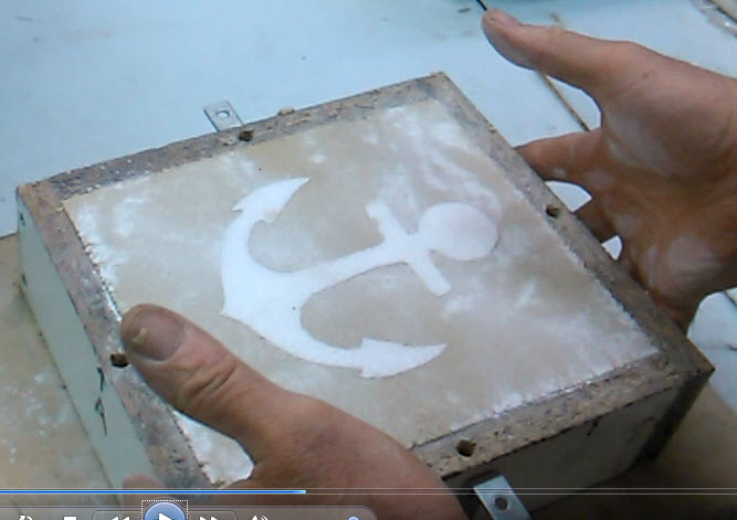

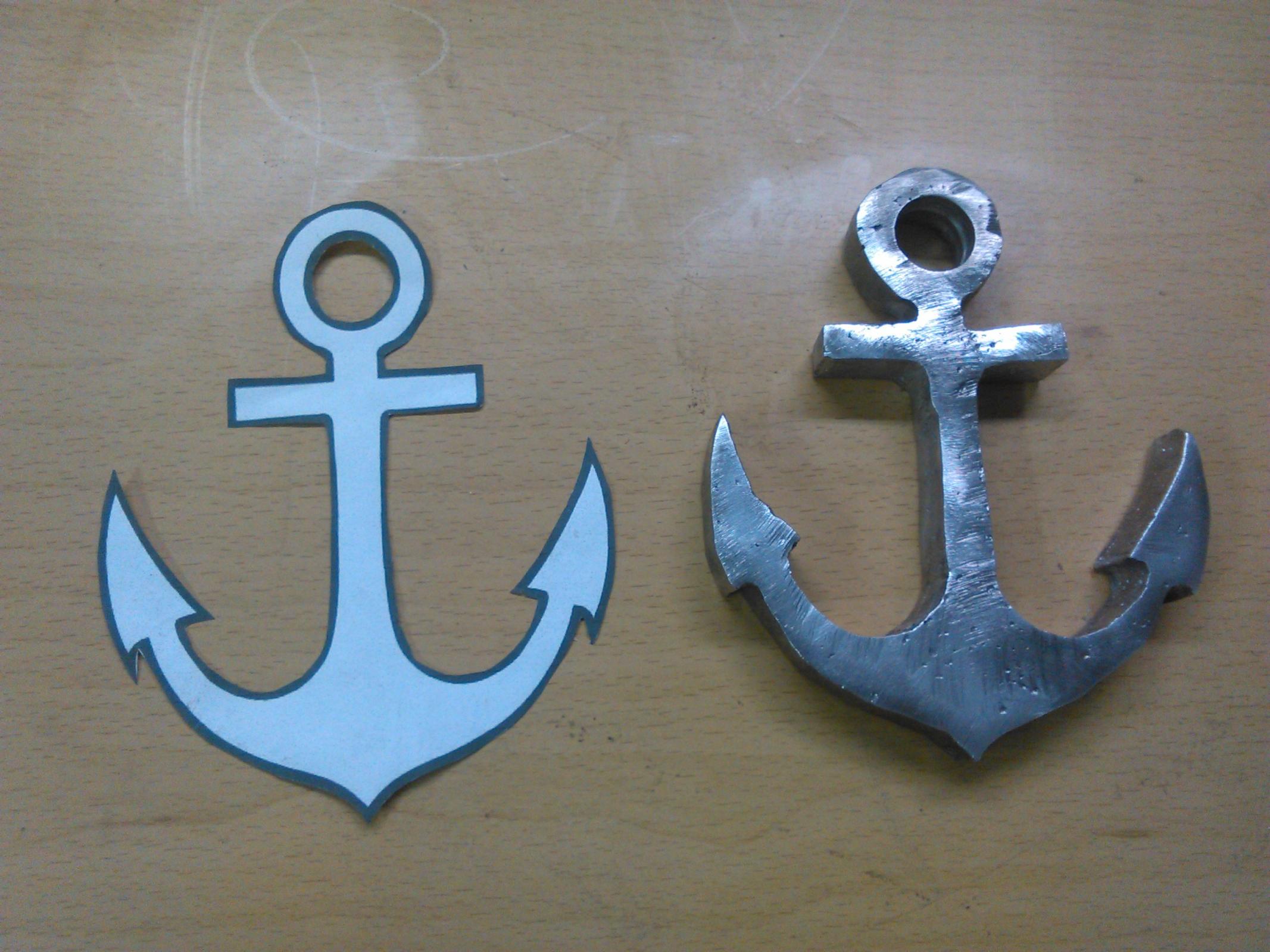

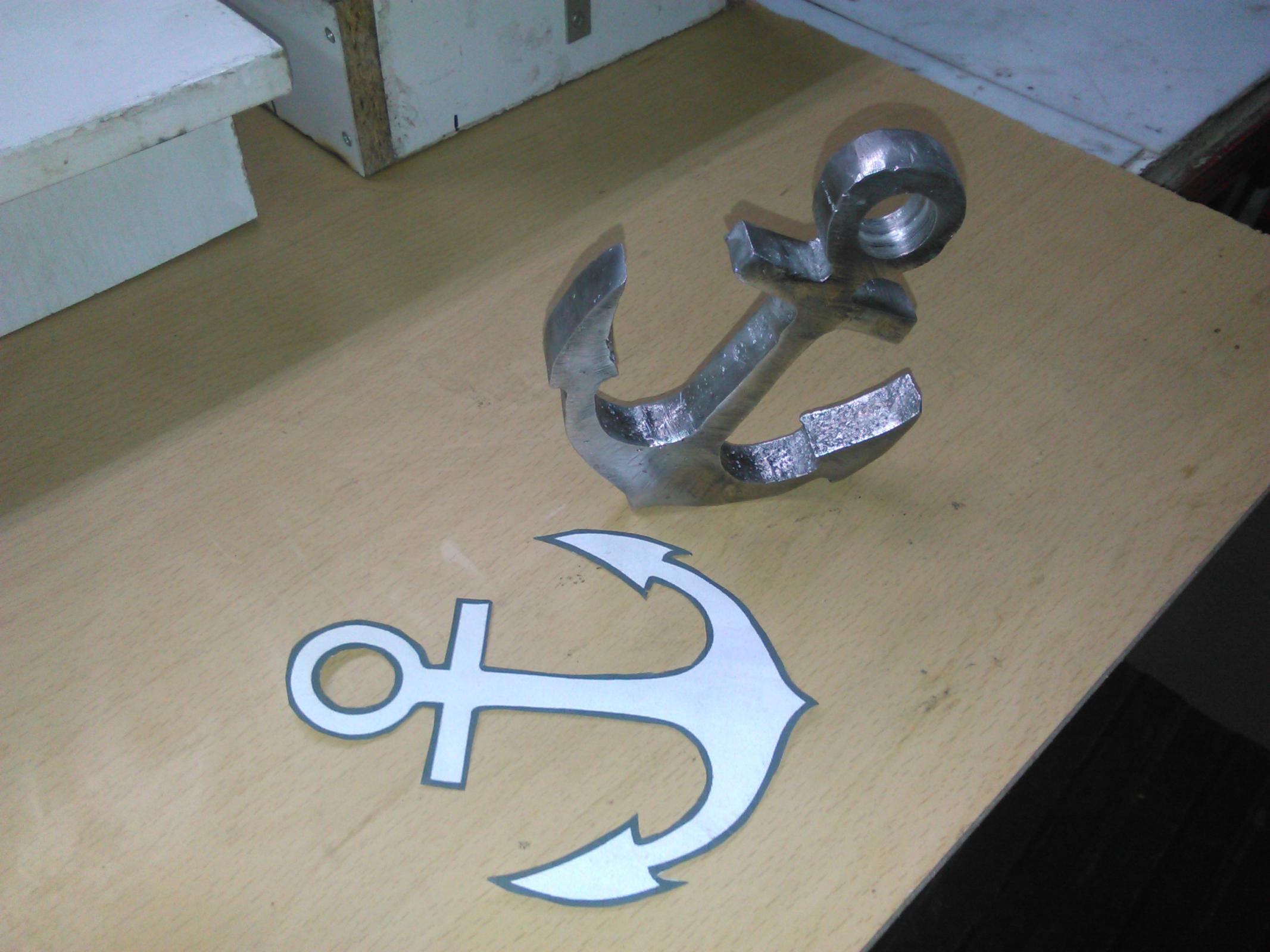

    In this video I ' ve tryied to melt metal with a different way using styrofoam. The hot metal melts the styrofoam and fills the mold.I've used 150-180 gr betonite in one kgr quartz sand. I've put also a little water.
