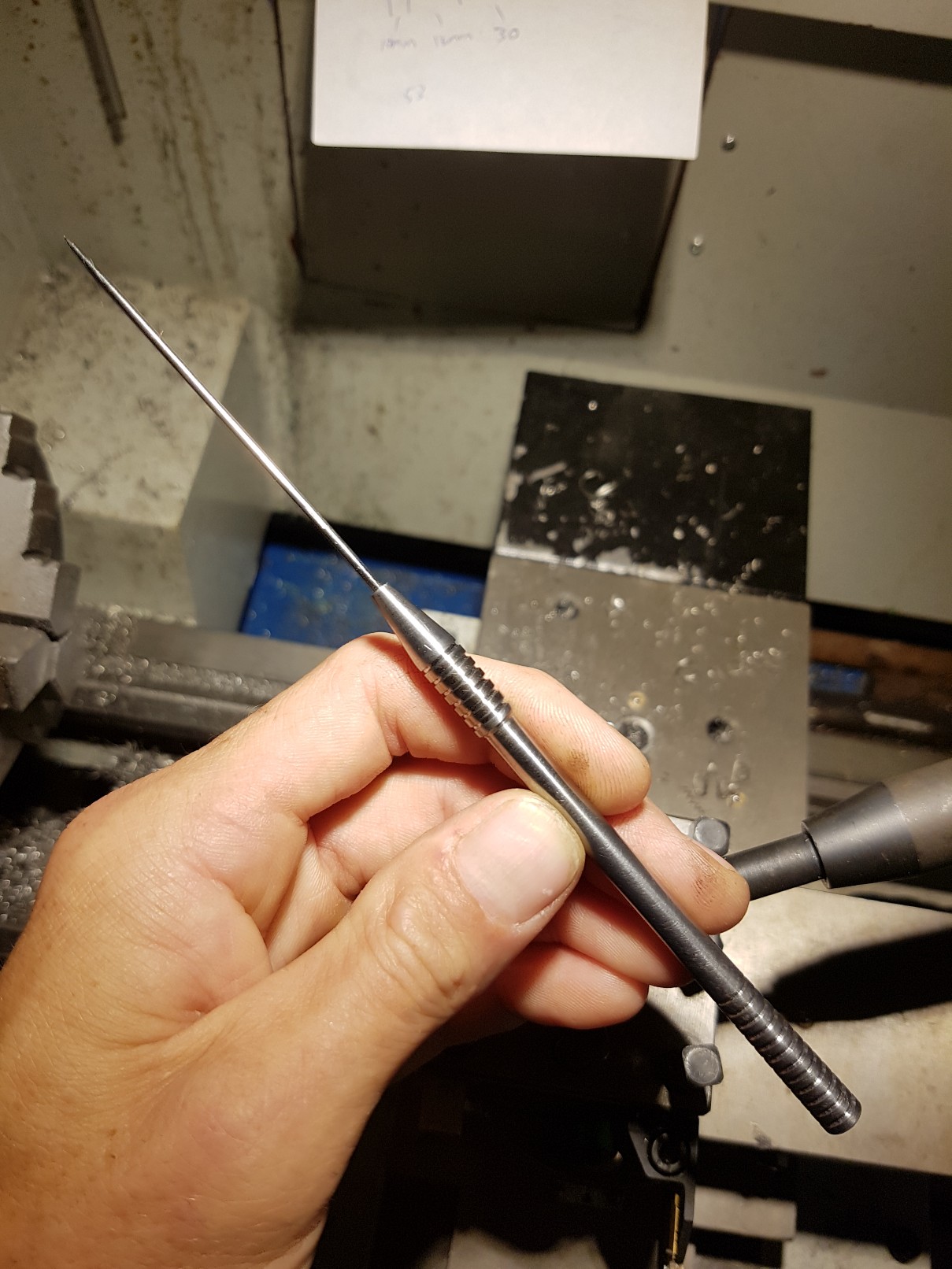

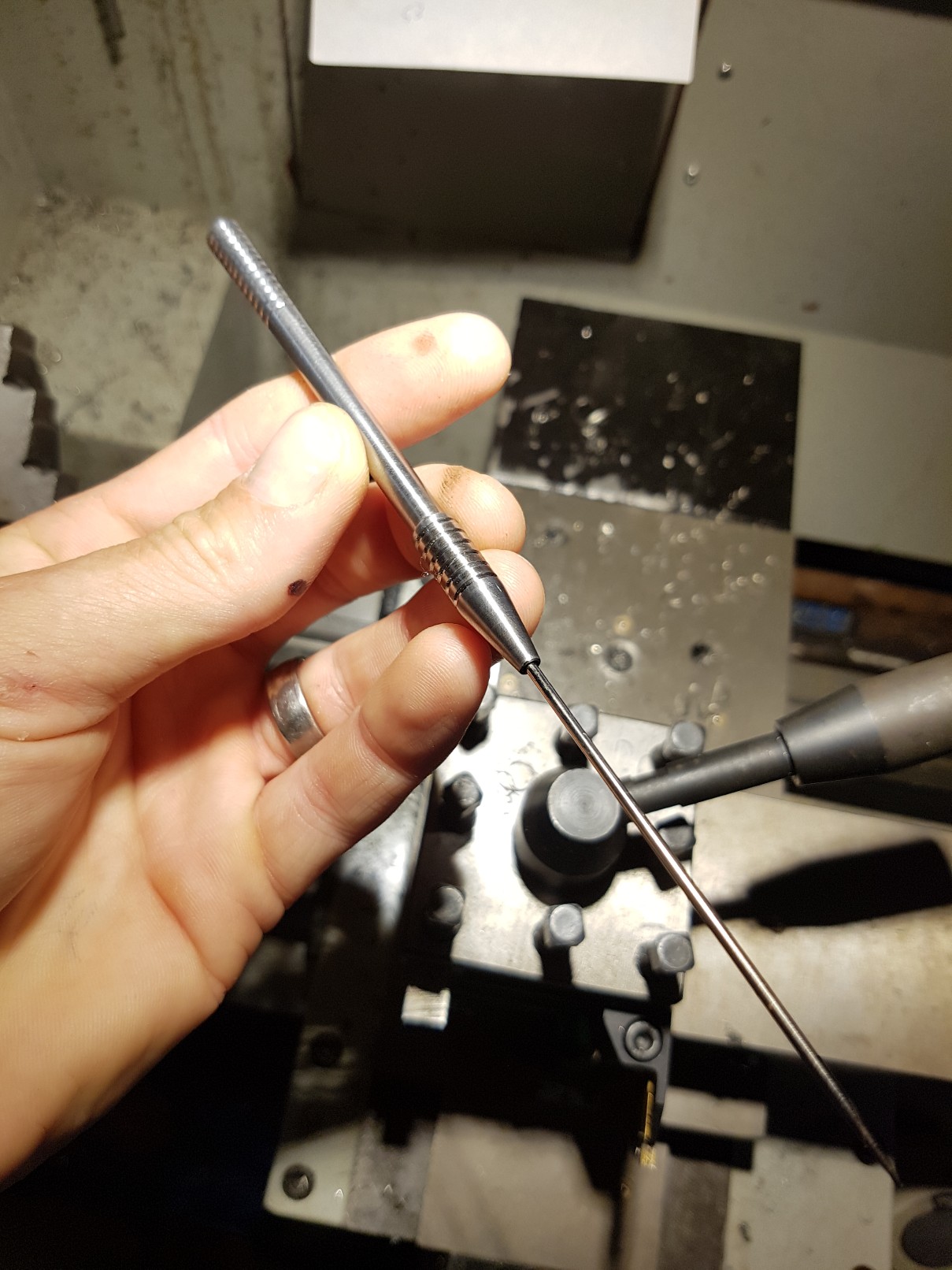

    Hello fellow diy tool makers!
    Here's my home made long reach scriber.
    I turned the body from a piece of 8mm steel rod recycled from a large photocopier and the point is a large sewing needle pilfered from the wifes craft room.
    I drilled a 2mm hole for the needle and it press fits in without any adhesive.

    Thanks Baskarz, I like a longer scribe also...seems to give more control. Nice handle too, especially upcycled from a copier...good luck if your misses finds out! ~¿@
