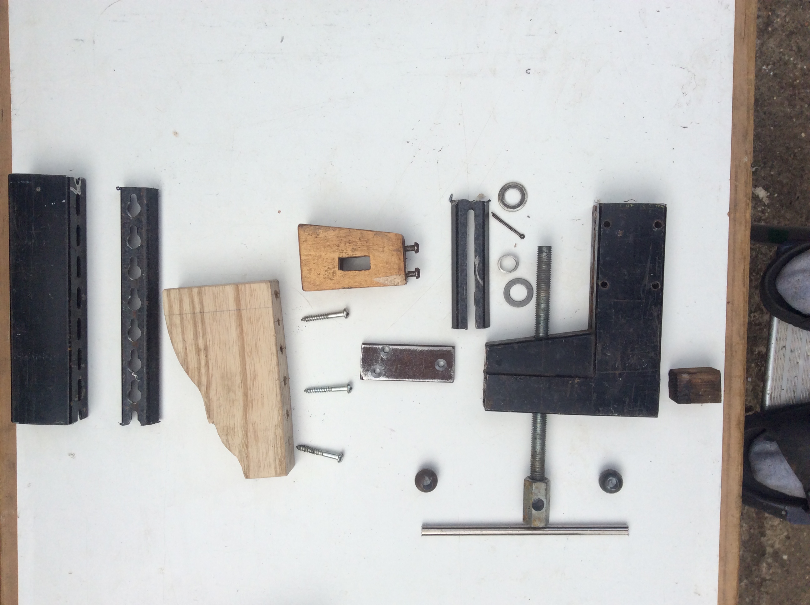

    I made 8 of these clamps about 30 years ago. They have had a fair bit of use, but now I intend to cut them down to make clamp heads, which can be attached to wooden bars. I had to struggle a bit to get them down from overhead racks.
    These were made from library upstands, originally T-shaped. I cut off one piece, to make them L-shaped. The box section steel is too thin to sustain repeated use of threaded studding. Not having any welding equipment then, I inserted greased dowels through the holes drilled for 3/8” BSW studding, then poured in molten lead. This has actually stood up well, far better than the tommy bars. But have you ever attempted to tap lead? It’s not easy! I learned subsequently that I should have used tallow as a cutting agent.
    The clamps’ feet were made from the brackets for the library shelves, which each had 3 prongs to insert into the slotted uprights, inserted into a saw cut in maple, then a pair of screws through holes in the steel.
    Hope to post the clamp heads in due course

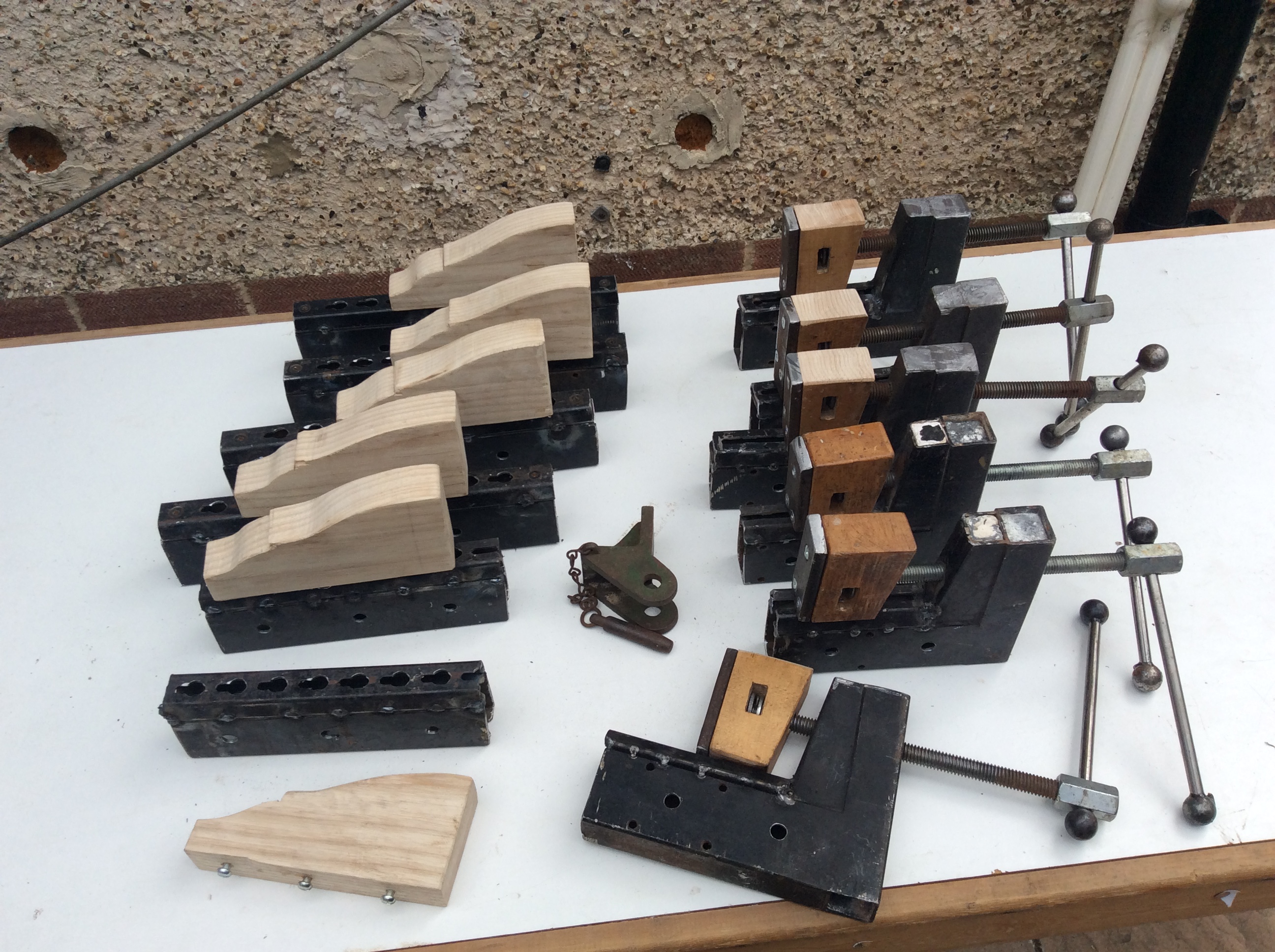

    Here are the components for the clamp heads

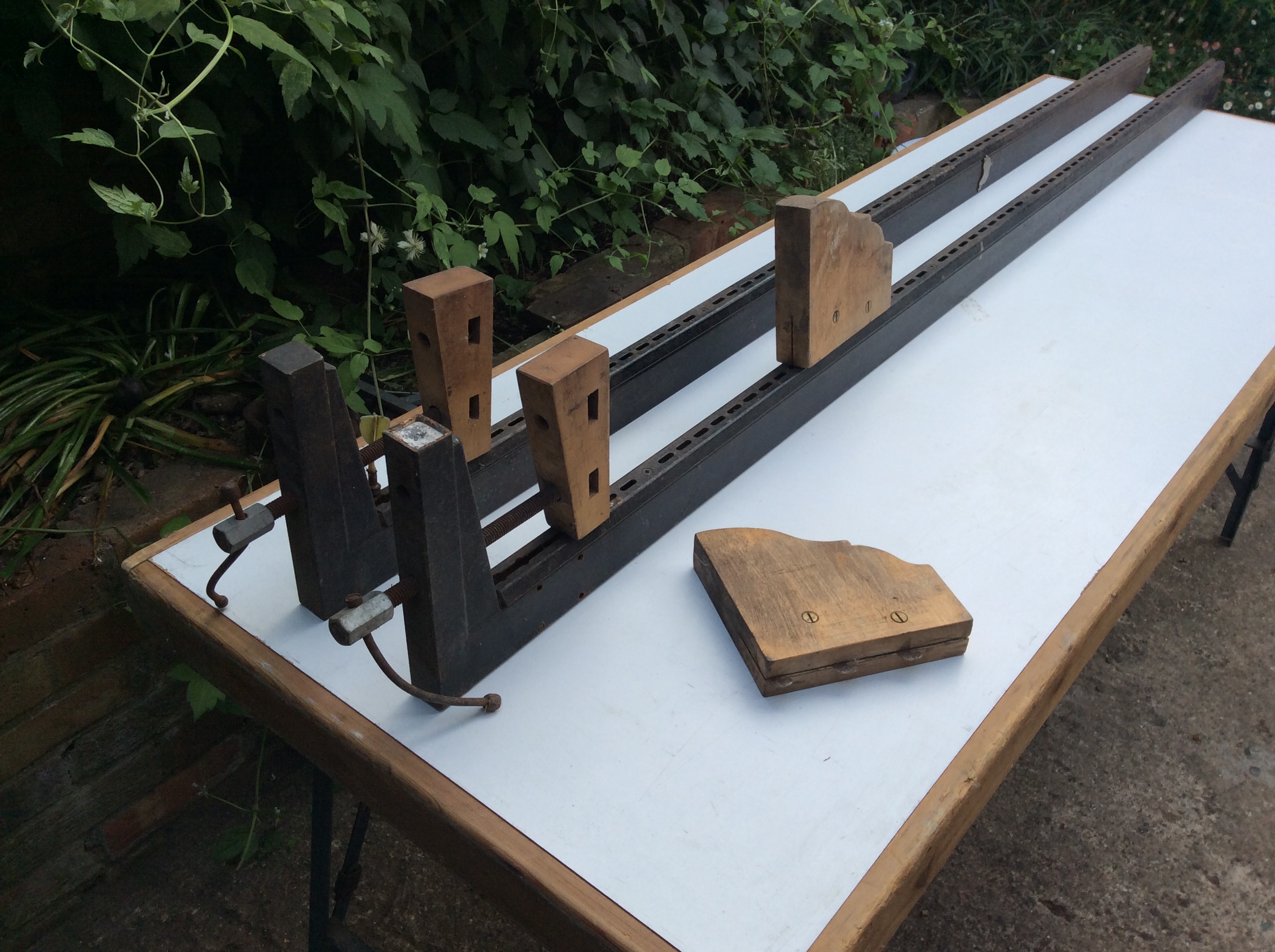

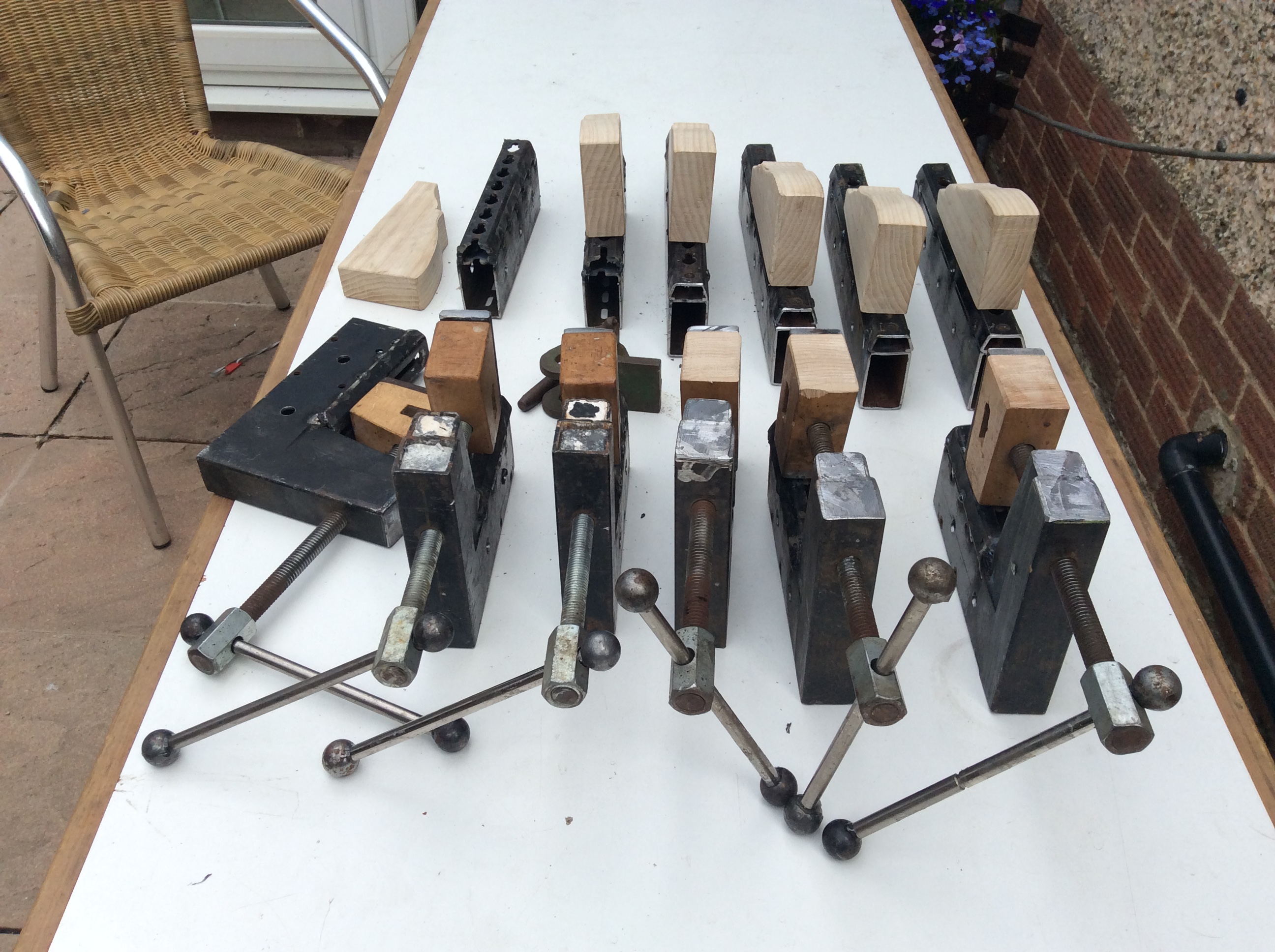

    Here are the completed clamp heads, 3 pairs, 3 + 1/2 days’ work. I hope that this hasn’t been an exercise in futility: TFSR sent an appeal for clamp sets, but these are hardly as compact as those commercially available.
