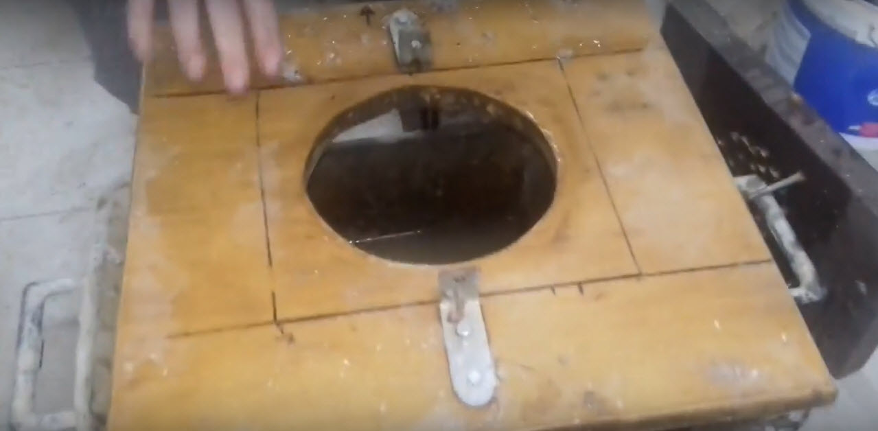

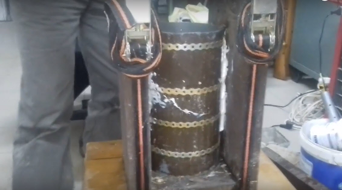

    A simple tool for making logs for the winter.

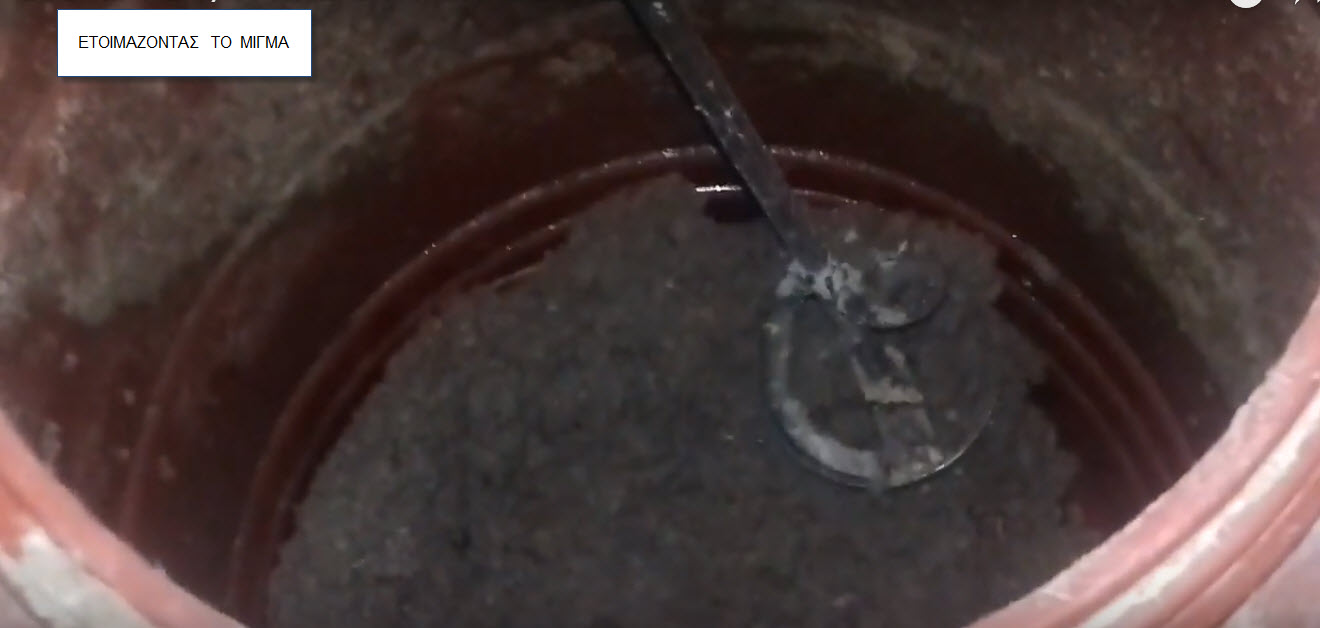

    The mixture contains 60 % sawdust and 40 % soft parer (newspapers ,old books etc) and water. As much paper as we add the mixture becomes more compact but it does not burn well.
    It takes about 6-7 minutes to make each log.
    The log must dry very well .
    You can see the tool here.
