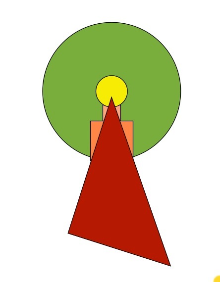

    Another idea for a centering tool on every angle value.(it's a bad picture but I'm really not a graphist…)

    Have you tried this out? I'm not sure how it works.
    Rick

    In order for it to work the angle to be measured must contact the edges of BOTH slots. A sufficiently obtuse angle will not do that, so I can't see it working on "every angle value". Also, very acute angles will penetrate too far and not contact both slot edges.
    Regards, Marv

    Sorry for my too shorter explanation, it goes on all angles but you need to have multiple widhts, it's not a single universal tool, but each time you need one and make it you can use it on different angles, and often i open more until it's no more usable.
    It is not an universal tool as described on the original post, just another way in the same manner to simplify the job.
    I try to make a short video for a better explanation.
