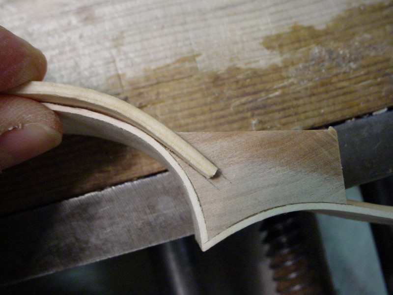

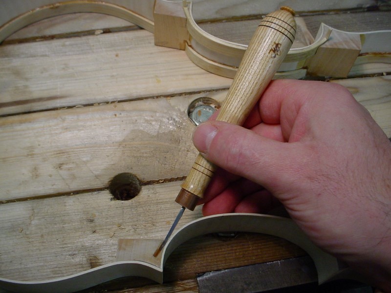

    In violin making, when fixing the C linings, you need to mortise them in the corners.

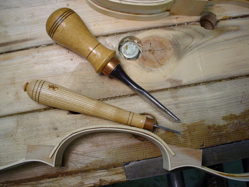

    For that, you need a narrow bedan chisel. Additionaly, as you are working mostly from inside the rib crown, you need a little, not too long bedan, hence this little homemade bedan made from a Stanley plane blade.
    Cheers !
    Christophe

    Interesting tool. Care to post a pic of the original Stanley blade?

    Hi, I'm sorry, I have no more pic of it, but it's a simple replacement blade for stanley #4 purchased at the local hardware store.
    I did several tools with it.
