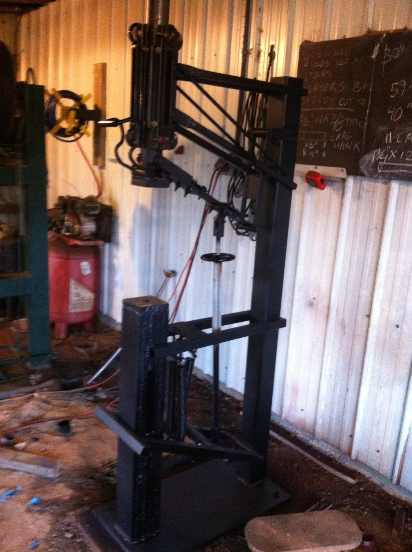

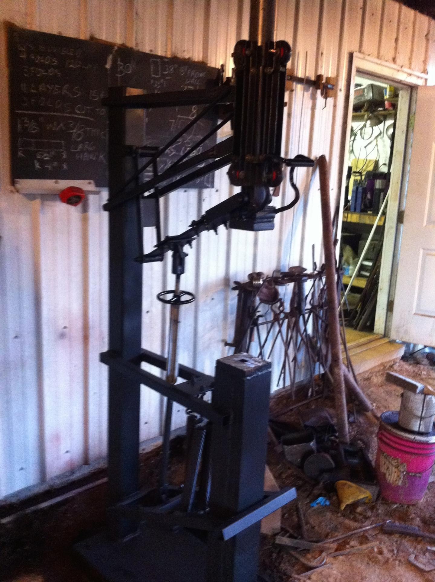

    Just finished this up, plans are from ABANA, Clay Spencer design. Surprised at how well it works, and how hard it can hit. Heads about 80 pounds. I installed bronze bushing in the arms, and changed the plans a bit, instead of using pipe for the link pivots I bored out 1018 cold rolled to size and added oil holes. Also upped the base plate from 1/2" to 1", both for the added stability and it's what I had on hand. Mounted to a 8" concrete slab, so no wiggling or bouncing around. Pics are just after finish rattle caning it, my smithy is not normally that cluttered.

    Thanks, I wasn't sure how much I'd use it, what with a power hammer and a hydraulic press, but I find myself using it all the time.

    Comes out to about 270 pounds, it's basically 5"x1" flat bar and 1" square stock stacked up and welded with the center 1" hardy left open in the side to be able to get a punch out if need bee. Not counting the 1" base plate or concrete foundation which helps. It'd be nice to have a 600 pound anvil, but there is no way I can get the most out of the 80 pound head only accelerating it with my worn out knees. It feels like it hits like a striker with a 8-10 pound sledge, which is just about rite for most jobs.
    The only issue I have with the "rusty" hammer is I had build one years ago and it hit soft compared to a Dupont linkage like the Little Giant. It's slower and more easy to control though, so it's easier to use tooling. If I was to build another rusty, I'd probably go for a 100-150 pound head and make use of the mass. The Dupont linkage gets it's power from velocity. I've got a tire hammer with the dupont linkage and it's great at turning big stock into small stock, but it's a little hard to do fine work on it. Nothing wrong with either hammer style, just have different strengths. For knife making I prefer the little giant style, as I do more blacksmithing I find it'd be nice to have the rocking beam.

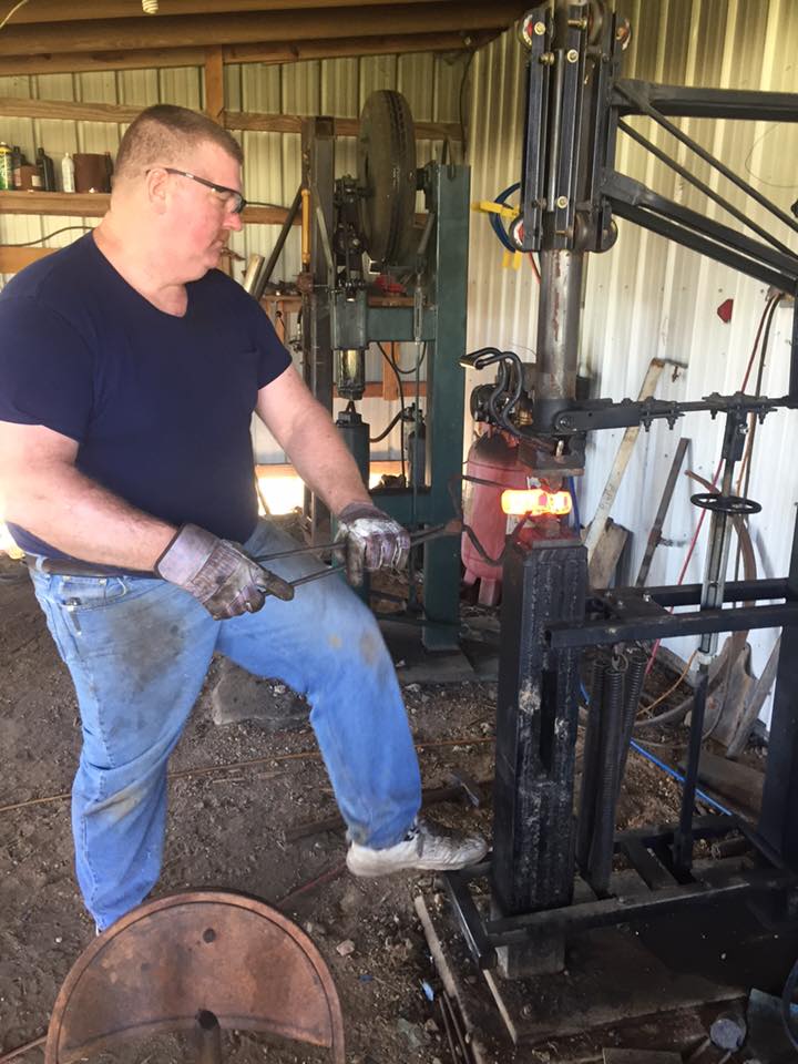

    Edited: I forgot I had a video, a couple friends drove down to do some hammer and tong forging. I'm off to the side holding the hammer being forged. https://www.facebook.com/bruce.evans...6856983040726/ A better pick of the side where made the hardy exit.
    I did a bunch of research years ago, can't remember but it seems like something like 60% of the base weight could be added to the anvil weight for the 7 or 8 to 1 hammer to anvil ratio. Might be 40%, can't remember off hand. On my 50 pound tire hammer the anvil is a 6" round bar, weights about 300 pounds, 1" baseplate welded to the 1/2" original baseplate, (I bought it used, didn't build it or I would have went with 1" plate to start with). And it's bolted to a 2' thick slab. At full throttle it'll really move some metal, except for 52100, that stuff is stiff.
