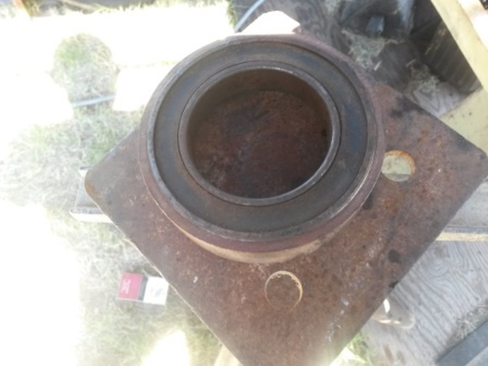

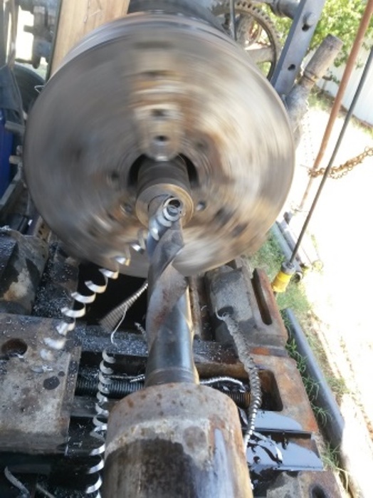

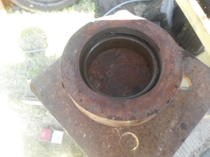

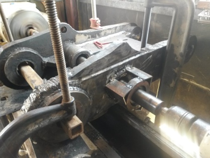

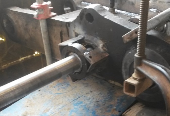

    the line bore bar worked great even with the Hodge-podge set up however seeing that I could only take a very small cut even using the steady rest to assist in stabilizing the boring bar I Decided what I needed was stabilizer bearings like those I always used on any of my old boring bar setups
    Enter a couple of bearings a pair of housings machined to fit and a pair of shaft adapters which are changeable for different diameter boring bars
    Tack weld these to the sides of thje part being line bored and instantly I can take deeper cuts without fear of the whole thing jumping around on the lathe
    Line boring bar stabilizers-20170629_123159aa.jpg Line boring bar stabilizers-20170629_161546aa.jpg Line boring bar stabilizers-20170629_161553aa.jpg Line boring bar stabilizers-20170630_110654aa.jpg Line boring bar stabilizers-20170630_113034aa.jpg
    It helped having the 100 year old lathe running so I didn't have to remove the set up from the other one to make these
