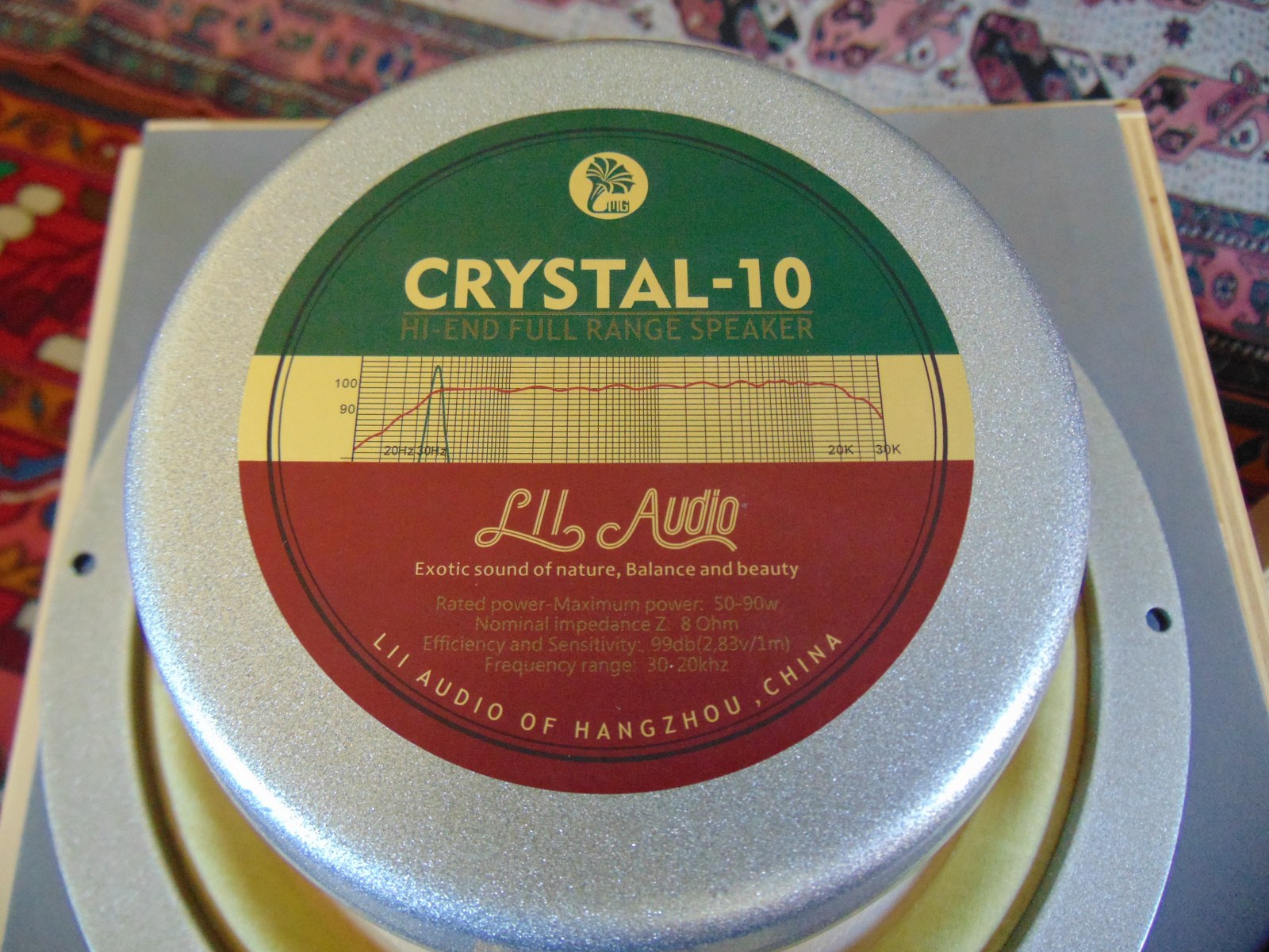

    Model is Crystal 10, a double cone, 10" fullrange with high sensitivity. I know someone in the forum could appreciate the development so I decided to post.

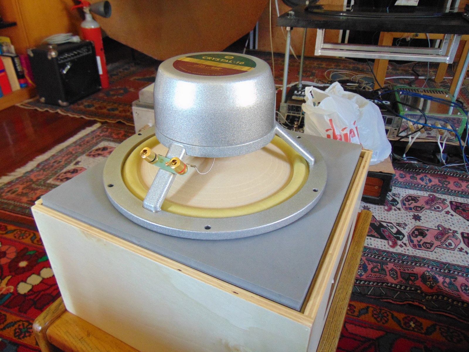

    - Driver unit:
    At first sight a really well made, heavy and well finished unit.
    Frame is sturdy, the round part with the fixing holes is 10mm thick, aluminum alloy, three-spoke type. A magnet shield is installed. The metallic gray paint is well applied.
    Chinese words on the frame should be "morning glory of Xizi" , a symbol of Hangzhou lake. Front gasket is a single piece type.
    Magnet is a ferrite Y35, an high grade according to Chinese standard list (Link at the end of the page).

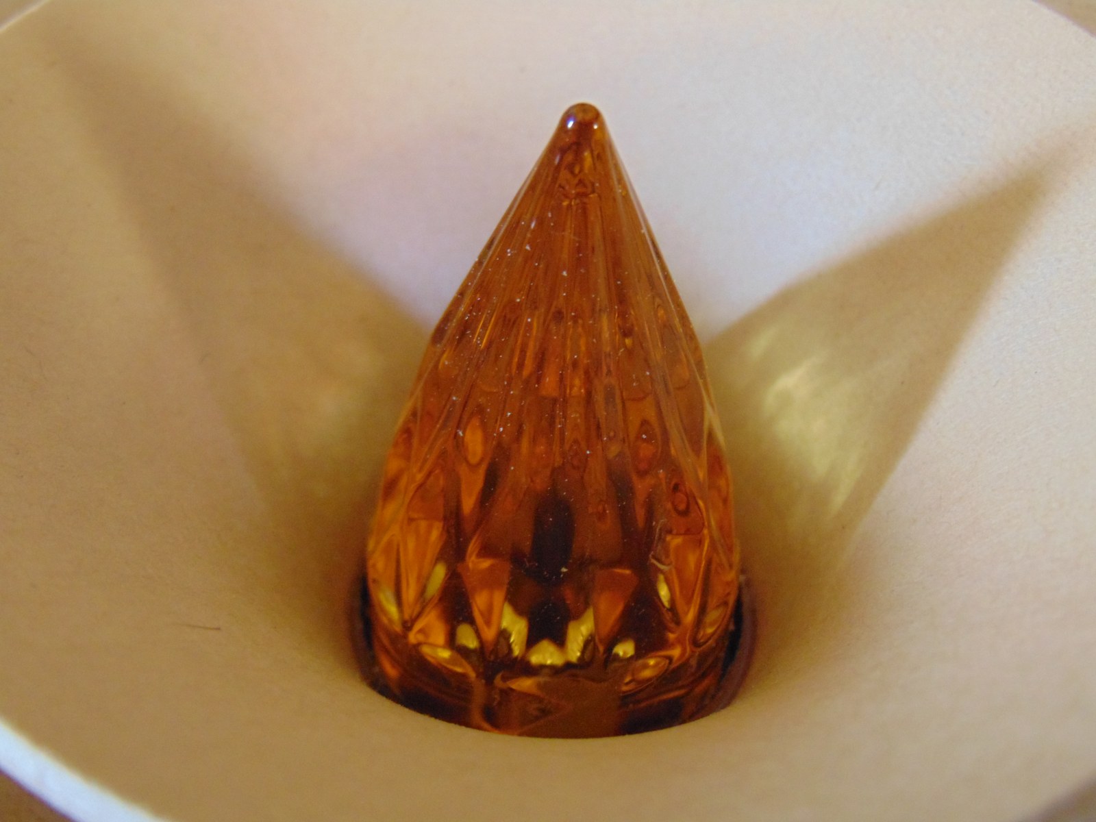

    Cone is a pulp mix of paper and straw, built according to factory specs. Whizzer cone is folded edge, voice coil 30mm. Surround is cloth impregnated type, as spider.
    The Phase plug is made from artifical crystal, with specific pattern.
    Flexible wires silver plated, solder is silver alloy type. Binding post are good quality, 5mm hole for cables, possible use of plug, Vetronite plate mounting with polarity simbols. No bad tool signs on screws.
    Observing the product is clear the attention to detail, under every aspect.
