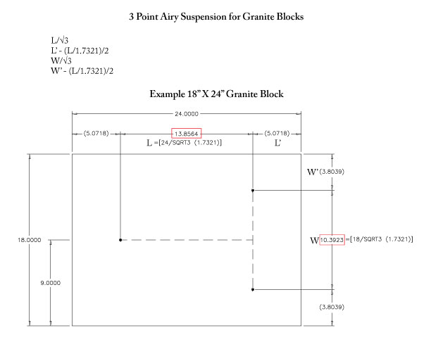

    For minimum deflection, the plate should be supported at the Airy points. These are two points spaced a distance apart that is the length of the plate divided by the square root of 3.
    1 / sqrt(3) = 0.5773
    1 - 0.5773 = 0.4226
    0.4226 / 2 = 0.2113
    so in from the edge by 21.13% of the length from the ends.
    Given that we're talking about microinches of deflection, this proves that Starrett's rule of thumb is right on the money. Nevertheless, if the manufacturer indicates the support points used for finishing, those are clearly the ones to use.

    Thank you Paul and Marv for the 3 point leveling info. I hadn't thought about it other than leveling the stand (4pt) when I got mine. Mine is a Grizzly "B" grade but the inspection map/sheet showed it to be closer to .5 tenths OA, plus a free shipping sale. I mainly got this size so I could do the metrology on my 14" bed work on my mini. I used a Craftsman 18x24 tool stand good for 300lbs and added 1/2 Ply to the top and shelf for rigidity and left every thing loose and kept it as square as possible with my meager tools upon tightening. Also added a tool drawer liner to the top for friction and dampening...probably not as good of idea now but does keep the Spar Varnished ply from contacting the granite directly. I replaced the cheesy screws with 1/4-20 BHCS (Button Head Cap Screws) and Nylock nuts. However the leveling feet are cheesy at best and have wanted to replace them with FootMaster adjustable casters but are rather pricey. I borrowed a 6" Starrett level to set it where it is now...but it's not on concrete...so who's nose now? This 3pt system might be much better and easier in the long run but would consider some angle or a hat section to the bottom of the ply for rigidity.
    Marv, I'm a bit confused about your numbers although I mostly understand Airy Points from my Drill Machine build and the catanary effects with 20' lengths of tubing and a 35' frame. Are these derived from a circle from the center of the granite? Also how is the 3rd point derived...on the same circle but at a quadrant (mid width)? I am also curious if it is better to use a small cylindrical contact or a cone point (which may damage the granite).
    Thanks again for the good ideas and learning in this thread! HMT at its best, imho. ~PJ
    Let me describe it another way. Imagine a stick whose length is the length of the surface plate divided by the square root of three. Lay this on the plate such that there is an equal gap between the end of the stick and the edge of the plate at each end of the stick. Mark lines across the short dimension of the plate at each end of this imaginary stick. These lines define the Airy lines for the plate. If you supported the plate with bars laid along these lines, it would have the minimum deflection at the midpoint.
    The arithmetic in my post shows that those lines would lie a distance from the edges that is 21% of the length of the plate.
    A three point Airy suspension would put two points on one of these lines, spaced equal distances from the long edge of the plate and a third point in the middle of the other line.
    I wouldn't use a conical point. An elephant foot to spread the load so the granite isn't damaged makes more sense.
    My feeling is that, for the typical Enco/Grizzly plate, worrying about suspension points is mostly nonsense. These small plates aren't that flat and, being short, they are stiff so bending isn't really an issue for any work done in the typical hobbyist venue. Leveling the plate isn't really an issue either unless you intend to use a level to do some of your layout; I don't so for me the major concern is flatness and that's more a production concern than a support concern.
    Regards, Marv
    Thanks Marv and do agree that these smaller blocks for "Hobbyist" probably don't warrant 3 point system but I do like the idea of it. I made a drawing to hopefully help others should they decide to pursue this, but mainly to log it into my descriptive math dense noggin this morning. Hopefully I interpreted your description properly? I still don't get where the SQRT of 3 came from...probably because I didn't have my Wheaties today.

    That looks good to me. I've never seen a standard for how far in from the long edge the pair of holes are placed but your choice seems logical. The square root of three comes from the equation for the Airy distance. A fuller explanation is here...
    https://en.wikipedia.org/wiki/Airy_points
    Note that there is an equation for n equally spaced support points...
    c = (n^2 -1) ^ (-1/2)
    which, for n = 2, yields the sqrt(3) relation.
    A slight misunderstanding. I think worrying about suspension deflection for hobbyist plates is unwarranted. Three point support is another matter. If you want to use levels to do layout or just don't want stuff rolling off the plate, leveling is certainly justified.

    Thanks for checking my drawing Marv. The reason I did it that way was it just made sense. The Airy Points are for Uniform Beams in particular and originally for standards preservation, but the plane of a surface plate accounts for 2 axis so I just did it in both directions. Interestingly after doing a bit of rabbit holing I found the Fed specs for surface plates and all the manufacturers I found adhered to the spec.
    Here is a link to the GGG-P-463c Federal spec. Here it is interesting to note that the Airy points in my drawing fit into the federal standard, closer to the 1/5 distance values. The other nice thing about the standard is on Pg. 5 they give the spec for circular plate support as .7 the OD and 3 "equally spaced points" (assuming an equilateral triangle). Additionally 3.2.3 (pg.4) of the spec covers the Thickness and Stiffness to a 50lb/sqft, centered with a half flatness tolerance deflection. Even with my 14" bed and measuring tools I doubt I have even approached that value.
    Additionally I found the Physical Properties of Granite from the Precision Granite USA. From these one could see how much flexure would occur with a particular block and based on the Modulus of elasticity for both directions one could quickly asses that it would be a very small order of magnitude for the 3" slab of 18x24 dimensions. Definitely not worth digging out the Marks manual to run the numbers as you indicated, and especially on a B grade plate in my shop.
