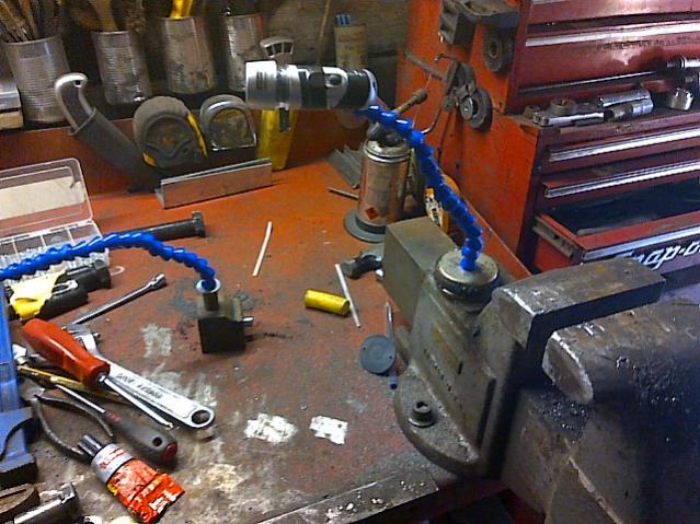

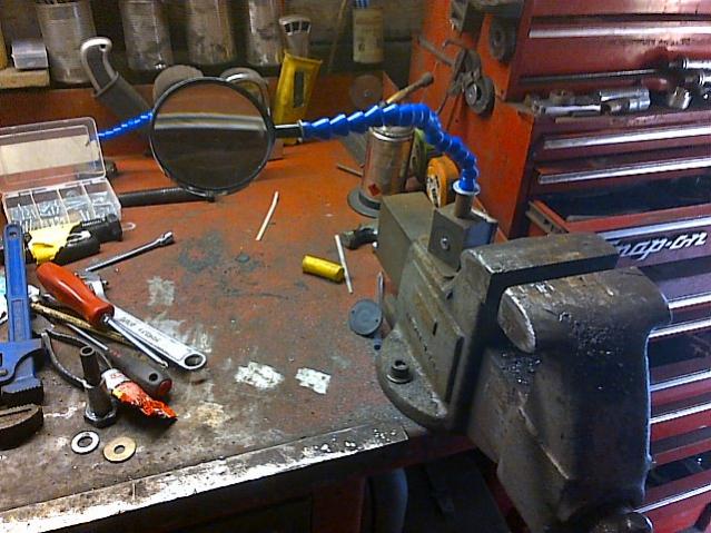

    got fed up trying to position light whilst welding under mates car so took magnet from old speaker fitted some lineloc to it and taped led torch to other end prob solved.
    whilst working on model car im doing was struggling to see some of details for painting, had seen flexilble magnifiers for sale in model shop for £14 but couldnt justify money.
    so bought magnifier for 50p then used some line loc and magnet to make one.
