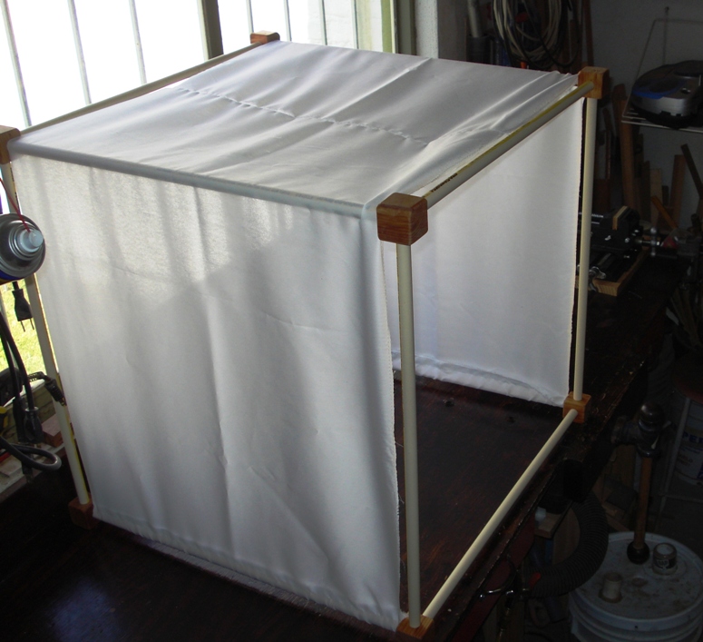

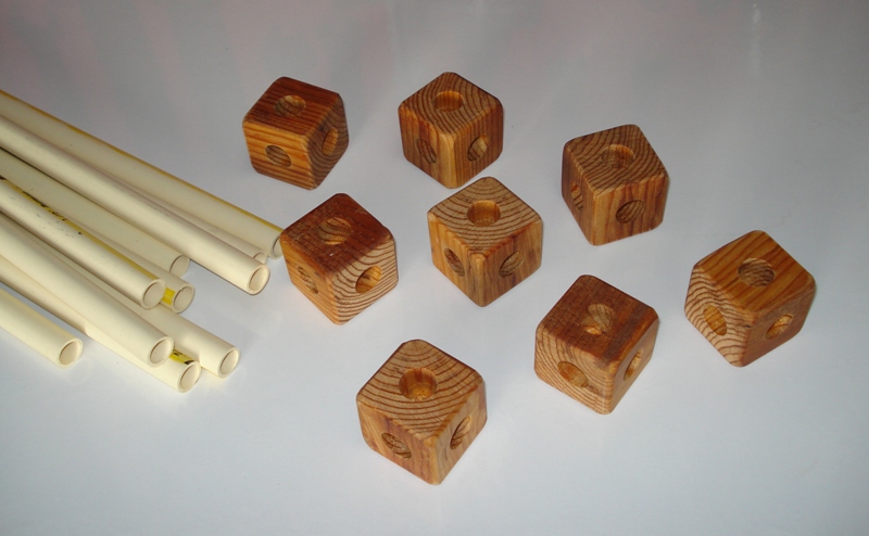

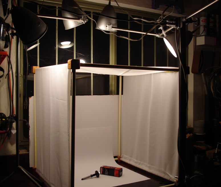

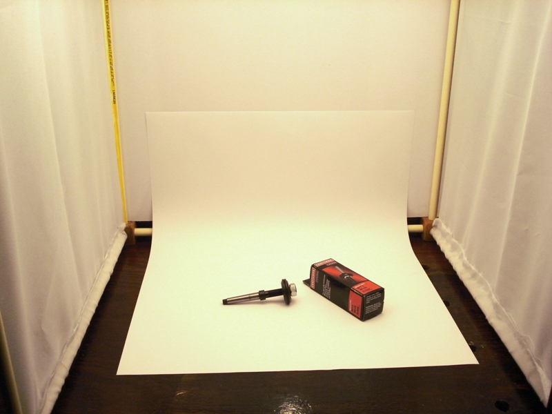

    This is a dual-function box, made in nov-2011. The cubic frame is made with 12 pieces of PVC pipe, 1/2” Ø, 60 cm long, and eight cubes of pine, 4 x 4 x 4 cm, with 5/8” holes on three sides.
    When used as a light box, the frame is covered with white cloth on three sides, through which illumination is provided. The ground side and the back are covered with a white or gray cardboard where the object to be photographed is placed. It is convenient to place the camera on a tripod and, of course, take the picture without flash.

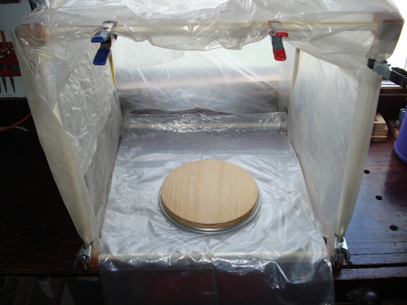

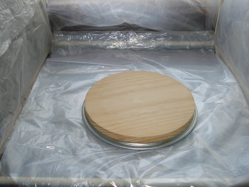

    When used as a spray booth, the frame is covered with plastic in order to limit overspray of paint. A turntable platform and an exhaust air could be useful.

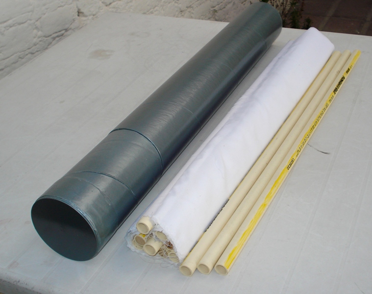

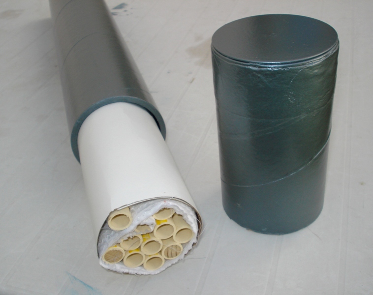

    I forgot to mention that if the white cloth and PVC pipes are stored in a cardboard tube for shipments, they will stay free of dust, and only takes a little storage place.
