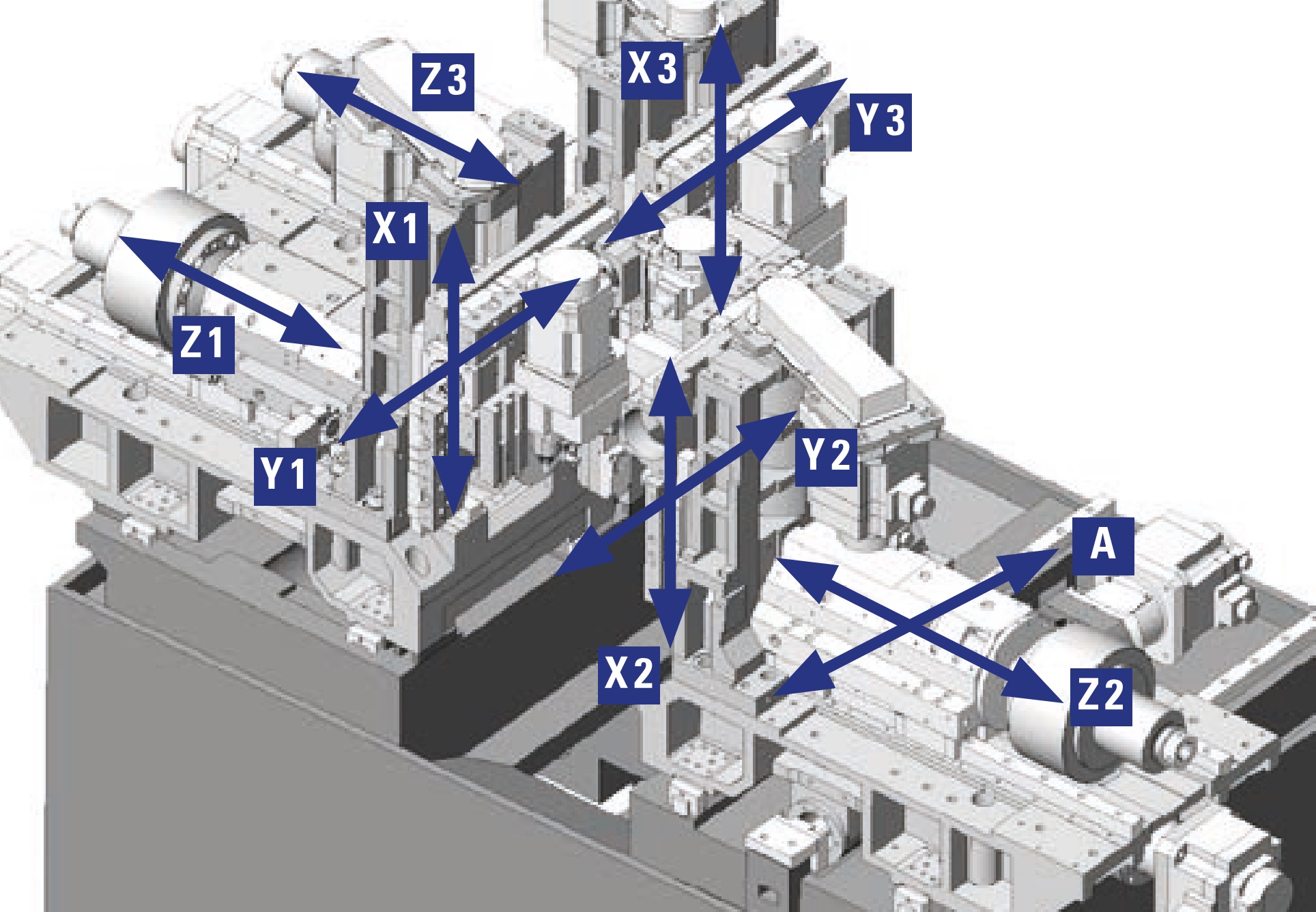

    Is this for breaking chips?
    Supporting Member machining 4 all's Avatar
    May 2020
    379
    68
    Thanked 618 Times in 167 Posts
    machining 4 all's Tools
    Exactly! It is an unconventional machining process used to break chips in ductile materials (low carbon steels, for example). It also shows good results in the machining of polymers, pure aluminum and some alloys used in the naval, aeronautical and aerospace industries. Depending on the specific model of the equipment, different types of vibration are obtained (see image).

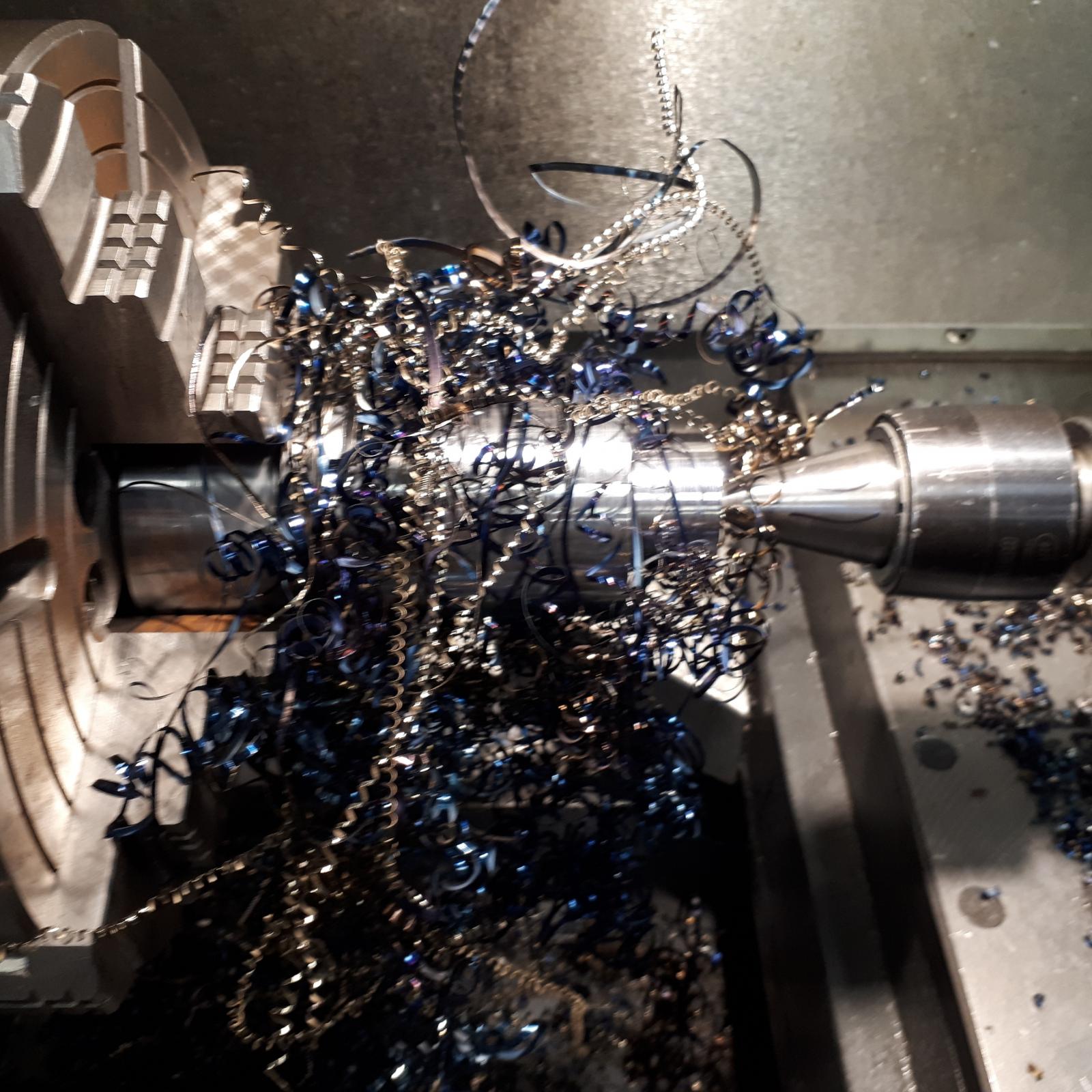

    That's it, there are materials that don't break chip easily, even if you change the machining parameters or use chip breaking tools. The fun is trying to control the shape of the chip, when possible, so as not to end up with a bird's nest on top of the machine!

    Yes, they are vibrations controlled by the machine! They are usually 1.5 times greater than the frequency of the part.
