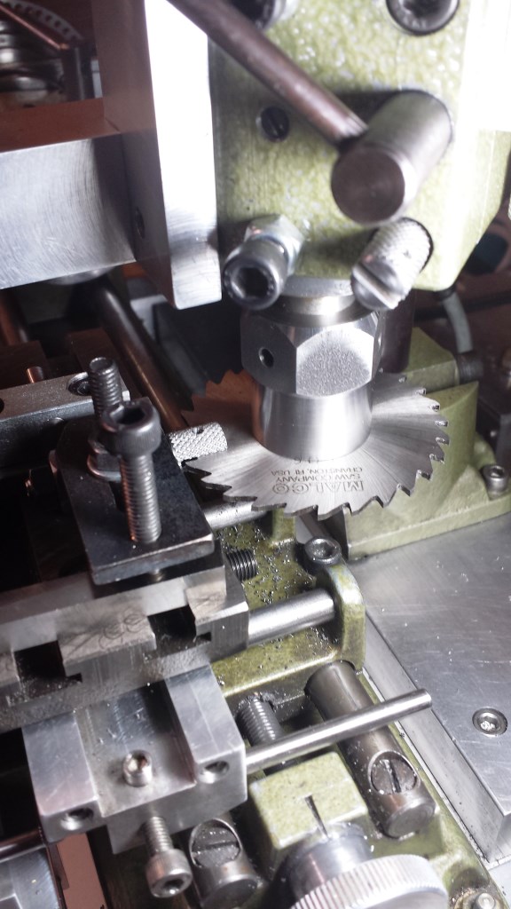

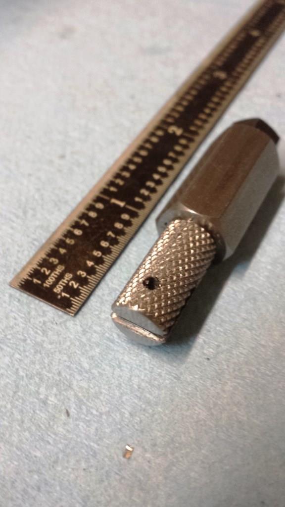

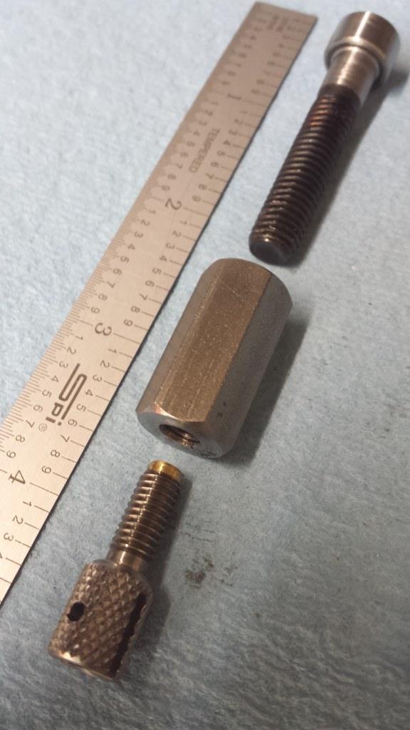

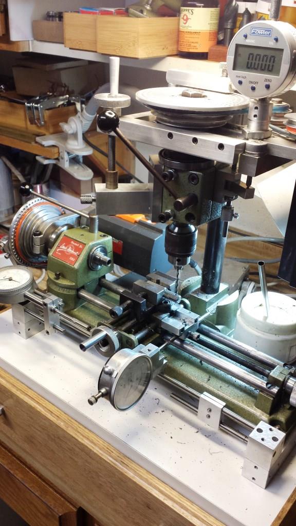

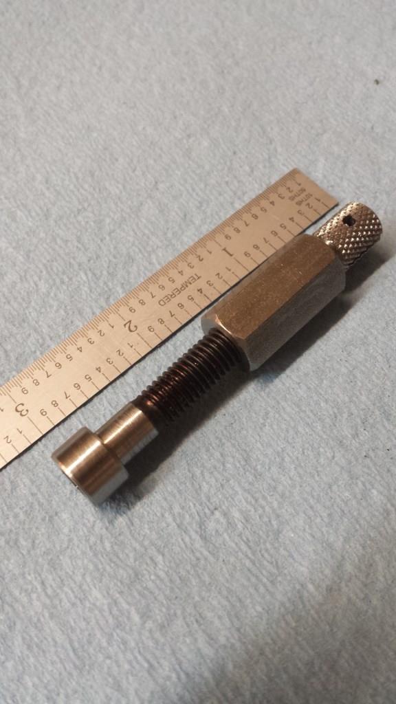

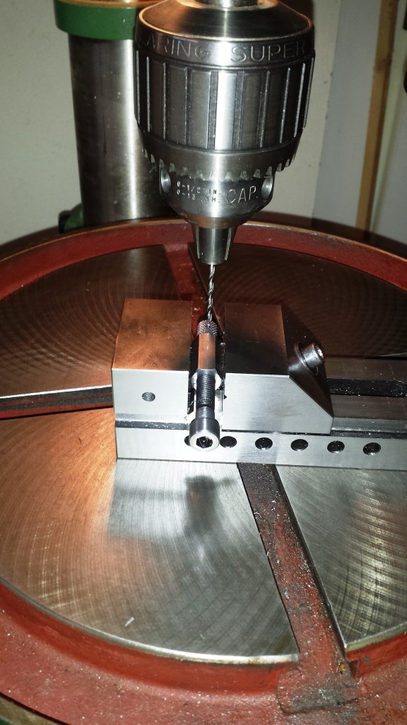

    These were easy to make and even easier to use. I made a fixture for holding the knurled screw head for the slot cutting work. There is a M8 cap screw for locking in place the shorter M6 clamping screws and a hex nut for locking in place the longer versions. Here are some photos.
    Regards, Paul

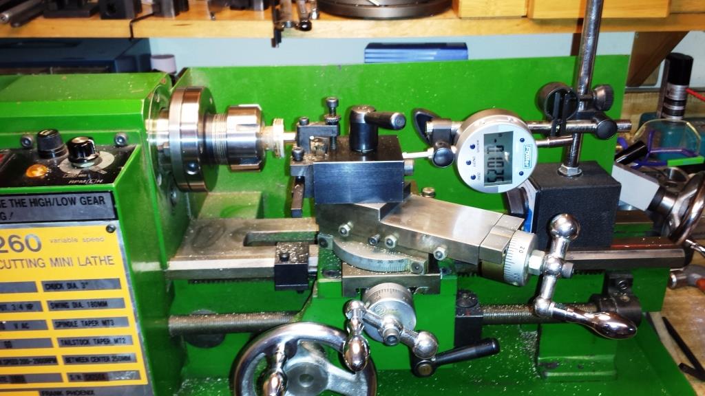

    I see you are using your lever screws on the sides of the dovetails of your slides. I suppose it is for pressing the wedges that serve to reduce the play in the dovetail ?
    This is something that I have a lot of difficulty to setup on my Chinese lathe.
    You seem to have one single screw for that where I have several little set screws (so tiny head that they will end up to be worn sooner or later), and they are locked using a slim nut.
    I feel my slides are whether too loose, and I have vibrations or even worse, I sometime see the tip of my cutting tool rolling under the piece .... Or I have them too tight, so with no play, but the cranks become difficult to turn ...
    Could you provide an advice on how to setup properly these screws ? Maybe I should replace them right now by scews with heads or knurled buttons like you.
    I don't see any locking nut on your screws ? no need for that ?
    Thanks in advance !

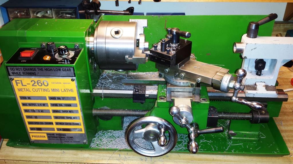

    The compound and cross slide on my 12" swing lathe use tapered gibs. The gib is wedge-shaped and adjusted by loosening or tightening an adjustment screw located on the end of the gib and not on the side. The lever action locking screws gently push on the side of the tapered gib and add some sliding resistance. It takes just a fraction of a turn to lock the tapered gibs. I keep the compound locked down in normal operation and the cross slide is almost never locked. The tapered gibs are very easy to adjust and are an excellent design feature but more expensive to manufacture.
    I think the gibs on your lathe are similar to what I have on my 7" swing mini lathe. I bought my mini lathe in 1993 and this one was made in Taiwan but looks just like the Chinese designs. The mini has three set screws along the edges of the compound and cross slide for adjusting a flat gib (not tapered) with a rhomboid cross section. I honed these gibs to be very smooth and flat, and enlarged the shallow dimples where the side adjusting set screws rest. It took a lot of work but the mini lathe compound and cross slide run very smoothly. There is a fourth screw used as the locking screws and I plan to replace these smaller diameter metric hex head cap screws with my lever action locking screw. It will probably be an M5 and not M6. I provided a photo for clarity and will post the changes at a later date.
    I hope this helps with your question.
    Thank you for asking, Paul

    Hi Christophe. Thought I might chime in here as well, as I think we have similar issues and peanut Sieg's. It has always been a constant vigil to keep the all the gibs adjusted properly for me. I personally started out with the LMS procedure. It's kind of an art and feel but you get faster after about 20 times.
    The "Roll Under" you speak of is likely caused by the Carriage retainer slides. You can also use the LMS procedure for that, but I added a bit of blue Locktite (242) to each of the screws prior to adjustment. It has helped tremendously on the frequency of adjustment. Also by sliding the carriage the full length of the ways while adjusting. My old bed is worn more toward the chuck so I adjust them so the are snug there and will barely pull off the end of the ways.
    There are lots of reasons for the constant vigil but primarily it's the Gib material (beer cans), IMHO. I will be making a custom set from Silicon Bronze for my new bed and extended cross slide. It's harder, provides good lubricity and won't tend to distort so easily from repeated adjustments...although I'm hoping to minimize that too with all my hand work to get them square, parallel and perpendicular with better tolerances over all. Again the material on a $500 lathe is not so good so it won't solve every thing. I have seen some YT DIY Turcite applications which might eliminate some of that...but it's still a $500 lathe with $5k in labor. ~¿@
    Hope this helps! ~PJ
