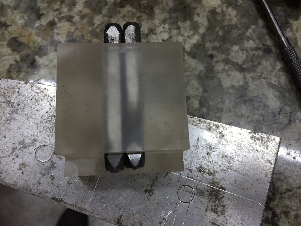

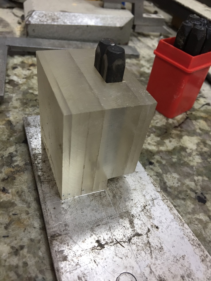

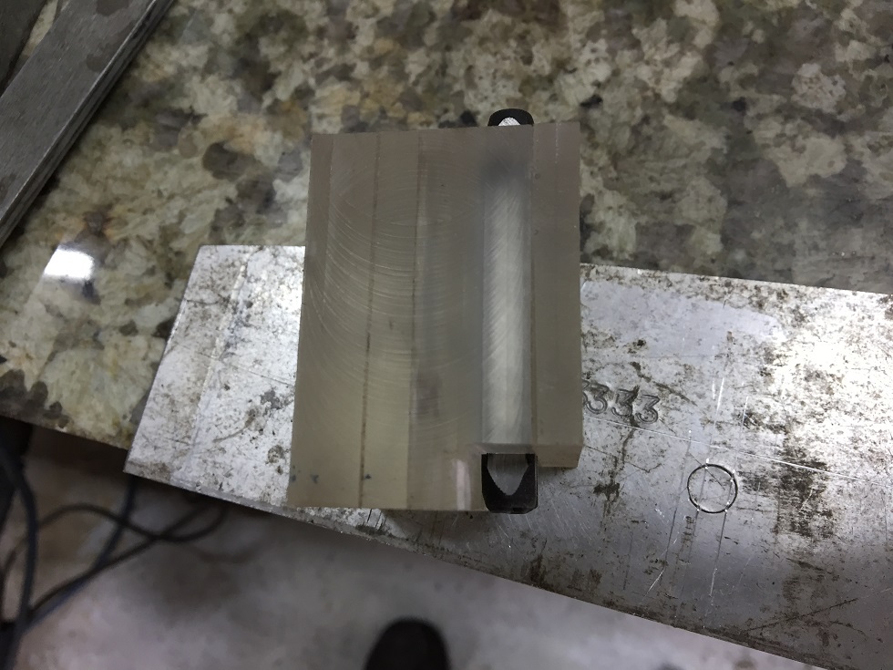

    I always wanted one, but the pain of creating a square hole through 40 plus mm stopped me from making one.

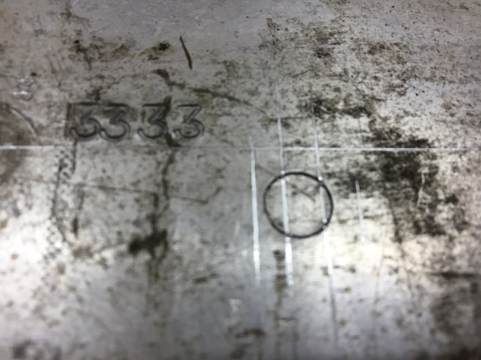

    The plastic block gave me an idea. I glued up enough number plates to make up 2/3 of the block, then machines the slots for the punches to fit. Then simply glued another 2 layers of number plate and a square hole with minimal effort. I also milled out a piece below the punches that I could use to line up to a scribed line if I have to do more than 2 characters. I made it to do 2 letters at a time as I mostly stamp 2 letters at a time. Lots of bits making up the suspension bits of a race car. I scribe a line on the side of the holder 0.5mm less than the punches, this gives me a nice reference it I need more than 2 letters and the letters are nice and close.
    Letter/Number Punch Holder-holder-side.jpgLetter/Number Punch Holder-2-time.jpgLetter/Number Punch Holder-cut-out.jpgLetter/Number Punch Holder-stamping.jpg

    Well done. "Assembling" square holes as you've done here is often more practical than trying to excavate them.
    Another dodge for creating square holes is to mill a slot of the square size in a piece of cylindrical stock then secure the cylinder in a hole drilled to accept it. I used that procedure to make a holder so my boring head could accept a square lathe tool...
    http://www.homemadetools.net/forum/e...ing-head-27452
    Regards, Marv
