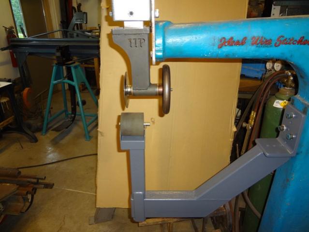

    16
    Thanked 3 Times in 2 Posts
    I quoted you here just for reference...as the link you show requires a sign-in. Is there a way for you to link to or attach a picture of what you are referring to? Thanks.
    Quote Originally Posted by nonhog View Post
    here is what I am leaning toward......All MetalShaping
    something like that. For now its sitting and waiting just like most of my many projects. LOL

    nonhog's Tools
    Its a tipping wheel. Hope this helps. My RAS parts are sitting waiting for me to work it out.

    Thanks for the picture. I suppose I'll have to GOOGLE tipping wheel as I'm not familiar with that terminology. In the picture of the tipping wheel you shared the key it appears would be the rigidity (or lack of flex) both where that arm is bolted to the vertical RAS piece and the connection between the horizontal head piece and the vertical stand of the RAS. Jeezzzz...I hope I'm making myself clear here. I haven't studied the RAS enough to know...is the connection between the horizontal head piece and the vertical stand really flex free?

    Quote Originally Posted by daveward View Post
    I suspect it would be, but really can't say for sure. I think (but could be wrong?) that the style of tipping wheel set up I would make would involve a go kart racing slick.(or skate board wheel) That would mean the flex would not be a huge deal.
