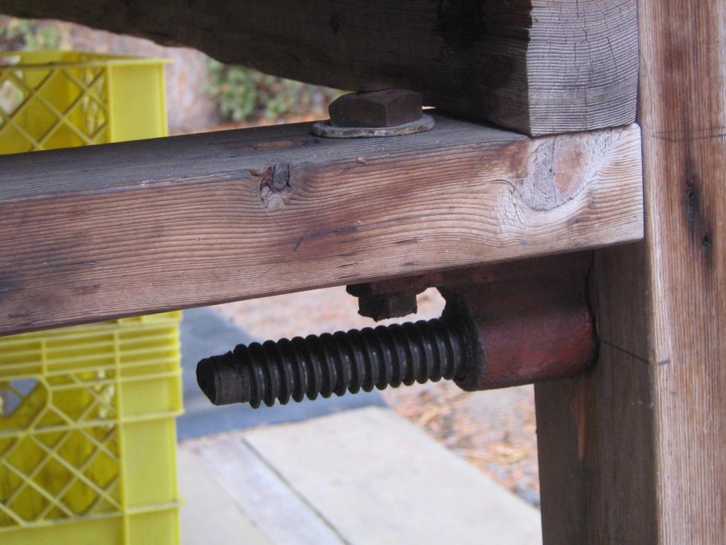

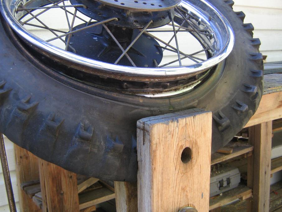

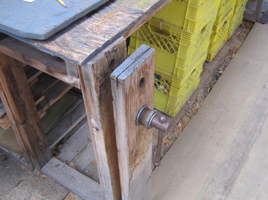

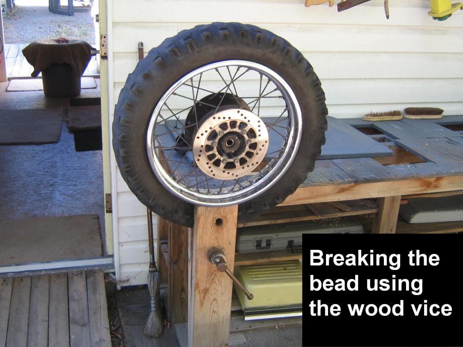

    This is a variation on a woodworkers leg vise, using the left over parts from my old broken bench vise I adapted it for my outdoor bench, using the screw and nut along with a 2" x 6" board, along with the usual clamping jobs this vise makes quick work of tough to break beads on motorcycle tires !
