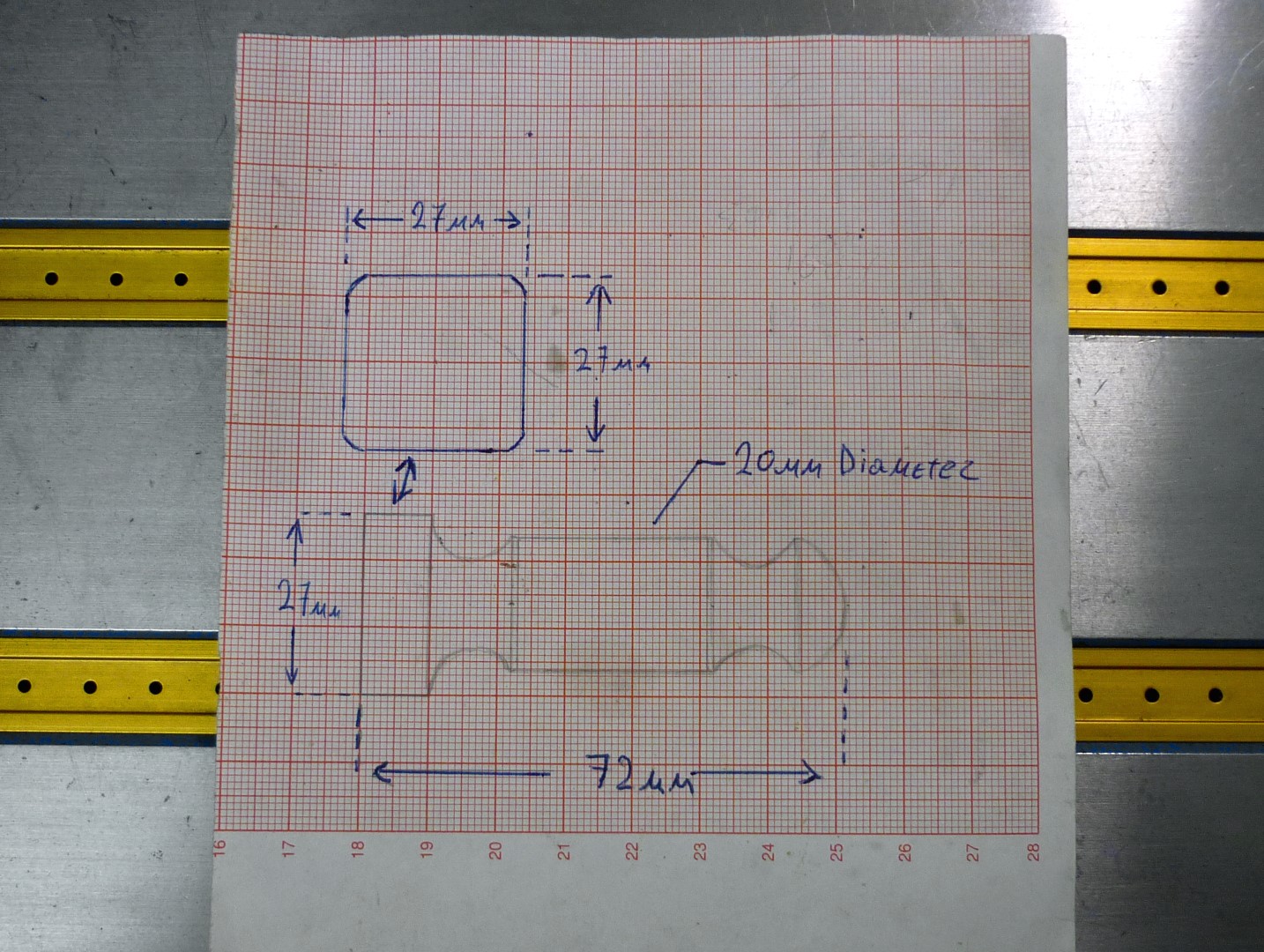

    A while back my friend Nick asked me if I would make him a specialized leatherworking hammer: a square headed hammer to flatten the stitching on knife sheaths. He gave me some rough dimensions and weight of what he had in mind.
    The head should be between 70 and 80mm, one end a square measuring 25mm x 25mm and the other end rounded. He also asked for a weight of between 160g and 170g. Based on these parameters I made a simple drawing of what it might look like.

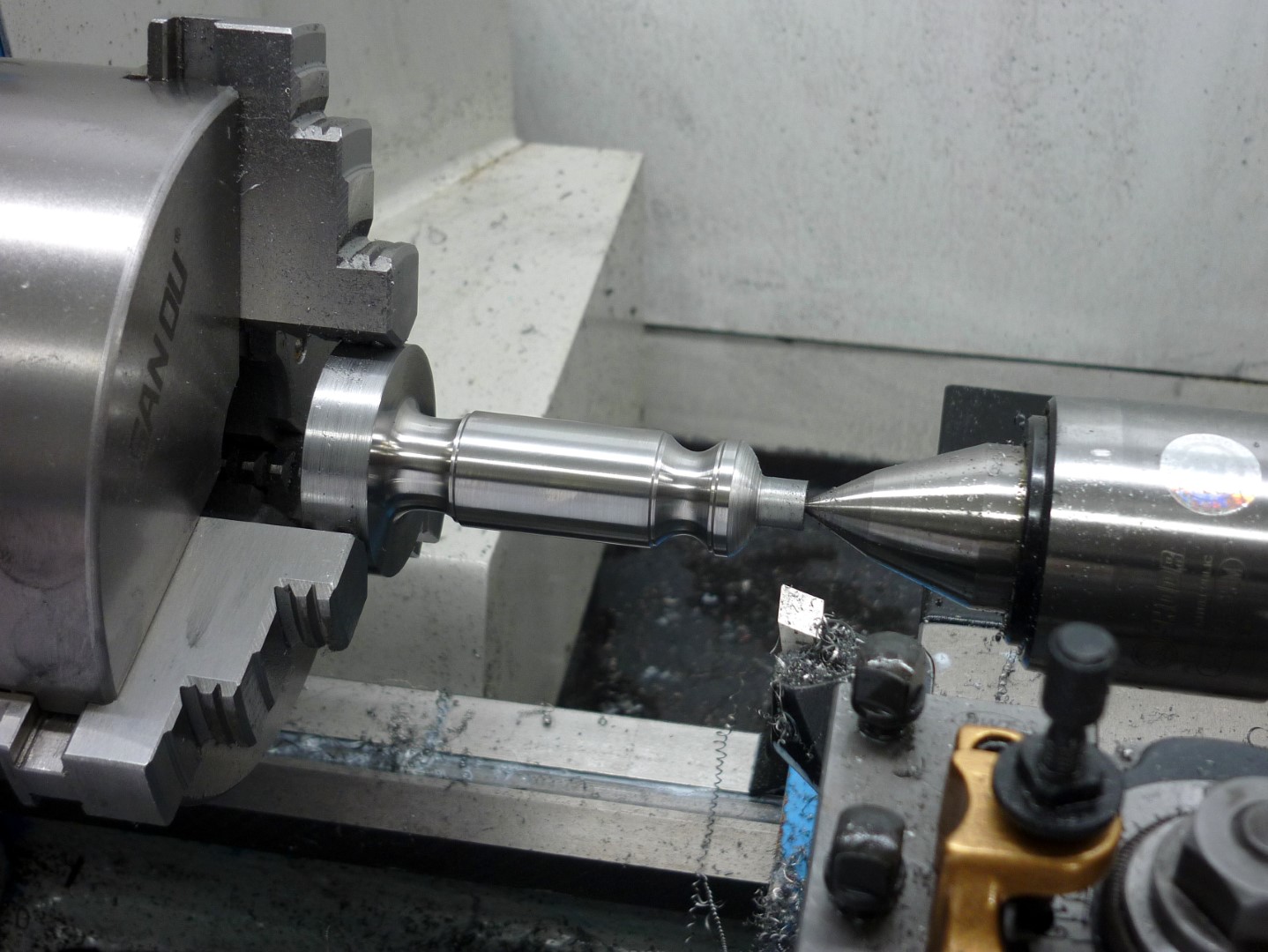

    I used a 35mm round bar of Arne® steel (a manganese-chromium-tungsten alloy, similar to 01 tool steel).
    When I had finished the lathe work the hammer head came to 192g which made me confident that the finished product would be in the 160g+ range.

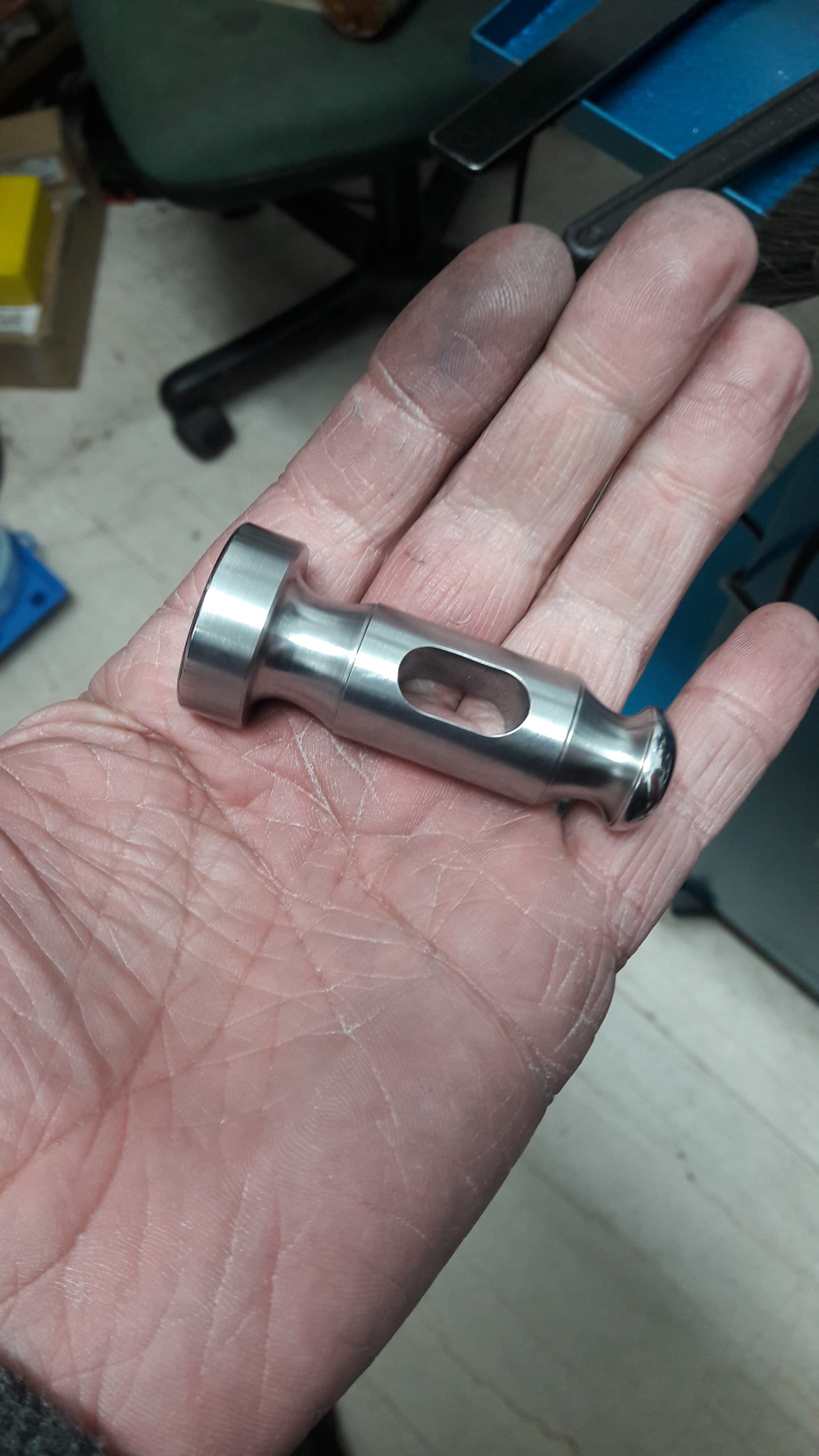

    It was careless, but thankfully not a total loss as I re-machined the square into a round head and made Nick a small ball-peen hammer (145g in weight).

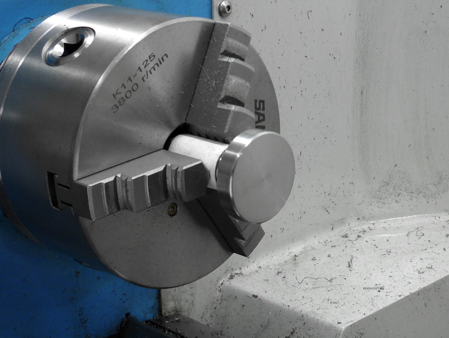

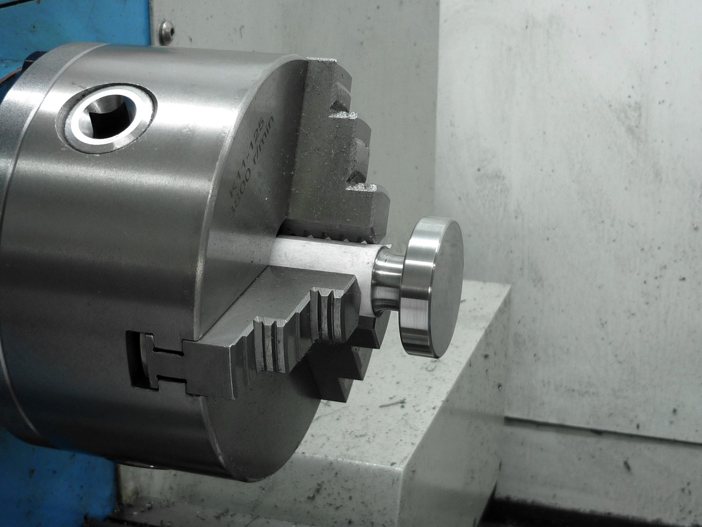

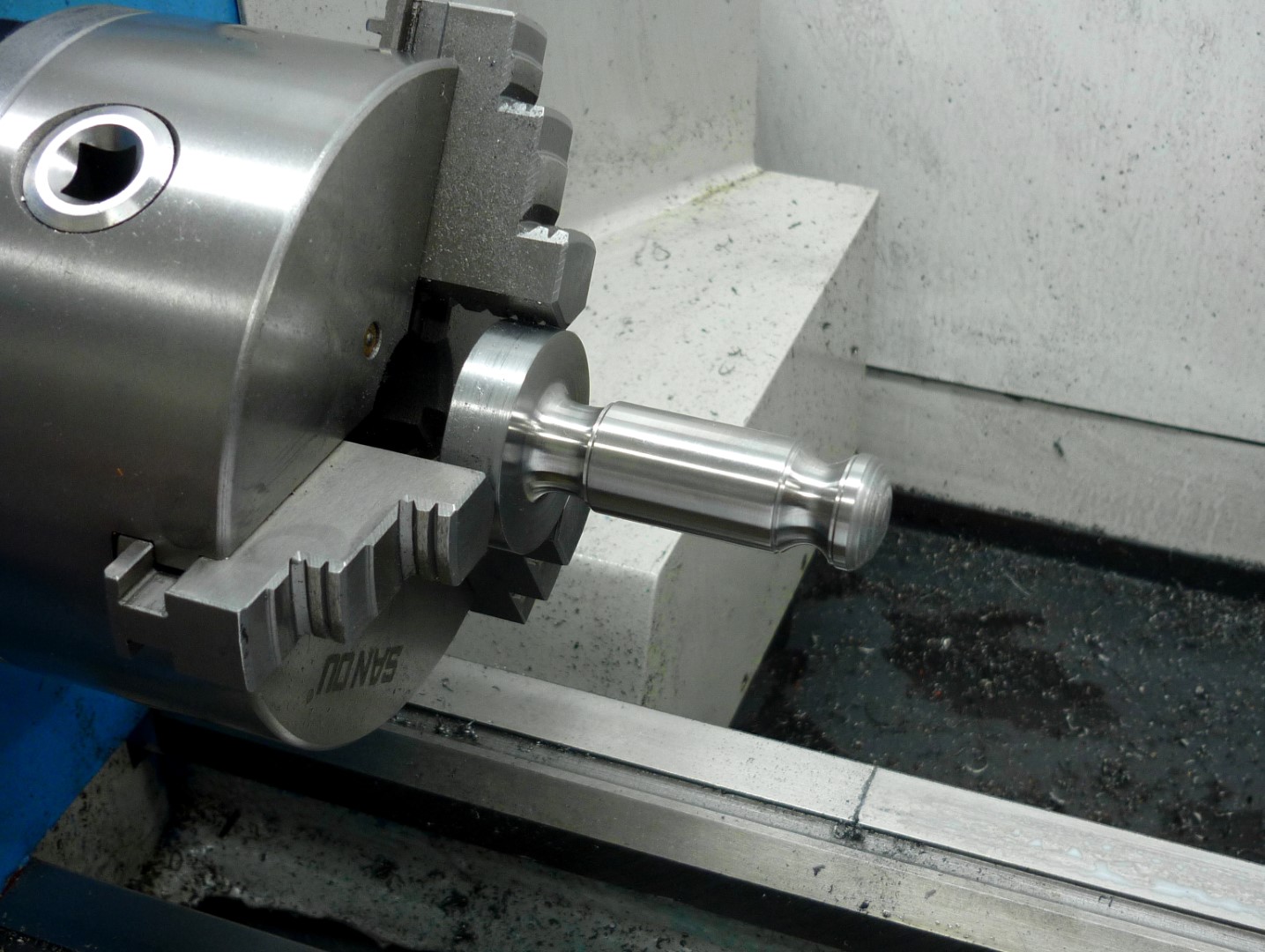

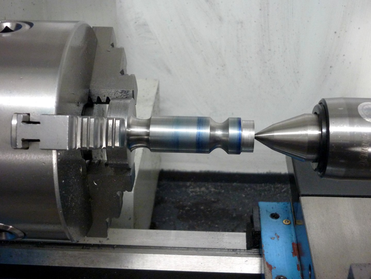

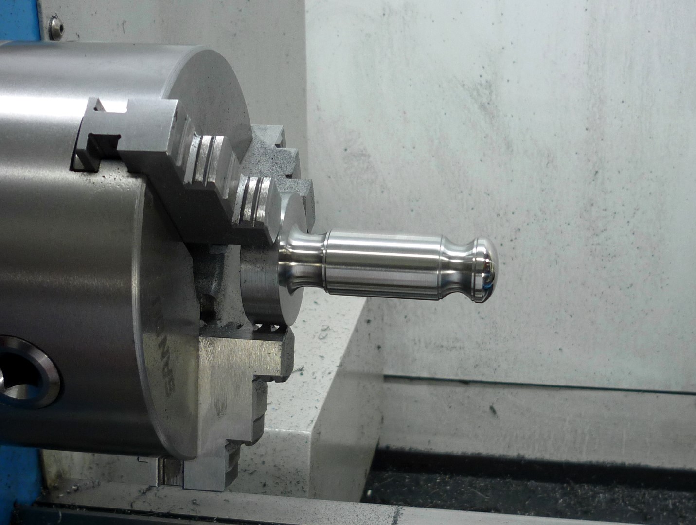

    Learning from my mistake I started again. I used the same type of steel only bigger in diameter (40mm) and made some changes to the overall dimensions of the hammer.
    Leatherworking hammer-p1160853.jpg Leatherworking hammer-p1160855.jpg Leatherworking hammer-p1160857.jpg

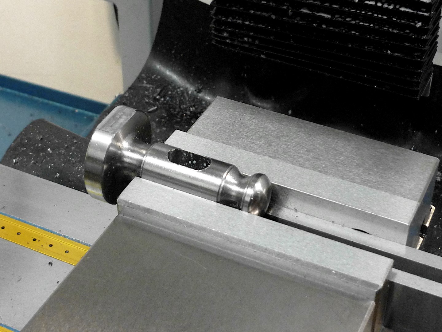

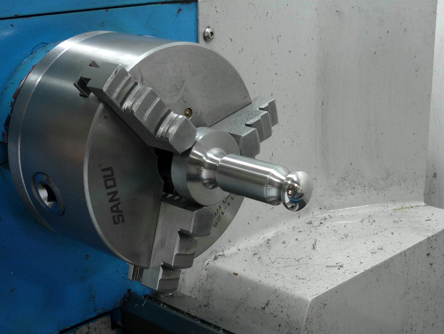

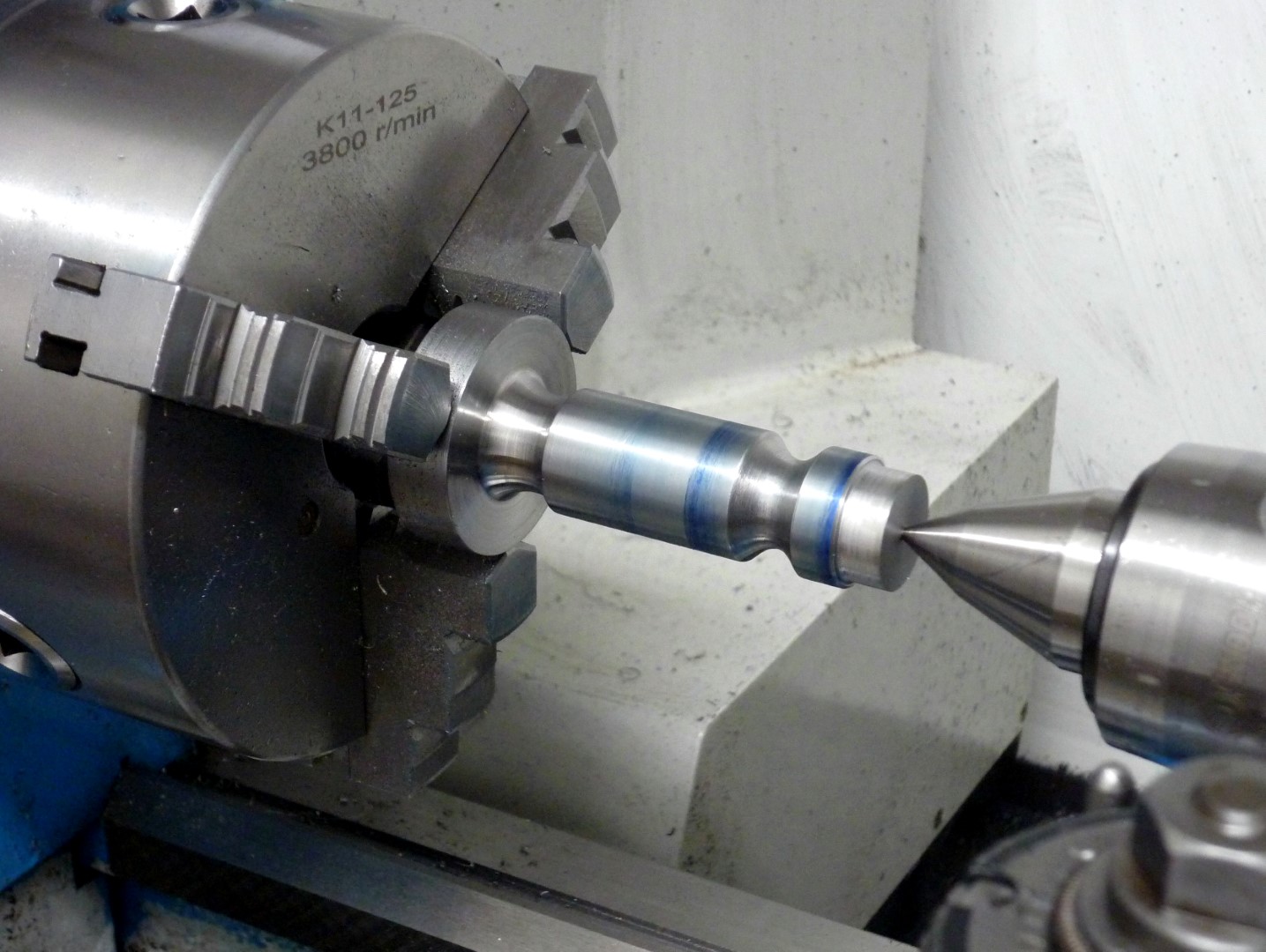

    Making the half round grooves I used a grooving tool and a round file.
    Leatherworking hammer-p1160861.jpg Leatherworking hammer-p1160863.jpg Leatherworking hammer-p1160865.jpg
    The arc head shaped with a file and finished with 2000G sandpaper.

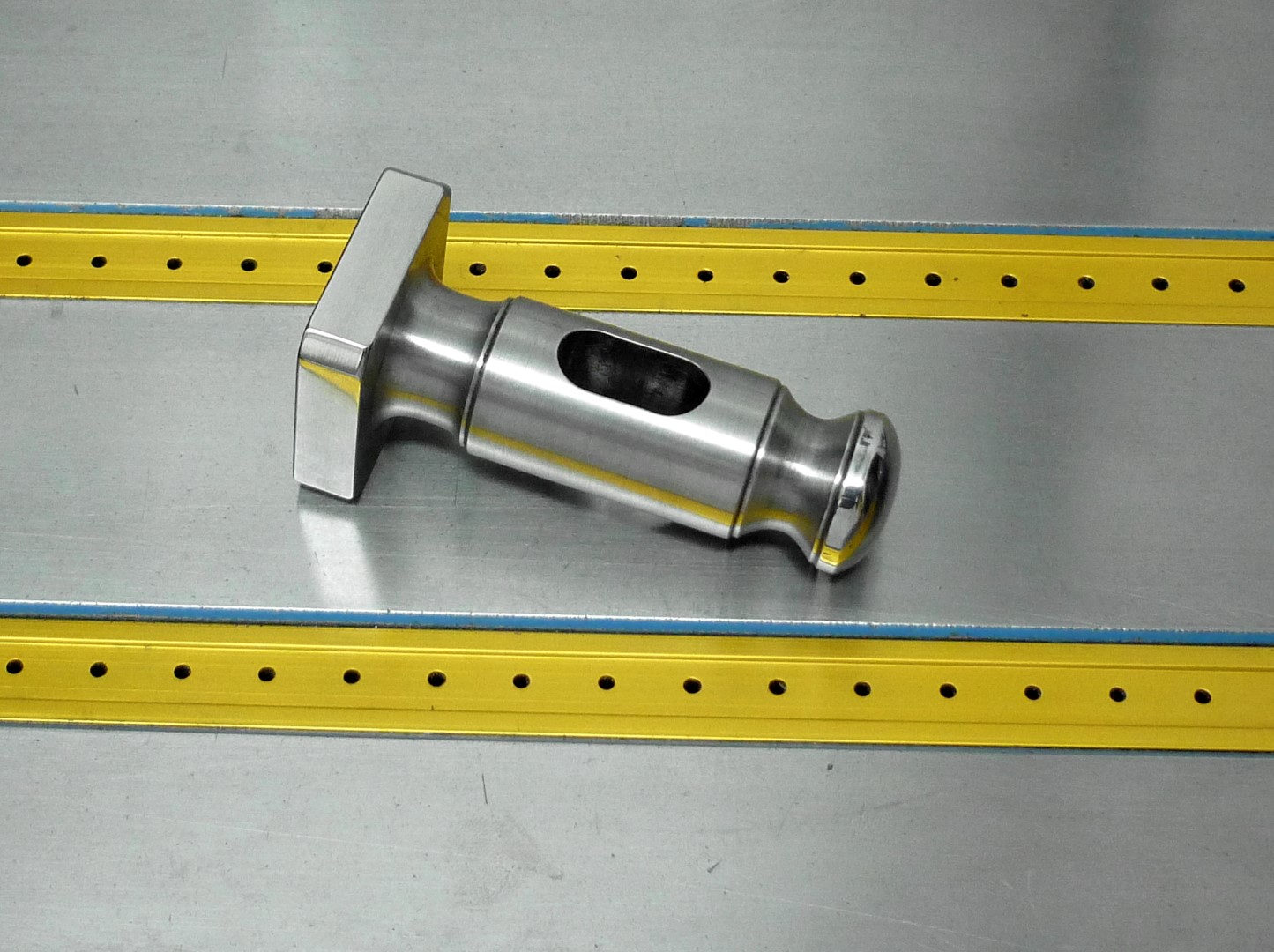

    The thickness of the bigger head reduced from 11mm to 7mm, was finished with 600G sandpaper.

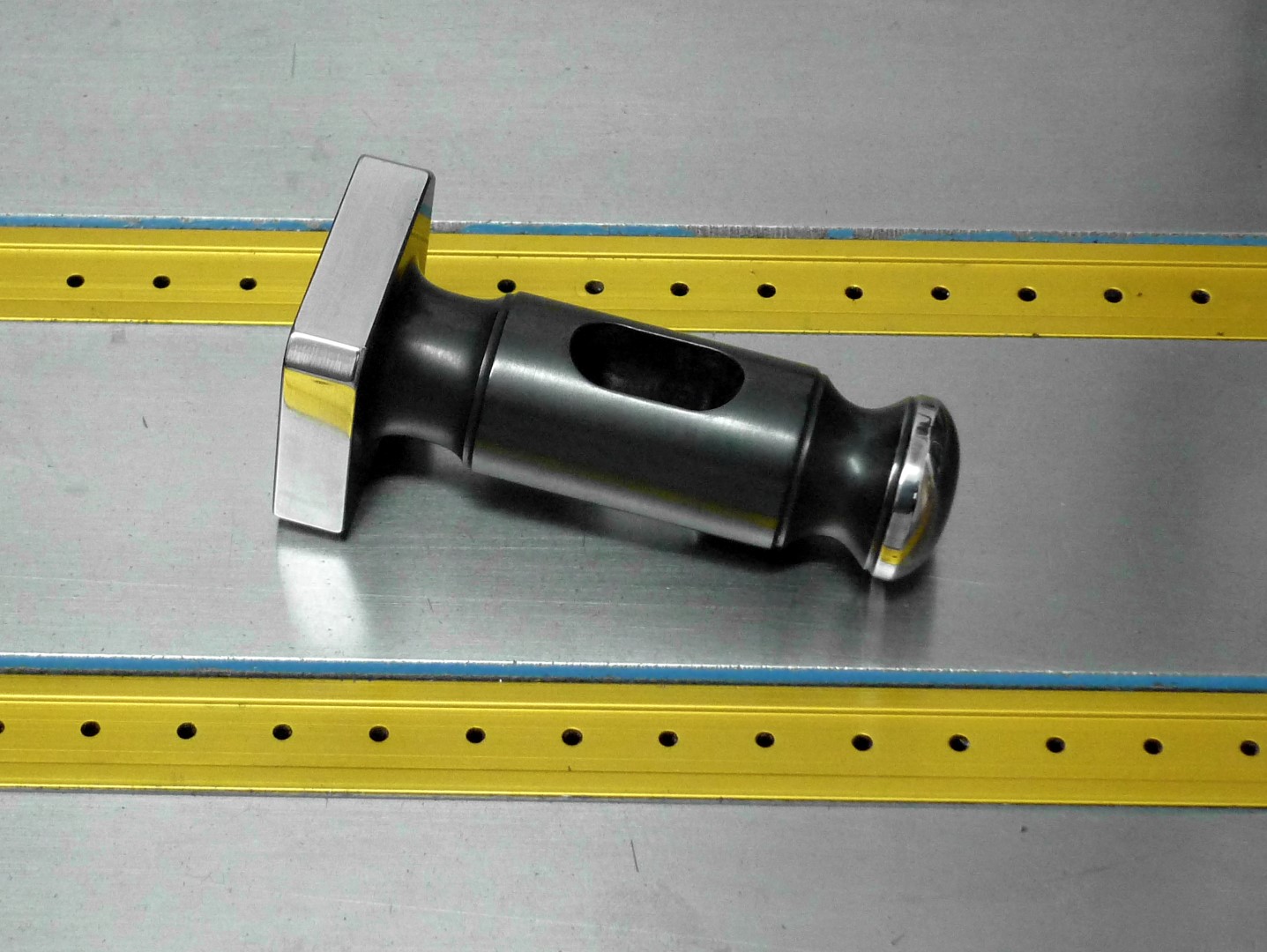

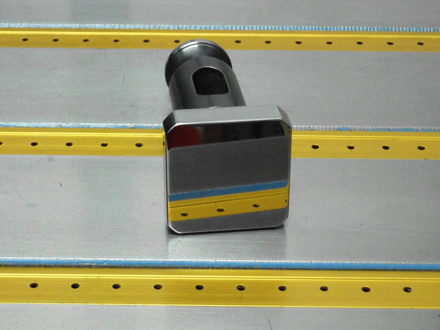

    Careful enough this time I didn't forgot to mill the flat on the hammer's head for reference. The flat surface aligned with the DTI on the square collet block and the rest was easy.

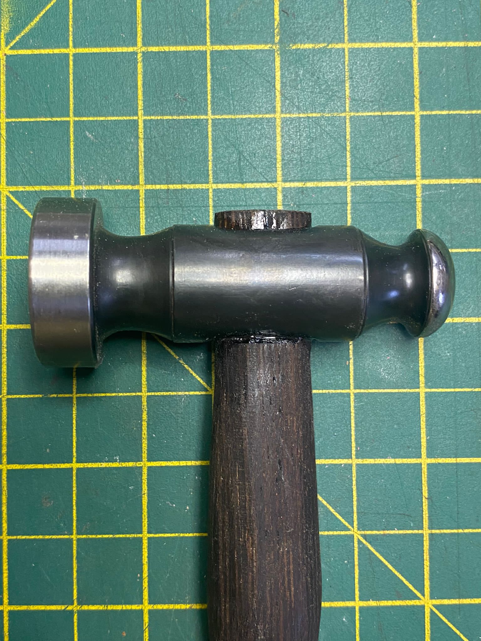

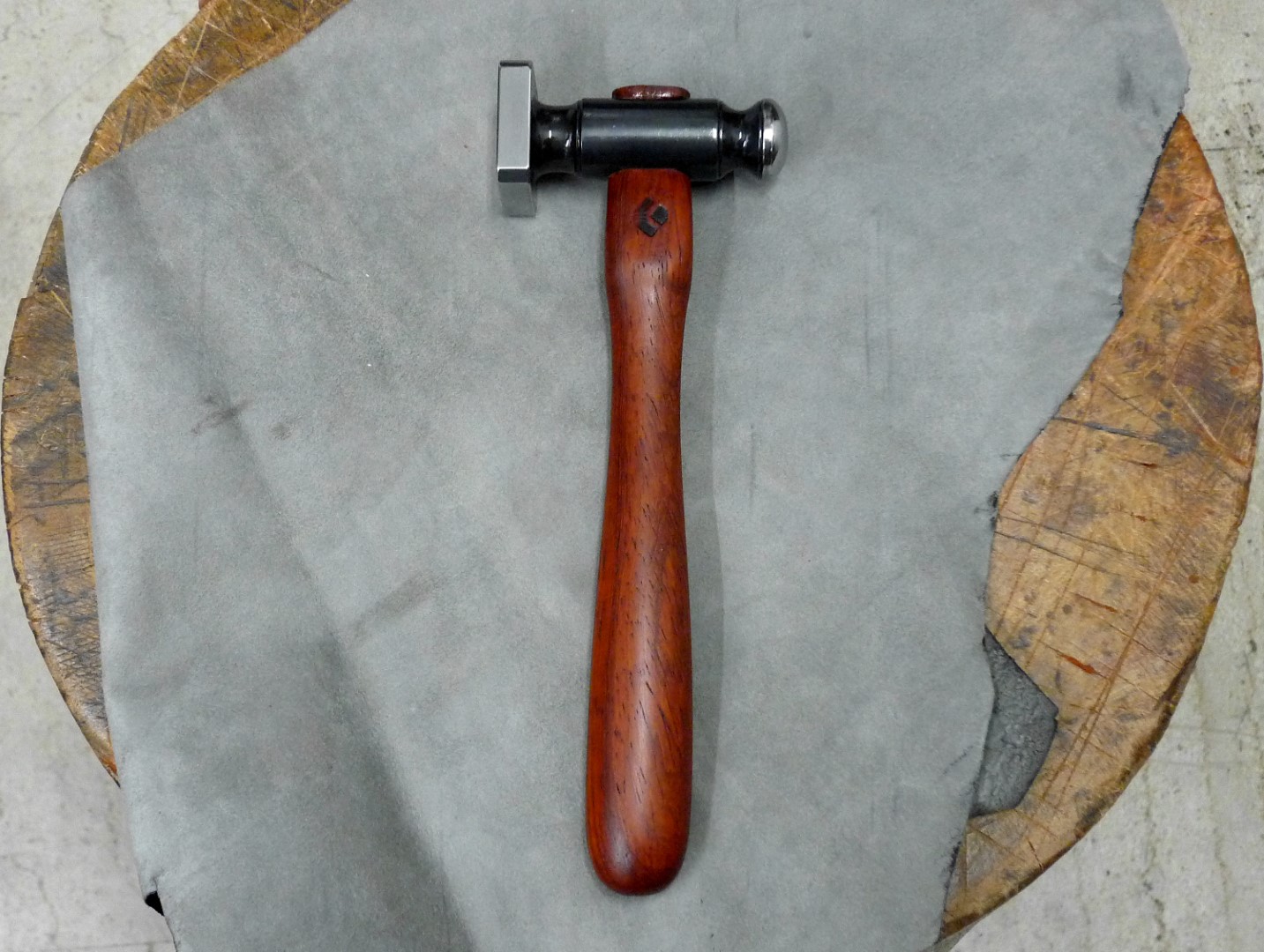

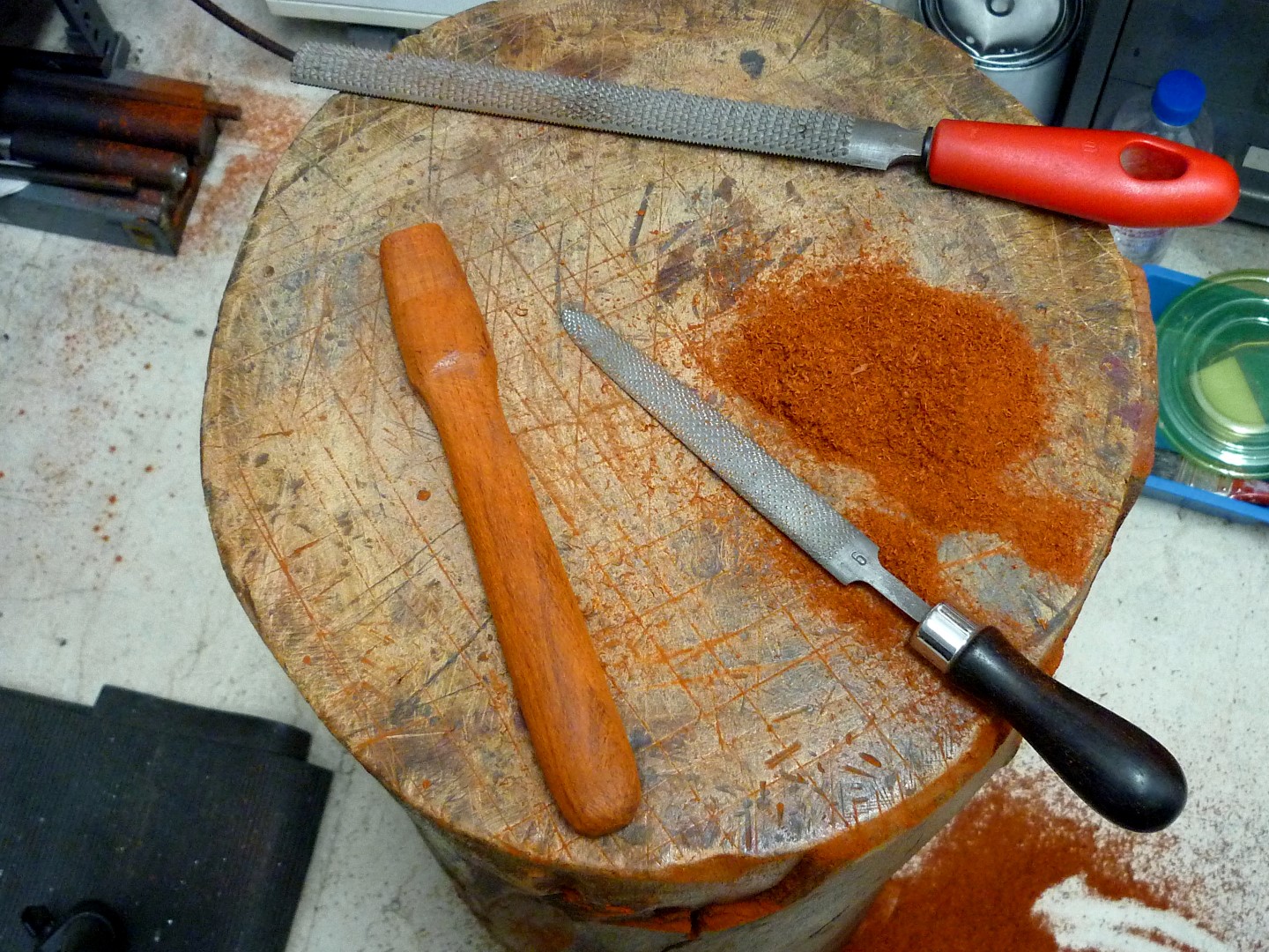

    For the handle I used Padauk
    Leatherworking hammer-p1160943.jpg Leatherworking hammer-p1160944.jpg Leatherworking hammer-p1160946.jpg

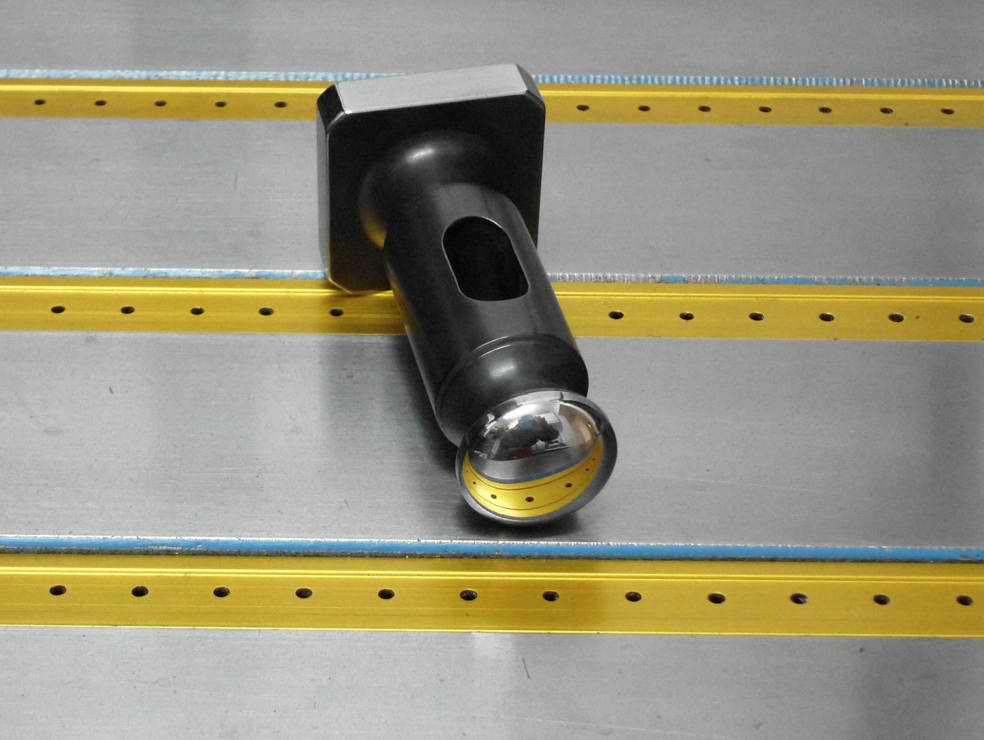

    The hammer was hardened to 54Rc; the faces got a mirror finish using 3000G sandpaper and a good polish on the buffing wheel.
    The overall dimensions of the hammer are:
    Length 70mm
    Body and front head diameter 20mm
    Square head 32.5x32.5mm, 7mm thick
    Hammer eye 18x8mm
    Total weight 169gr

    Thank you very much wizard69. I appreciate that you like the hammers.
