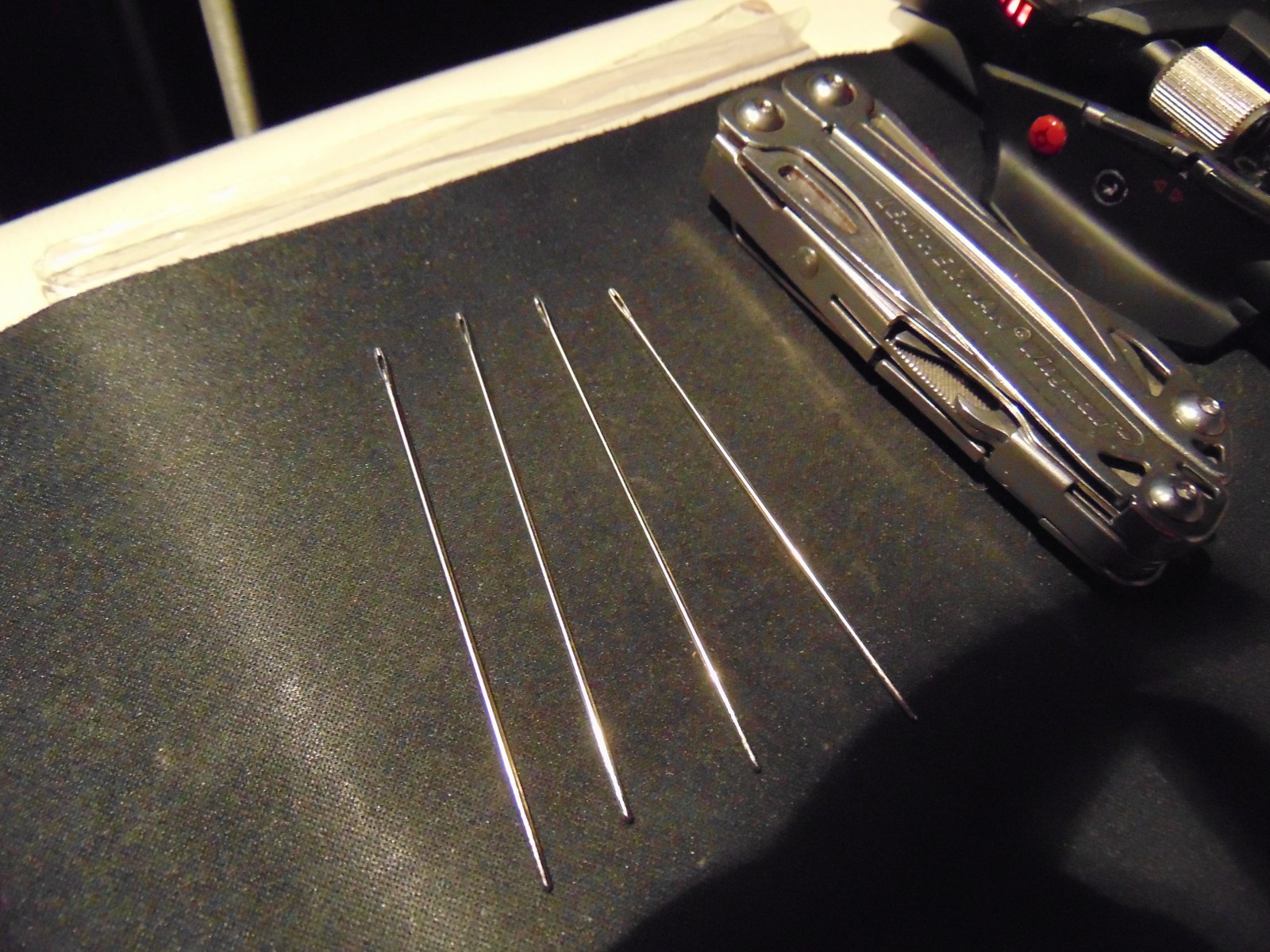

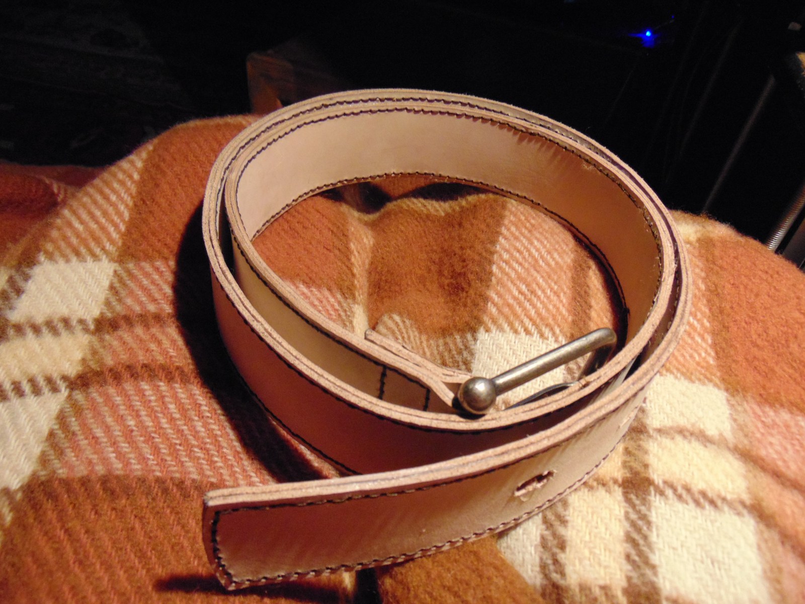

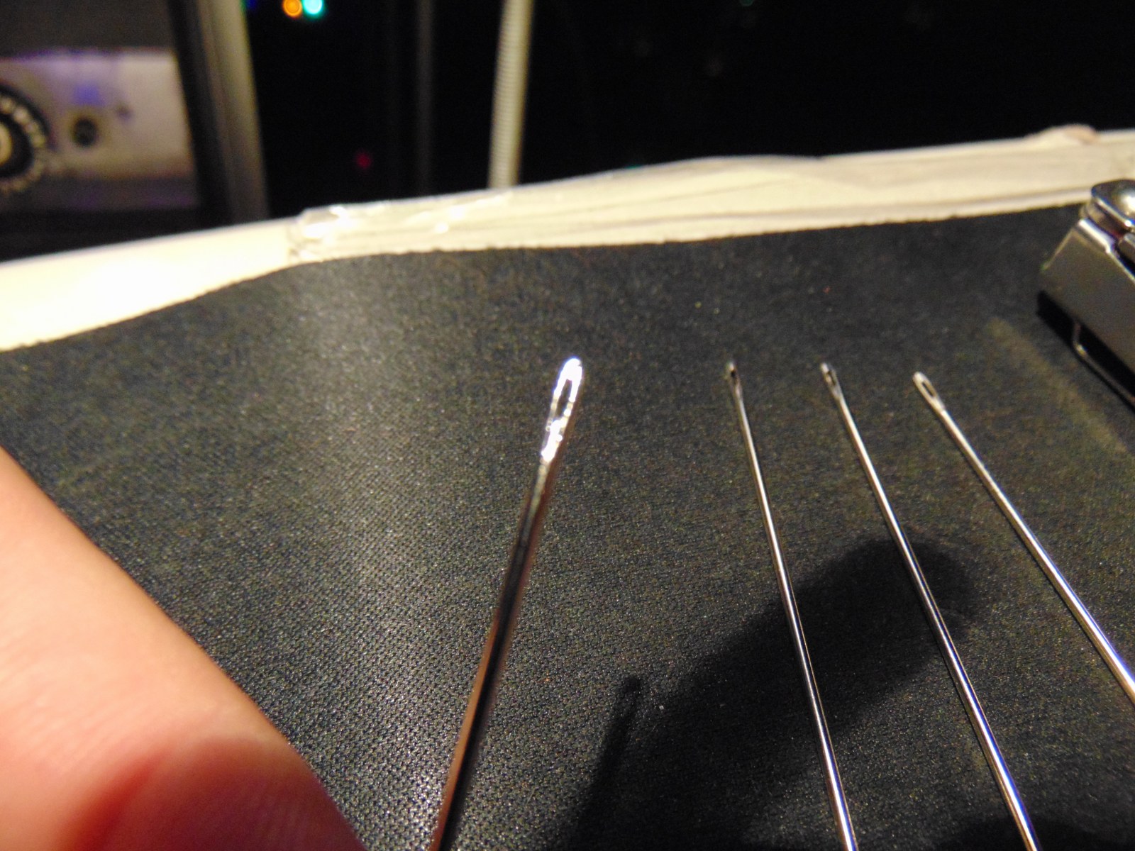

    Hi all
    I finished sewing leather big belt, a bit long work, because I broke four normal needles moving them bad. My fault
    I buyed 4 new "right tools", strong Needles with short eye and round point, good for 1mm waxed twine. I have to make X pattern in buckle stop, trim the edges, decide a good color and polish.
    I'm also thinking about size, pockets and accessories like multitool and other things.
    Some pictures
    Leather leg bag-dsc01594_1600x1200.jpg Leather leg bag-dsc01597_1600x1200.jpg Leather leg bag-dsc01599_1600x1200.jpg

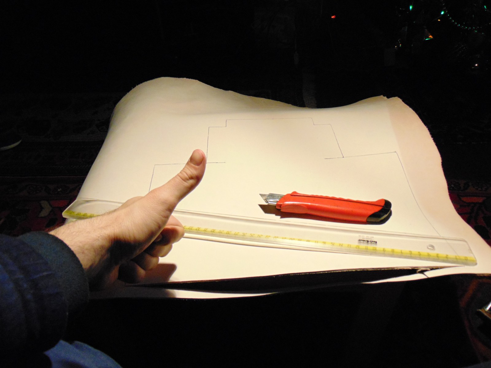

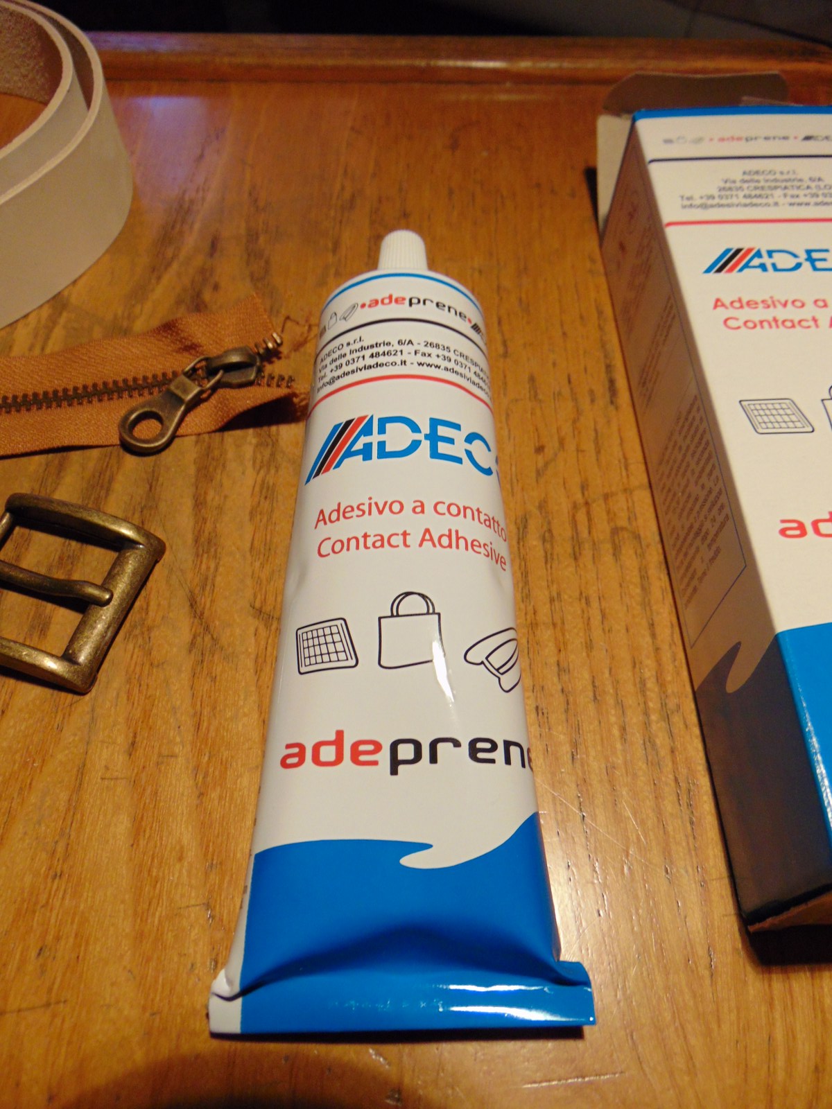

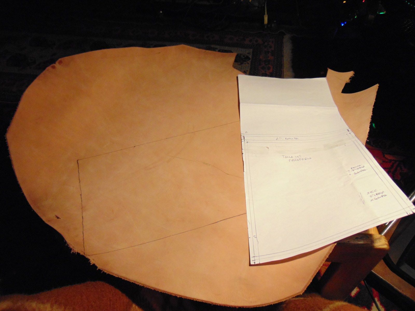

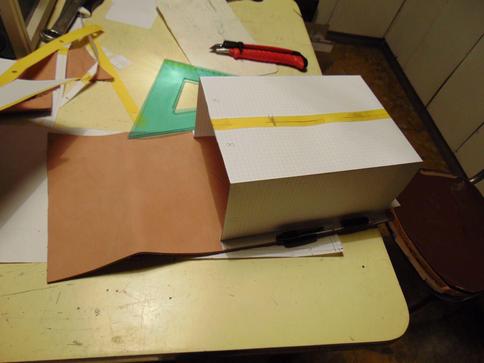

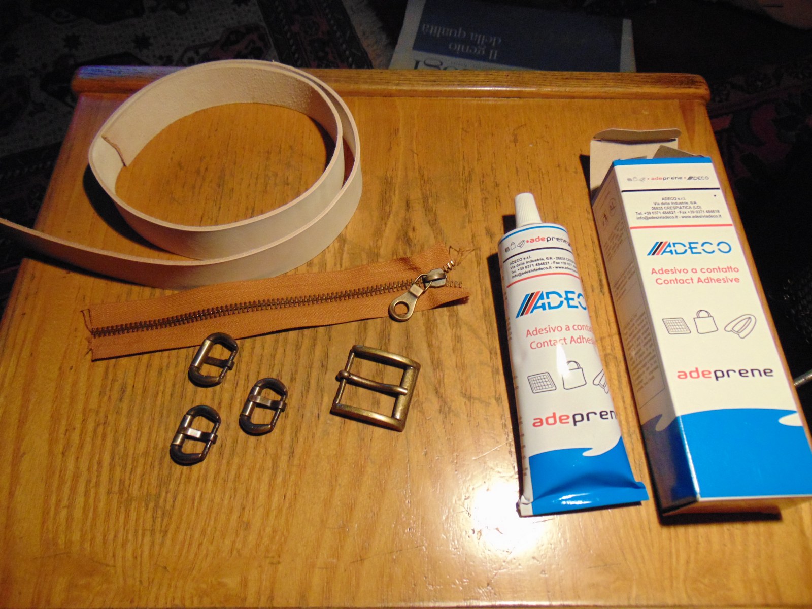

    Hi all

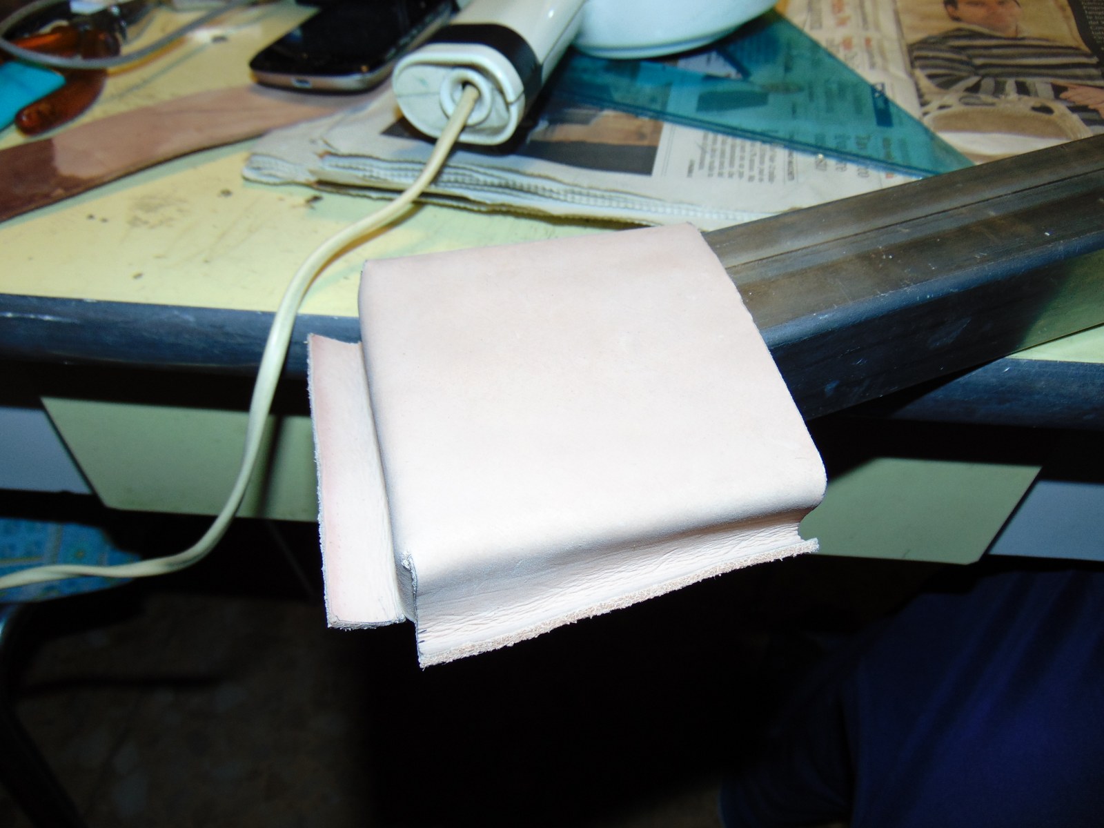

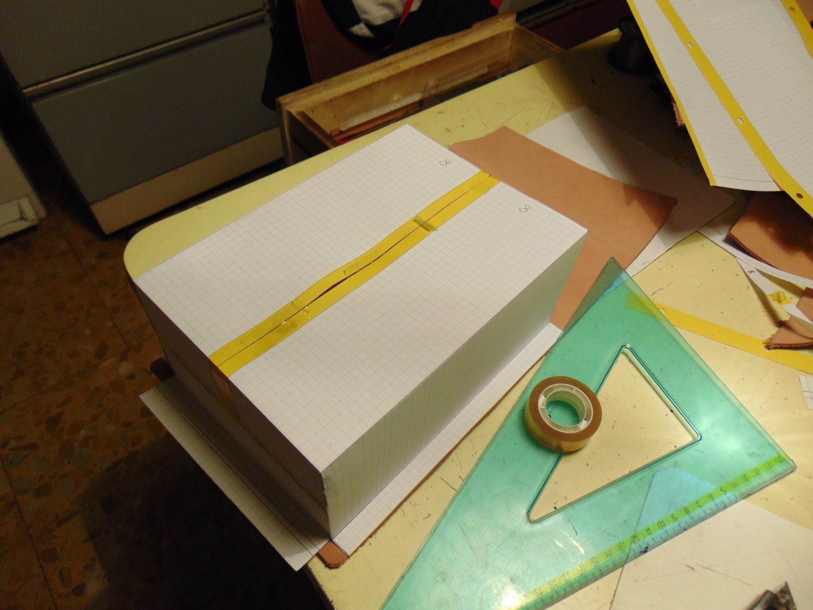

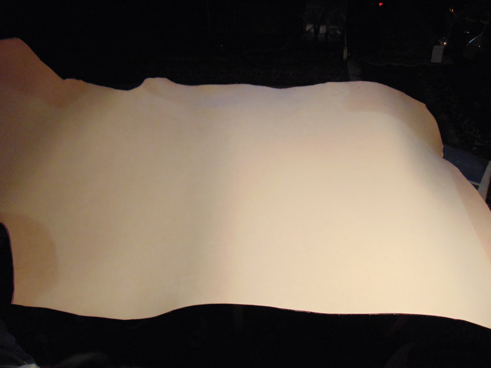

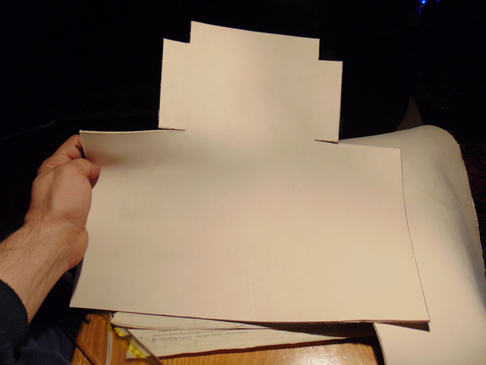

    Small update
    I bought new leather, special glue, some buckle and a zip, luckily good components from local shop!
    I'm not sure about location of pockets, for sure one inside pocket, with zip for wallet, big enough to carry even something else. Two lateral rectangular pockets with a small buckle. Don't know if can be useful to place some other pockets, belts or other parts, any idea?
    Leather leg bag-15326084_10211103511366383_8020893066468610167_o.jpg Leather leg bag-15325389_10211112832119396_1774795374884498322_o.jpg Leather leg bag-15369239_10211112832799413_4456061825270445186_o.jpg
    Leather leg bag-15392950_10211112832599408_8327669073105072323_o.jpg Leather leg bag-dsc01651_1600x1200.jpg Leather leg bag-dsc01652_1600x1200.jpg
    Leather leg bag-dsc01654_1600x1200.jpg Leather leg bag-dsc01655_1600x1200.jpg

    I've made several belt pouches in the past for wallets and one for the huge old calculator I used to carry when in the school. Since I don't like messing with zippers much less the hassle of installing them I used the natural ridgitiy of the leather that cloth doesn't have to advantage. I always used flaps with either snaps or Velcro, leaving enough of the flap overhanging to be able to grab it easily to open. Never had a problem with security.
    I'd want to make the sides of the bag accordion with a strap like all the new frameless back packs are so things stay secure and don't rattle around in the bag. But that's just me. Good luck.

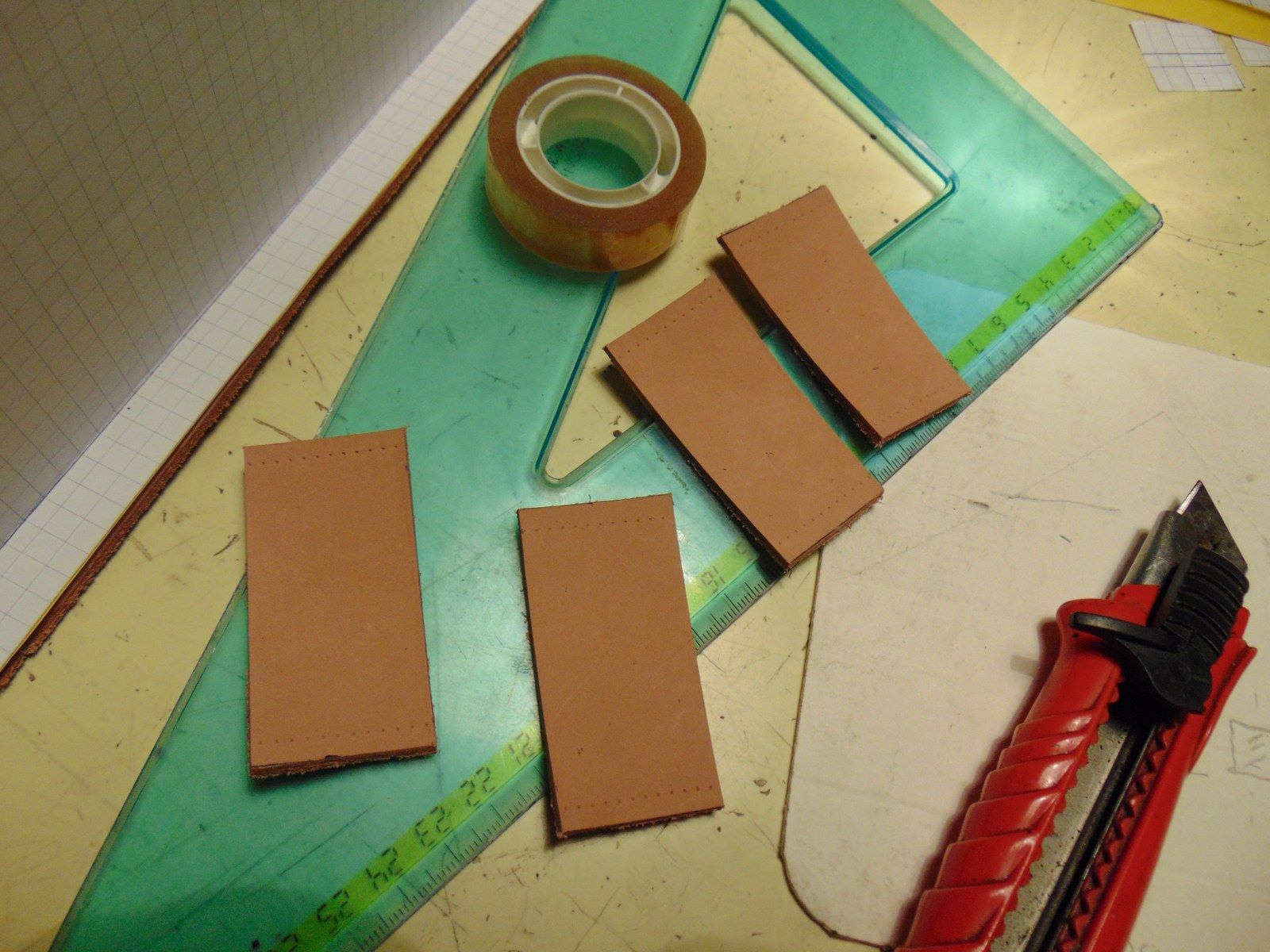

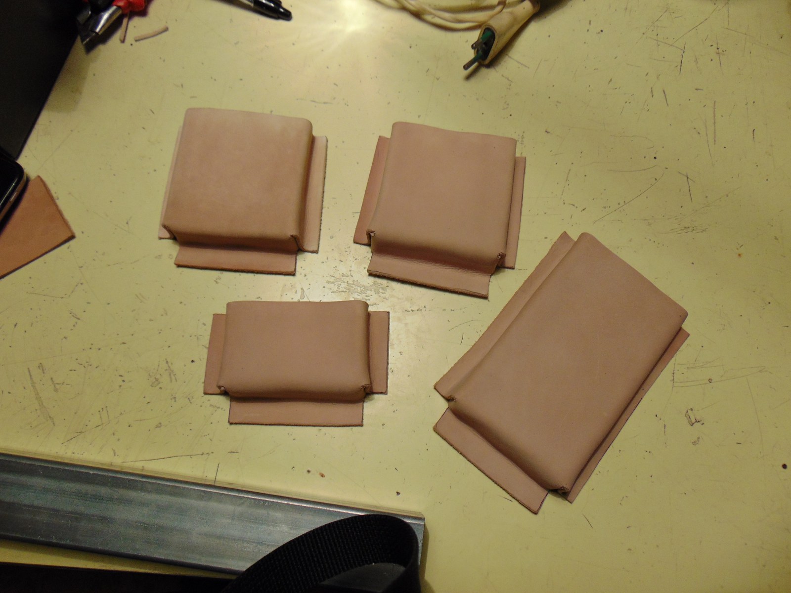

    Hi! I'm trying to build pockets, result is not so bad, it will be a trouble to apply color!
    Leather leg bag-dsc01781_1600x1200.jpg Leather leg bag-dsc01782_1600x1200.jpg

    So now you are going to attach to a flat piece of leather for the back and flap? As to color, we always put color on before assembly as it's easy to do when flat, almost impossible when together. Is that Latigo leather? If so it darkens a little with some neatsfoot oil. I like how it ages with nothing as I've made several instrument straps out of it. It also gets very flexible with age which I like too.
