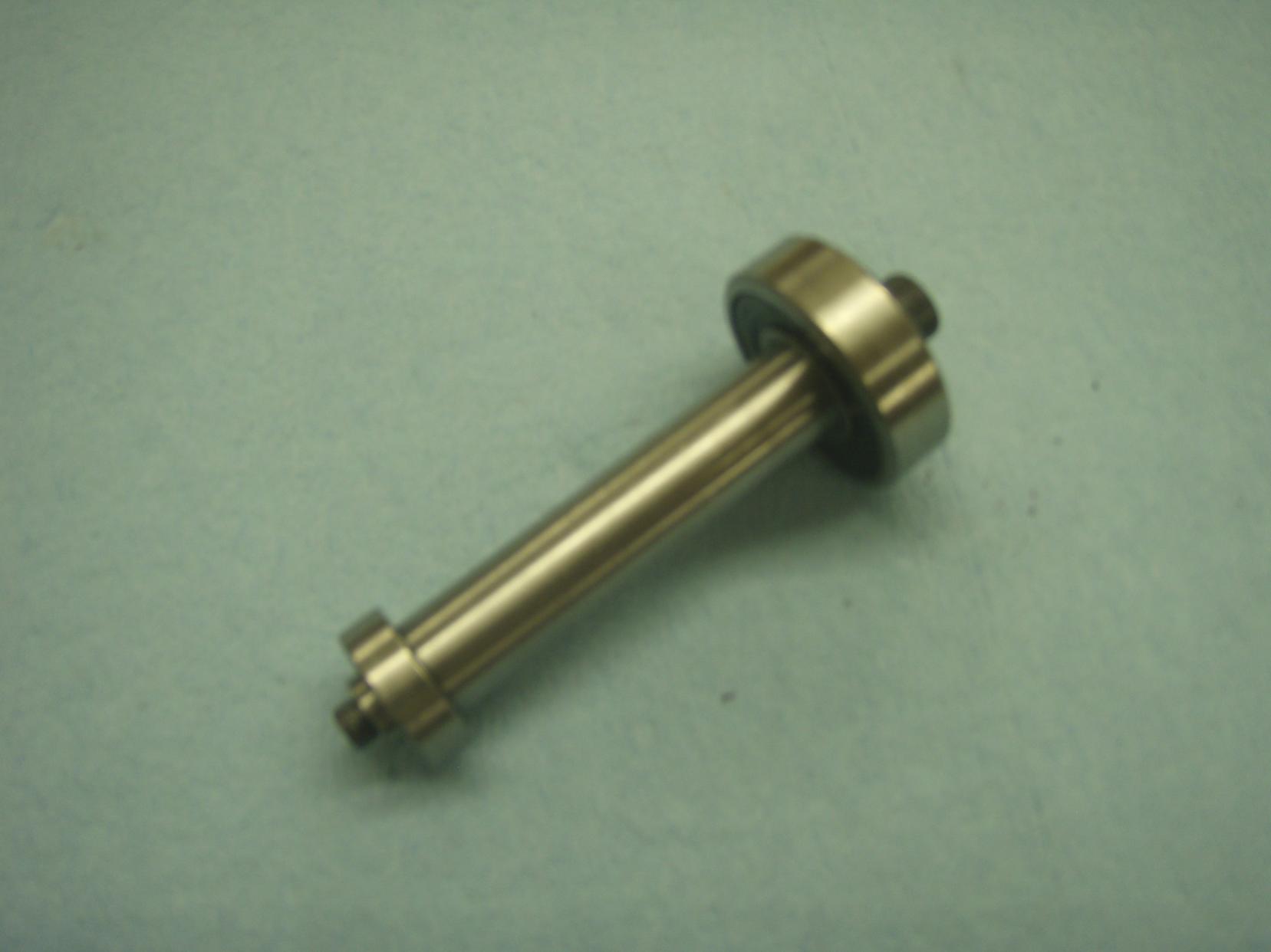

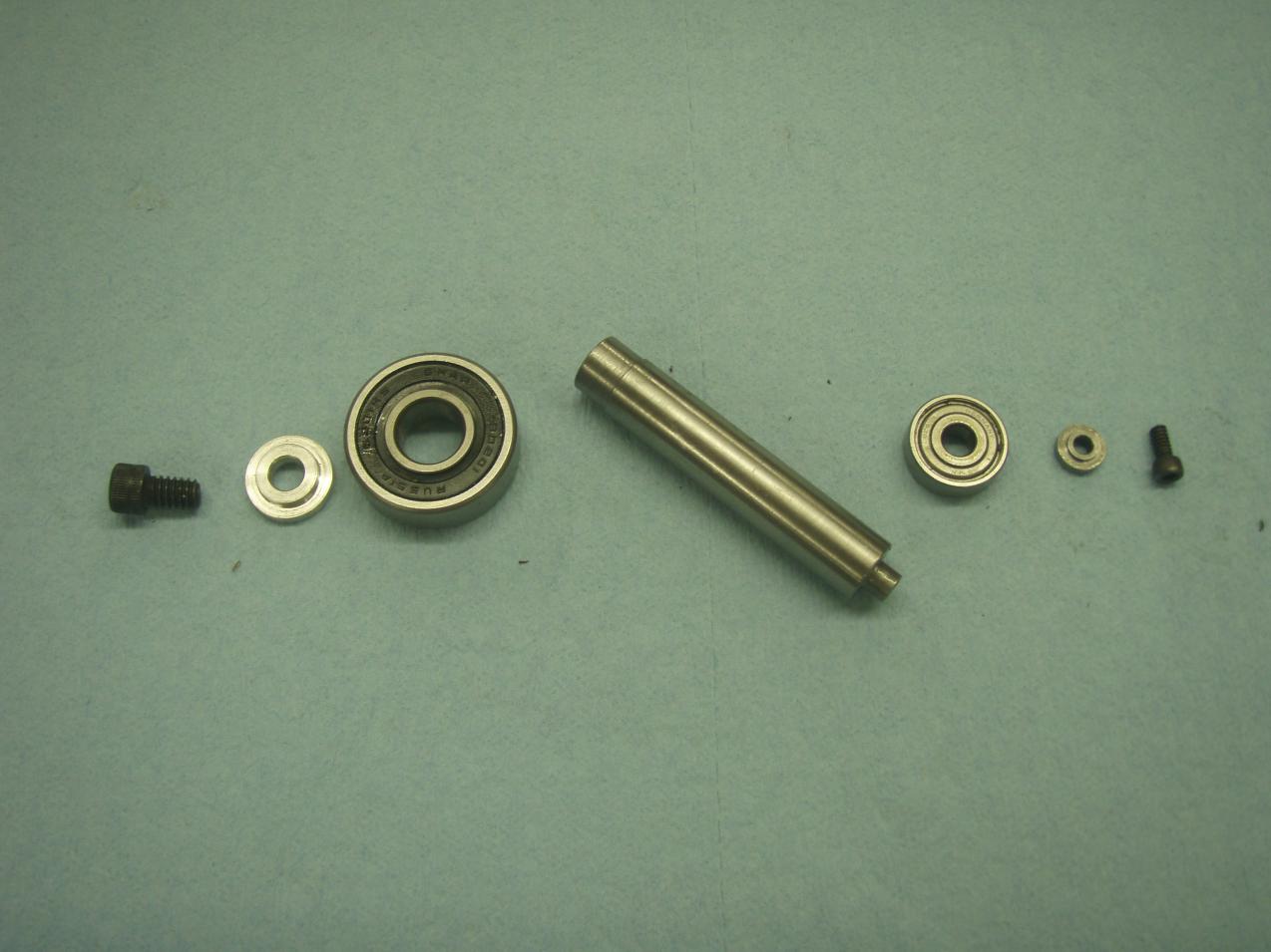

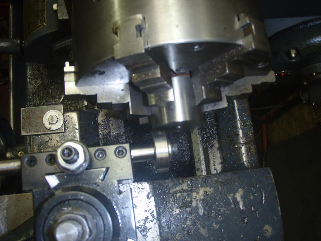

    Lathe Workpiece Alignment Tool
    Lathe Workpiece Alignment tool. Lightly hold the workpiece in the chuck and run the bearing up against
    the workpiece. Apply enough pressure until the workpiece runs true. Great for small/short pieces.

    Pretty clever, Catfish.
