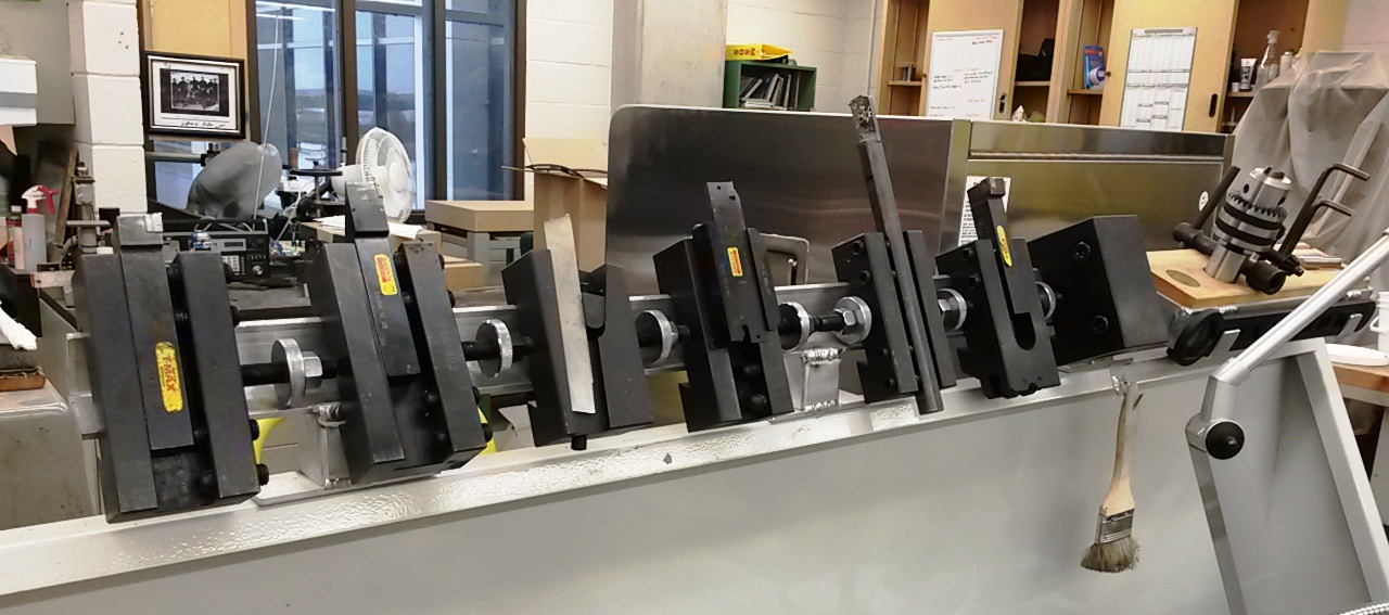

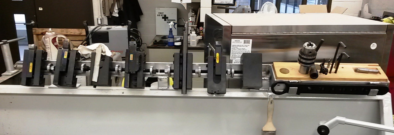

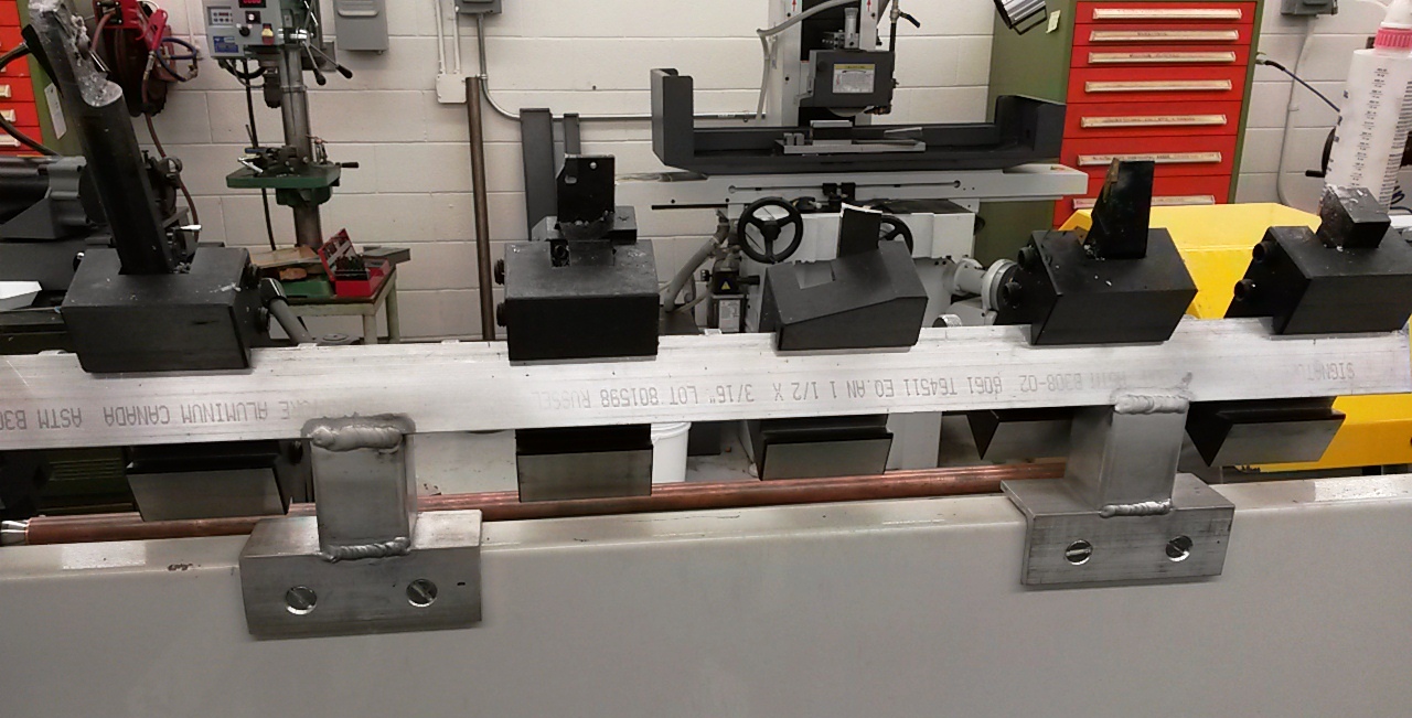

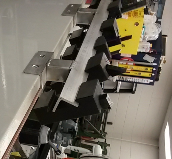

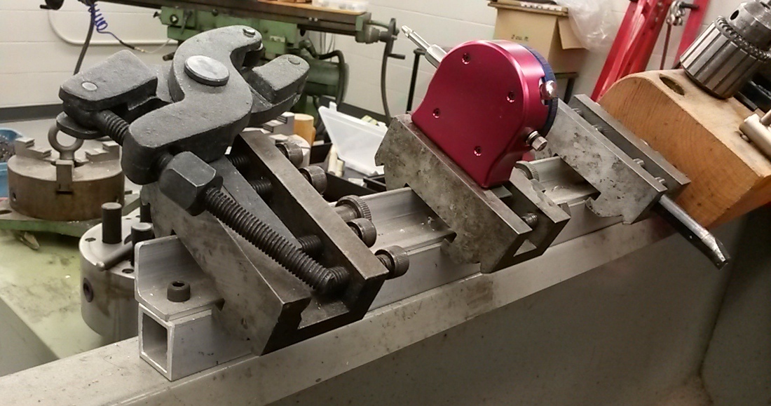

    Thought I would post a couple photos of the toolholder racks I built for the lathes at work. The first is dead simple, and is just a piece of aluminum angle bolted through a piece of aluminum square tube to the top of the backsplash. The second has more fabrication involved and is a piece of aluminum angle welded to some standoffs to mount on the backsplash of the larger lathe. I added a rack to hold the tailstock accessories and commonly used wrenches.
    Both work very well to keep the holders organized and within easy reach. Hope it helps someone!

    Nice use of the angle stock; especially on larger rack. No horizontal surfaces for chips to land. I think a QC setup isn't very quick until tools are parked in order they'll be used on a a set of parts. A lot of buyers get a system, then forget the logic of how a machining process benefits from QC tooling. Somehow a New York traffic jam of tool holders comes to mind.

    Thanks Toolmaker51. What you can't see is that the shop is on the 5th floor.(!) I work at a small university, and using this machine shop is part of my regular duties. Pretty mundane work most of the time, with the odd bit of interesting material or jobs. I am pretty lucky!
