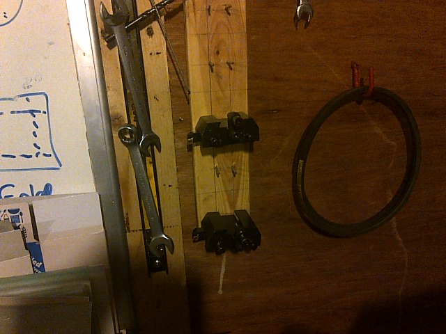

    first up is a holder for my q/c tool holders.
    its basically a leftover slat of wood with pins in to hold the holders and make it easier to get right tool when changing them over.

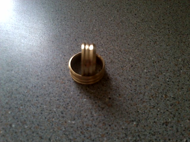

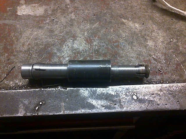

    second is a double ended collet i knocked up to hold some rings i was making.
    its made from 1" rd stock one end was drilled/tapped m12 to use bolt to open it up to hold ring other end m8.
