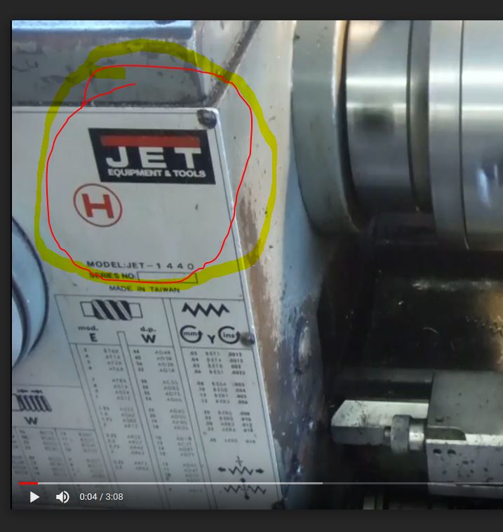

    Quote Originally Posted by gatz View Post
    ? PJ....... there's no faceplate on the lathe
    In post #3 you said to Frank:
    Can't run my circa 1900 16x40 or so Hendey in reverse, as the chuck unscrews!
    Faceplate was an inappropriate term as in Mounting, I meant the Headstock Face/nameplate.
    Watched the video again and took a screen shot of the JET Model 1440...
    So I take it you have an old Hendey as well...definitely no reverse on it.
    Sorry for the confusion. I do like the shoulder close threading and the idea of your disengagement system is pretty cool!
    PJ
    Mark Twain
