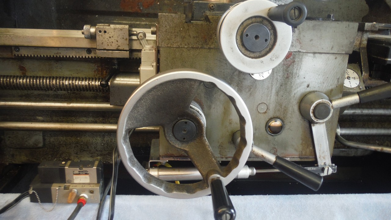

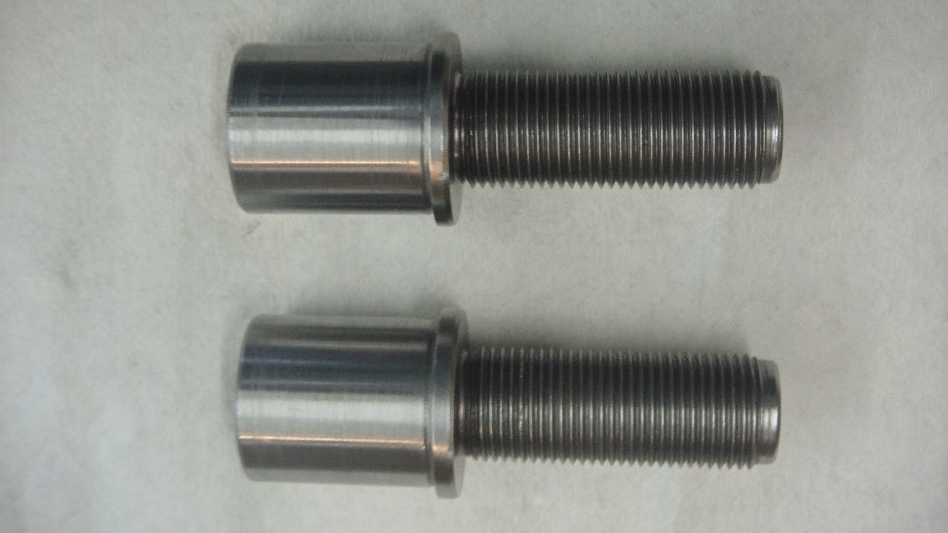

    Often times, there's a need to stop a threading operation at exactly the same place.
    A dial indicator generally works, for the most part, but it's easy to make a mistake; usually with dire consequences.
    I needed to thread some 4140 pieces right up next to a shoulder & with the least amount of under-cut.
    Blank parts were turned to 3/4" diameter and had the necessary undercut in the 3-jaw chuck.
    I set the lathe up with a Limit Switch, a 110v Solenoid Valve and a small Air Cylinder.
    The adjustable carriage stop is set to trip the Limit Switch at the right carriage position, which then powers the Solenoid Valve which in turn sends air to the Air Cylinder.
    The Air Cylinder pushes the threading lever out of engagement and the carriage stops abruptly.
    It worked much better than I had anticipated. Sure saved alot of time & worry too.
    I didn't take pictures of the Solenoid Valve or the Air Cylinder. They're just common items.
    parts with threading complete;

    A bit confused here as the video show a Jet faceplate on the headstock? Do you have 2 lathes?

    Quote Originally Posted by gatz View Post
    The adjustable carriage stop is set to trip the Limit Switch at the right carriage position, which then powers the Solenoid Valve which in turn sends air to the Air Cylinder. The Air Cylinder pushes the threading lever out of engagement and the carriage stops abruptly.
    This apparently works effectively. Pneumatics; good solution for what would be a tricky action through mechanical retrofit. Your adaptation's made to order for recent tool retraction devices posted lately.
    I think we'd all like to see the linkage in operation, hint - hint. I'm interested where adjustments are, if any, past the bed stop. I'd want zero free play, probably via Heim joints.
    No matter how enthralled I am with distinctive lathes, very few have threading kick out mechanisms. Not many even kick out carriage feed travel, and each I recall depend on a cam and finger.
    I'm guessing worries on inertia of chucks, carriages and maintenance keep machine engineers from making them common.

    ? PJ....... there's no faceplate on the lathe

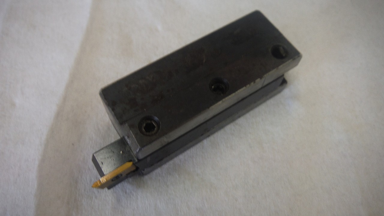

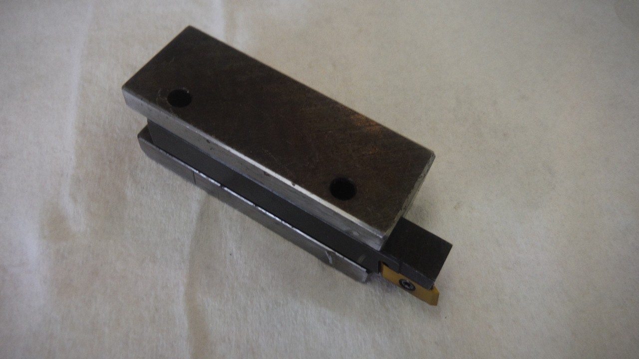

    Believe me, I would have done that, but I'm using ThinBit threading insert & holder.
    And I don't have an adjustable QC tool-holder
    2 problems
    1) Just flipping the tool over wouldn't work.....a Left-Hand holder would be needed and some way of changing the height (the Jet tool-post is fixed height)
    2) It would work for threading OUT from the shoulder, but I'd have to make a mount for it on the opposite side with the right-hand ThinBit & holder flipped over.
    That's the reasons for me doing it this way.

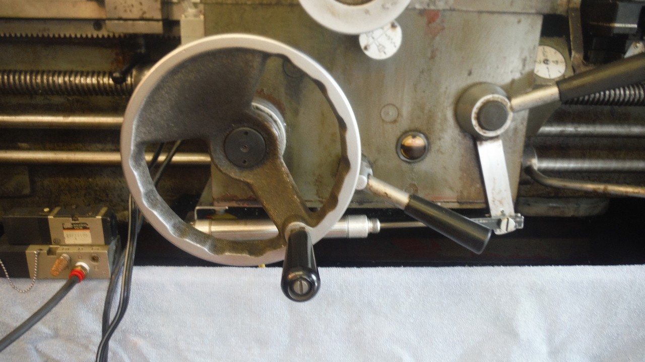

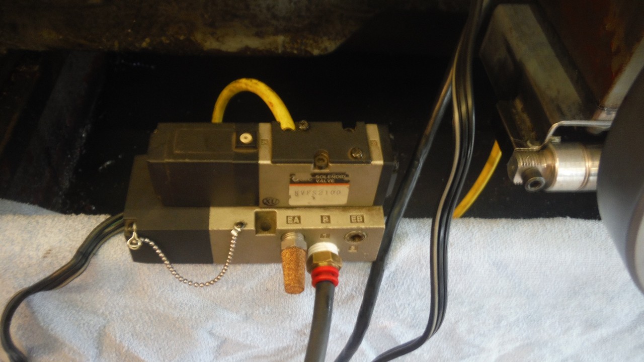

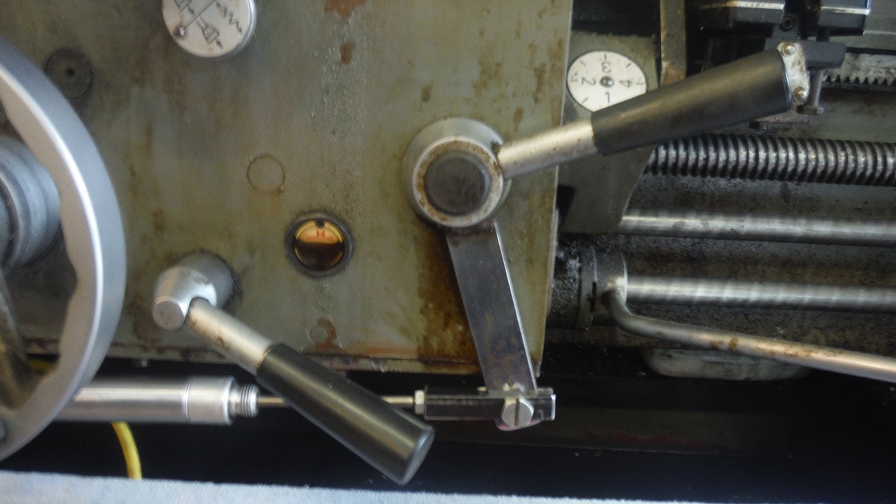

    Here's a few pics of the mechanism. ...I had already taken the set-up down, so didn't make a video of that operation in its entirety; but remounted the components temporarily for those who asked to see it.
