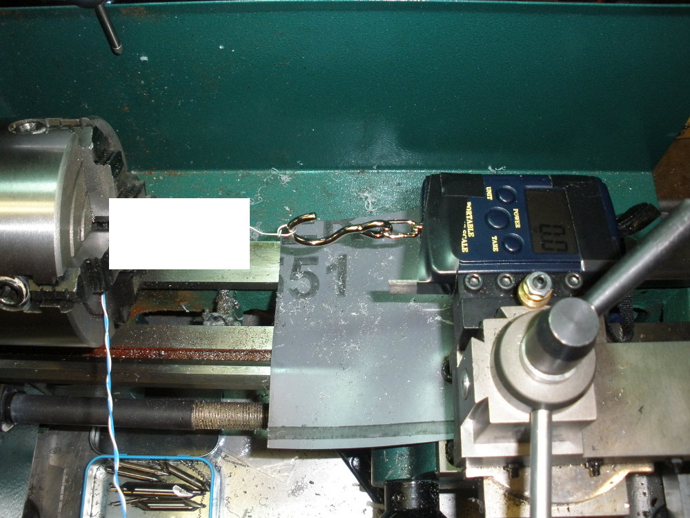

    Lathe as test fixture
    I needed a quick pull-test for a customer's product. So, clamp their product into the lathe chuck (redacted in the photo) and tape a hand-held weighing scale to a cutoff tool.
    Proceed with test, customer happy.
