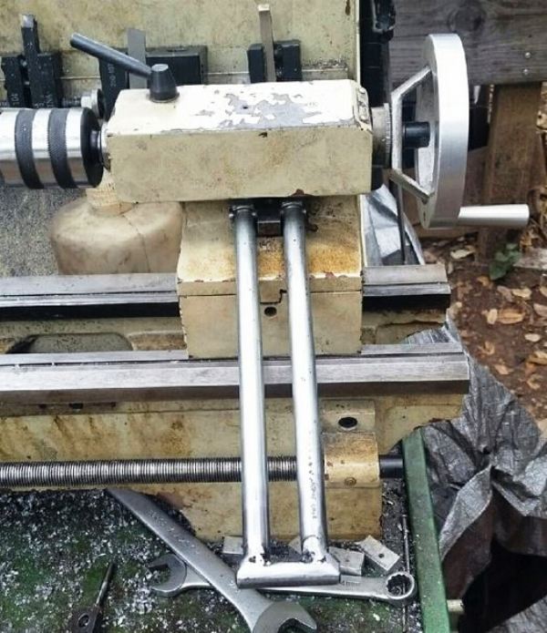

    Since I've been on a jag getting around to things I've been meaning to do I made a quick lock for my lathe's tailstock from 2 12" bolts and a piece of 3/8" scrap from my pile. The bolts had the sides of the heads sawn off flush with the shank so they looked like a T from the side, then cross holes were drilled in each one. Then I cut a small piece of 3/8" plate, turned trunnions on each side which go into the lever holes and finally threaded a hole in the center for the long clamp screw which used to clamp my tailstock down. A bit of rounding on the belt sander of one corner of the remnant bolt heads and a cross bar welded to the bolt ends and Bob's my uncle, and if any wear is experienced I can easily adjust the bolt to tighten the locking force again.
    In the down position the tailstock moves freely.

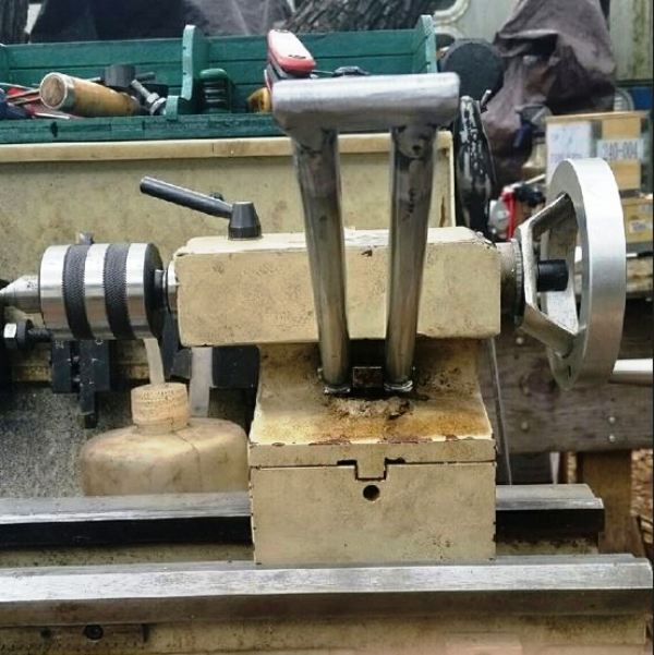

    And in the up position the bolt heads apply force to the tailstock base, tensioning the bolt and clamping the tailstock to the ways. The geometry is such that the bolt heads cam over in the locked position so that the lock stays put until I want to release it.

    So now you have a rigid arm sticking a couple of feet out from the lathe, wont be long and your hip or leg will love you for it, eh. :-)

    I can readily see how that would be a problem for some, but since I always Pay Attention Around Power Tools I don't anticipate any issues. I made it for me and no one else.

    Crusty, thanks for posting. I have started thinking of doing this on my lathe. If you ever take it off could take some pictures of the side view.

    Imagine a cross shaped piece of 3/8" flat plate with the side arms turned into round trunnions (about.325" dia) and a clamping bolt hole drilled and threaded in the cross a bit aft of the trunnions' centerline.
    The trunnions go into holes cross drilled in the bolts.
    The bolts' hex head sides are trimmed off flush with the shanks, leaving the top and bottom portions of the hex heads.
    The bolt heads have been rounded at the aft bottom corner on a belt sander so that they bear on the tailstock base surface smoothly as the levers operate.
    The bolts' cross drilled holes are placed so that their centers locate the bolt heads forward of the tailstock clamping bolt center but aft of the trunnions' centers, creating a force triangle which wedges the rounded edges of the bolt heads against the tailstock base.
    The rounded portion was profile sanded so that maximum force is reached somewhere in the middle of the lever travel and the bolts heads cam over, locking the levers against the upper tailstock ledge.
    The cross bar welded to the other end of the bolts prevents the bolts from coming off the trunnions.
    I took it off and put it back on enough times that I won't be taking it off again except at gunpoint.

    I've used a combo wrench for a couple of years now but I gotta tell you this is a big improvement. Since I routinely use a center in the tailstock to set my cutting tool height I move the TS in and out a lot and this is much faster for that.
    Sit down with a pencil and paper and make a conceptual sketch to see how it operates and the approximate dimensions. I think in my version the distance between the trunnions center and the clamping bolt center is of the order of around 3/8" and the bolt head cams exert maximum force within that span. The rounding which occurs last is used to fine tune the operation and since you're reducing the apex of the cam it fine tunes the clamping in conjunction with adjustment of the clamp bolt to set the clamping force (just enough to solidly hold the tailstock).
