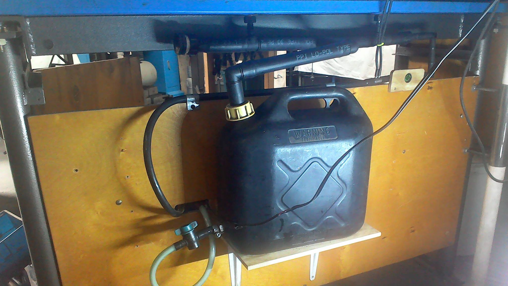

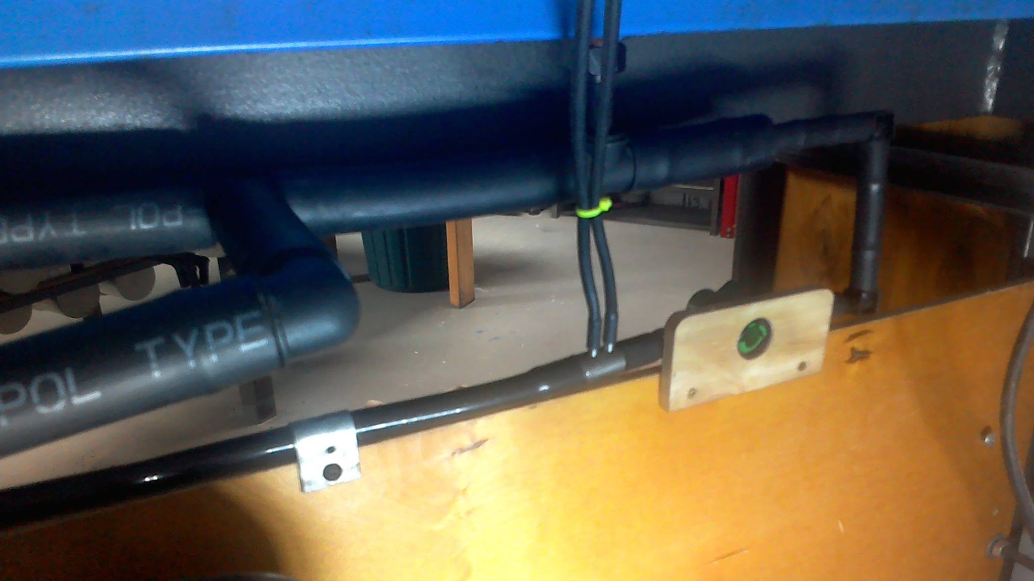

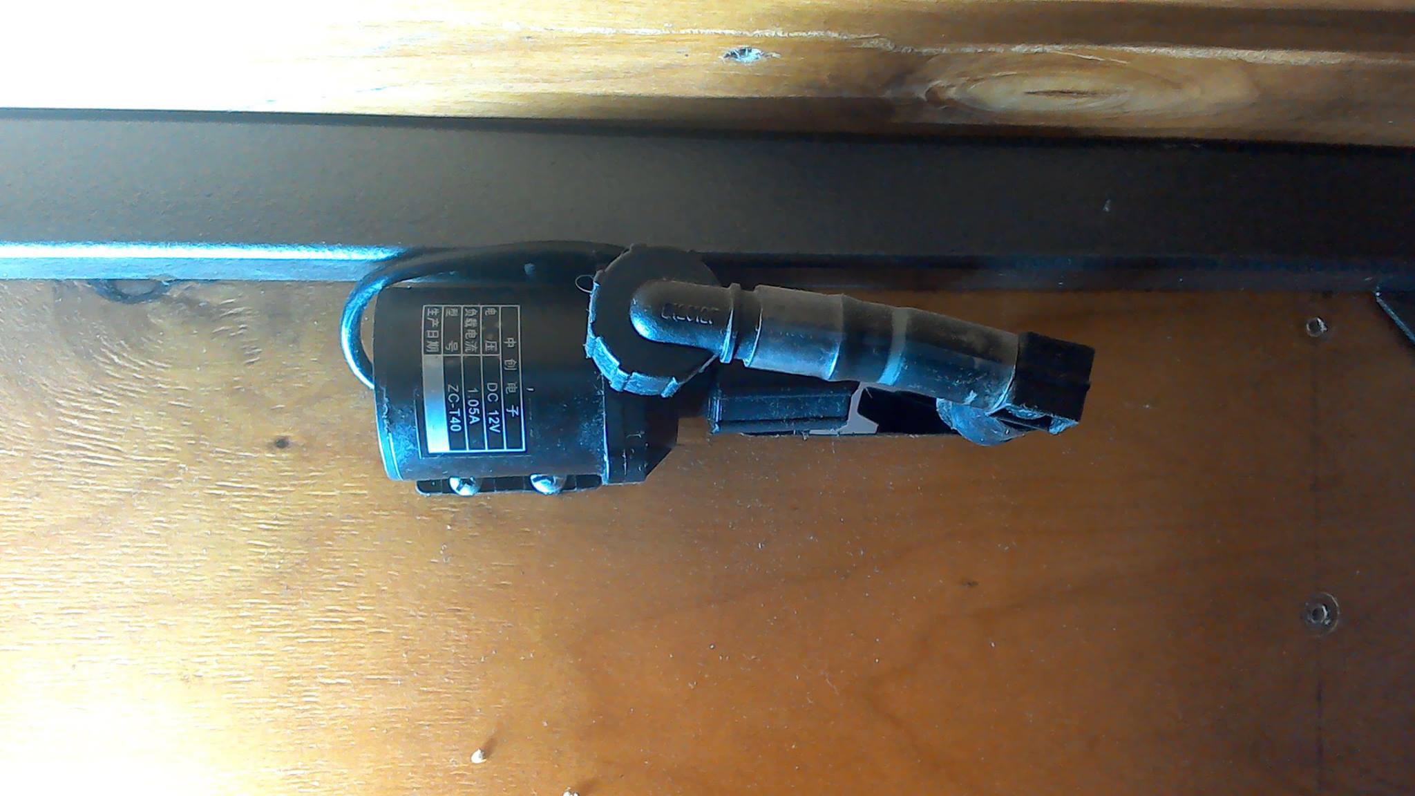

    This is the coolant system I've built into my lathe stand. It consists of a 10 litre plastic jerry can, a $25 centrifugal pump off ebay, a couple of flexible nozzles and a heap of retic pipe and fittings. It's been running for eight years now with no problems. The coolant container was originally on the back of the stand, but proved a little difficult to get to to top up, so, I moved it to the side. It's a sealed looping system, so very little coolant loss and it's continually aerated, so no smells. Here's a video showing it working.

    Click the link, the lathe bed protector is there, along with some other things I've done. https://www.homemadetools.net/builder/th62

    Nice build. Do you have any clogging problems with the drain holes? I had to make a strainer held in place with magnets that stops crap going down the plug hole.

    Occasionally some swarf gets stuck in the holes as they're only 6mm, but the coolant still drains. I just poke the swarf down into the 25mm drain tube and it runs into the coolant container. The feed for the pump is well clear of the bottom. Never had any problems in eight years, save for the way oil draining into the coolant container and making junket.
