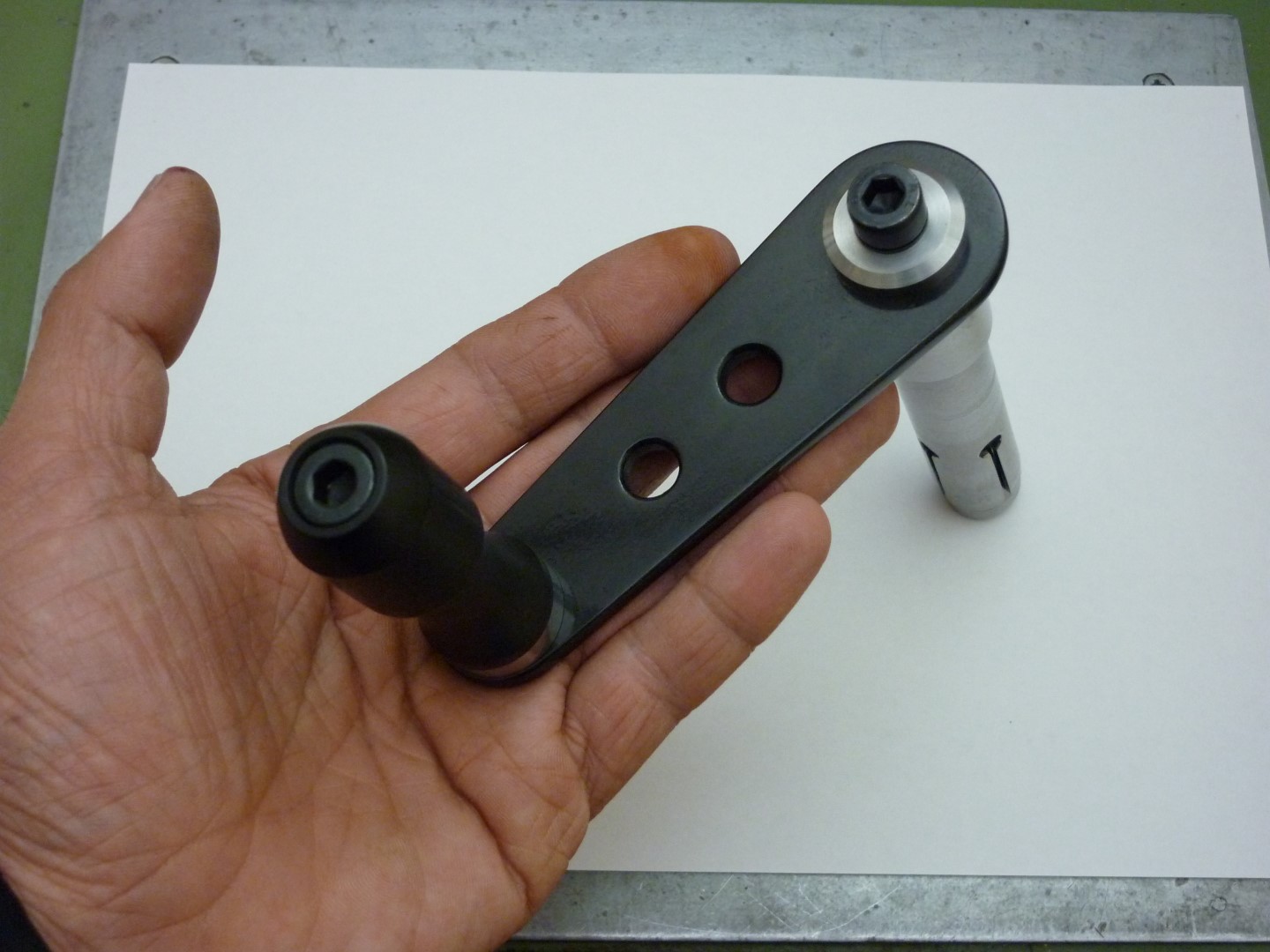

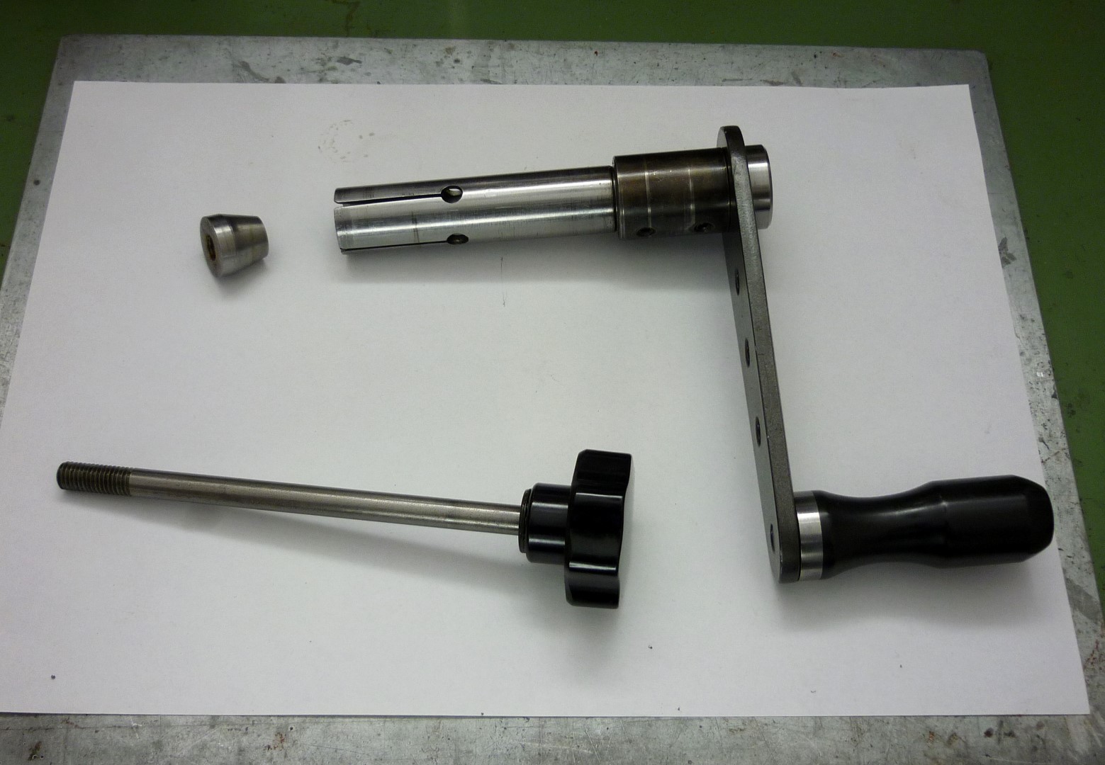

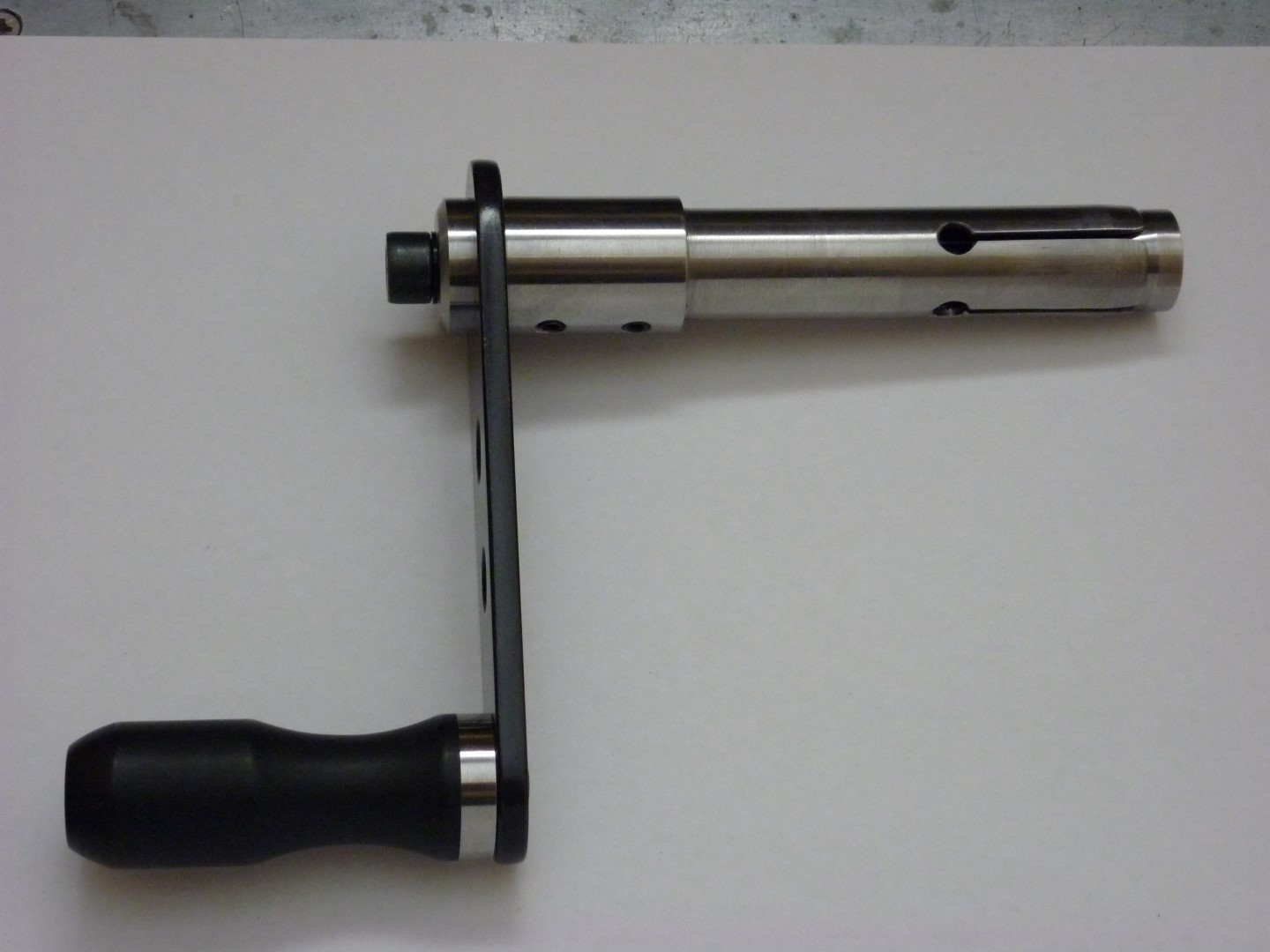

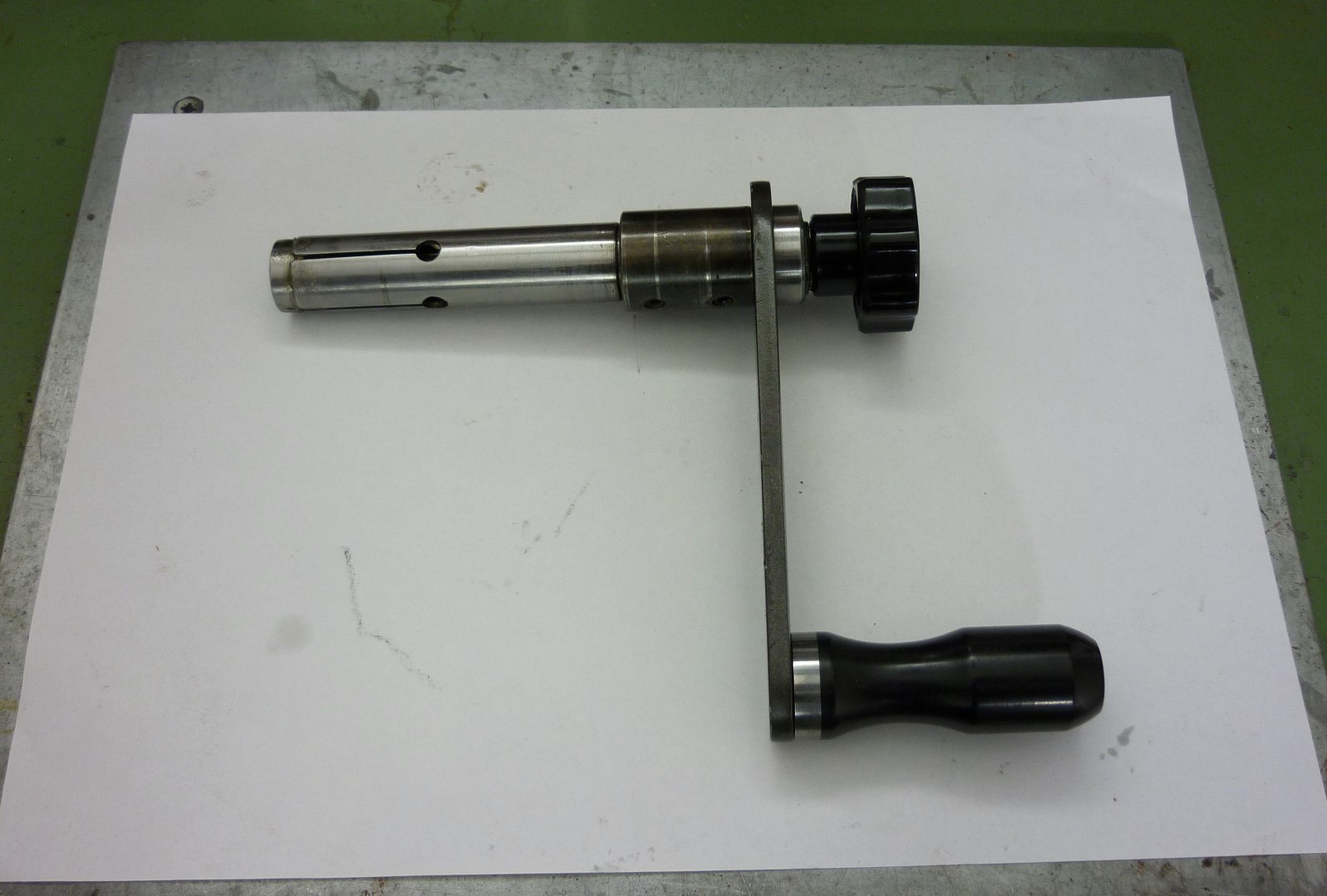

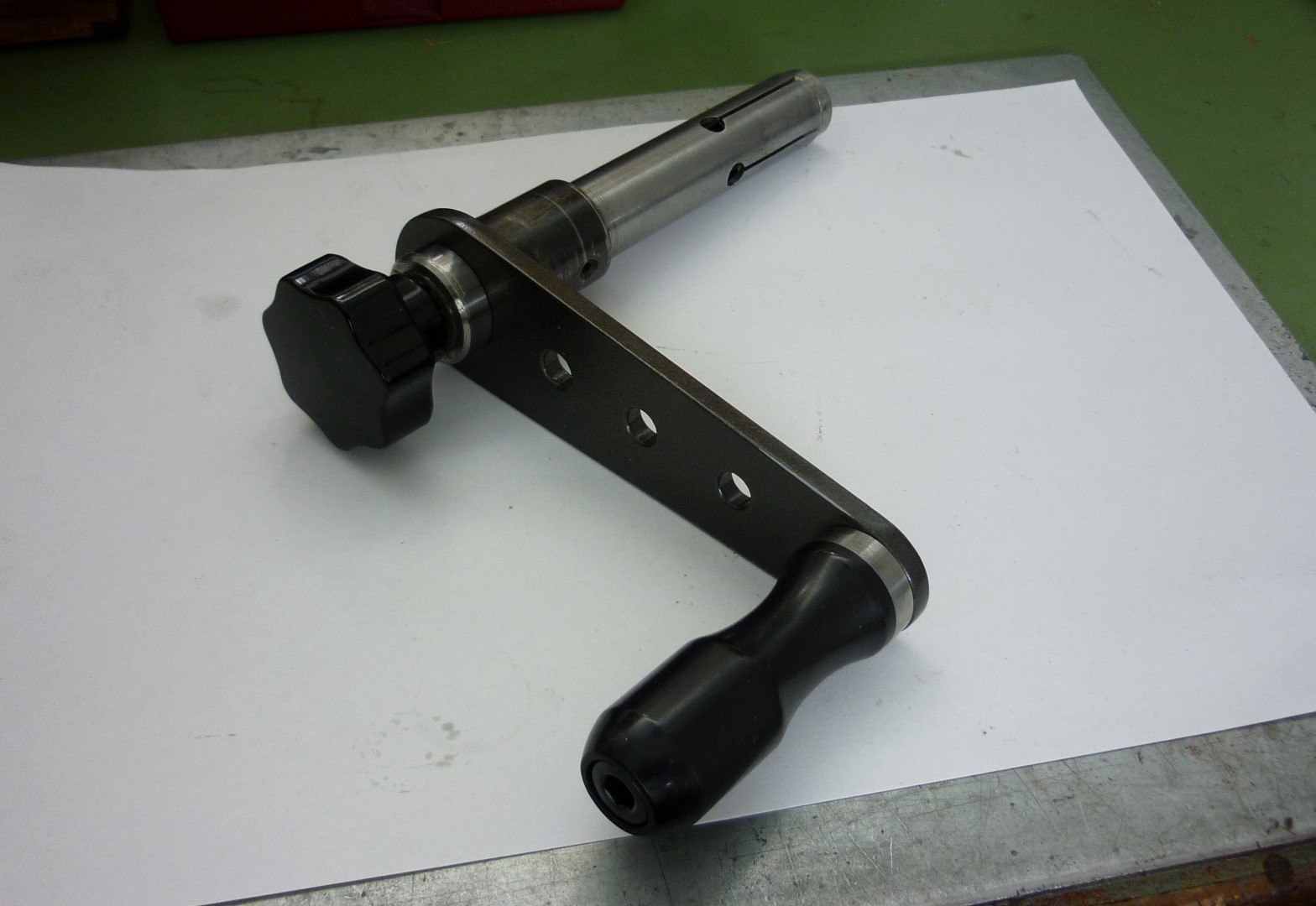

    Hello all,
    I have made this spindle handle for my mini lathe (a bit old project, but its worth mention it).
    Lathe spindle handle-p1010316-large-.jpg Lathe spindle handle-p1010317-large-.jpg
    The design is not mine; I've copied it from toolsandmods. You can find it on toolsandmods library and projects, original design Ralph Patterson.

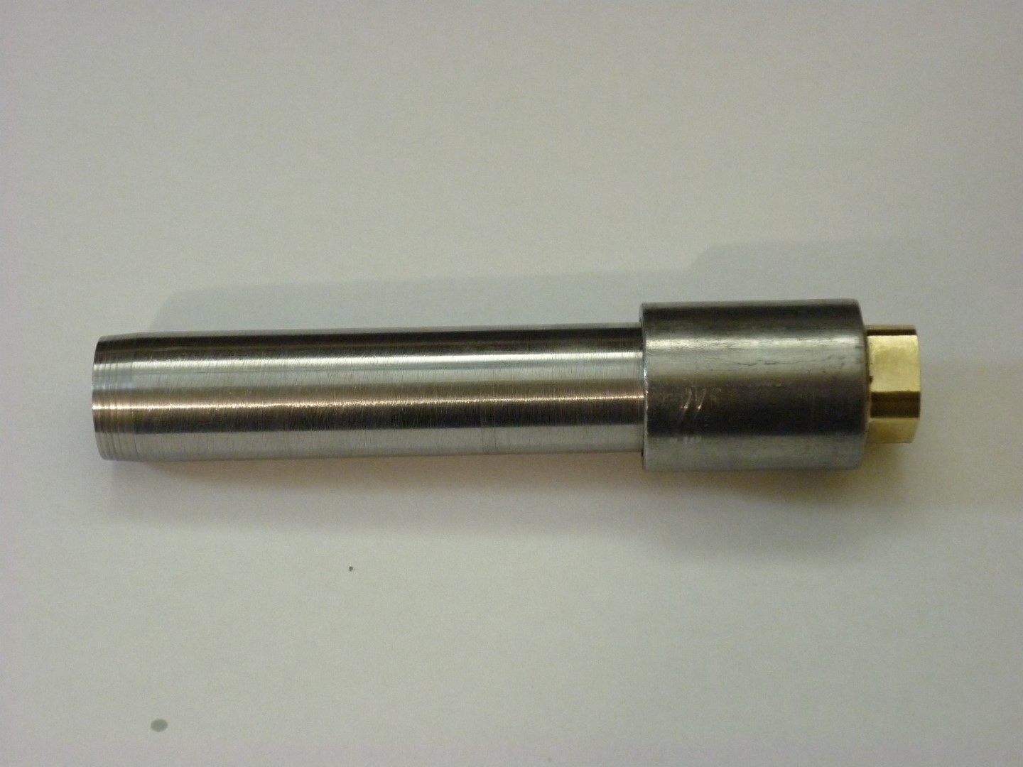

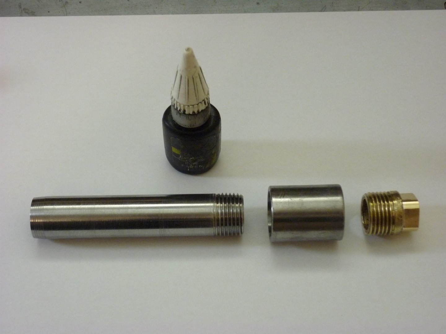

    In the original design the barrel assembly has three parts, the barrel itself, a sleeve (milled square at one end, for attaching it to the arm) and a nut for securing the barrel with the sleeve in the arm. Since I hadn’t a milling machine (I still don’t have one) to make the sleeve from one piece of steel, I used two pipe fittings, a steel threaded connector and a brass pipe cap.
    Lathe spindle handle-p1010290-large-.jpg Lathe spindle handle-p1010292-large-.jpg
    I did a couple minor changes for securing the parts and some for the appearance of the tool; you will see these on the video.
    I use this tool almost in every project that I have for the lathe; however in order to have a more versatile tool, I made a bigger arm and changed the tightening bolt with a threaded shaft that has a knob.
    Lathe spindle handle-p1140159-large-.jpg Lathe spindle handle-p1140160-large-.jpg Lathe spindle handle-p1140161-large-.jpg
    All the best
    Dimitris

    Nice and well done. Yes a crank can be very useful on the lathe

    Thanks Christophe! Allow me to say that the hand crank is a 'must to have tool' for all of us we have a mini lathe.
    Regards from Greece
    Dimitris

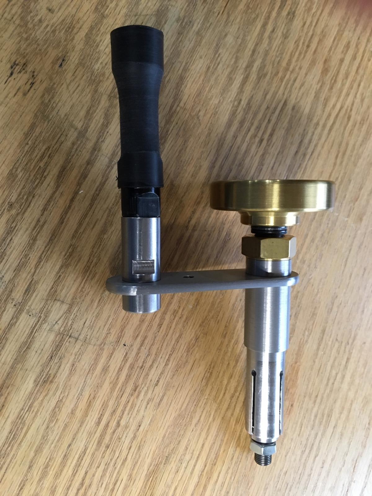

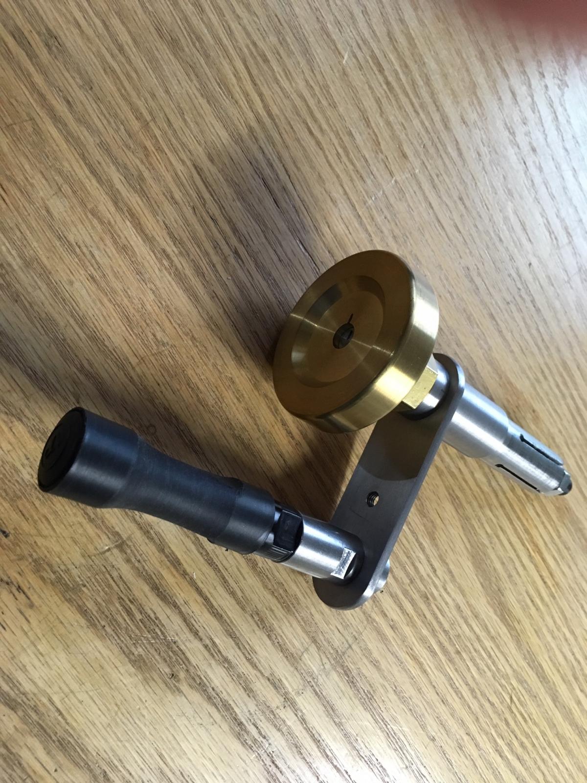

    I also made one similar to the Ralph Patterson version but he handle on mine came from an old bicycle crank and rotates on ball bearings. It is quite easy to turn.

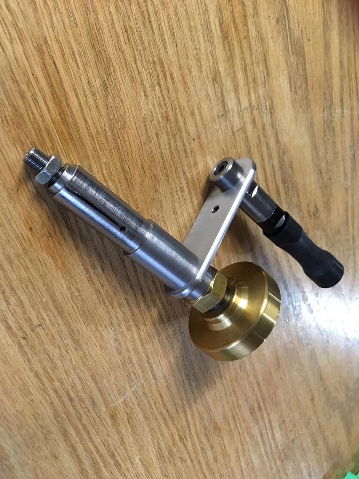

    Dimitris Polychronis,
    Here are some pictures of my mini-lathe hand crank. Like I said before it is based upon Ralph Patterson's design. The only part of the bicycle crank I utilized is the pedal shaft and bearing parts. I turned the plastic pedal shaft down to fit my hand. It works well and carries out it's intended function. With it I have parted off 2" diameter 303 stainless with no trouble. like Ralph's design it also functions as a spindle lock.
    Dick

    It’s an awesome crank Dick, thanks for the pictures!! I really like the brass knob, its big enough to have good grip in the hand.
    Unfortunately, the design of my lathe's gear train doesn't allow using the crank for locking the spindle. Thanks again for the pictures!
