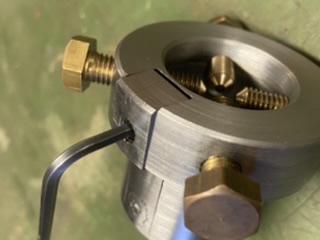

    Hi All
    I have finally got around to making a lathe spider, rather than using rags or pieces of wood jammed into the back of the headstock spindle to stop long pieces of material flailing around.
    I wanted it to be quick and easy to install and remove. So based the locking method on my lathe spindle backstop. Link to backstop:Quick to load and set lathe spindle back stop.
    Both the main body and the locking wedge are made from mild steel off cuts held with a M6 countersunk screw loctite in position. To jack the wedge a M6 grub screw is used. To ensure a good slide fit in the spindle, both pieces are machined together.
    The spider is fitted with 4 standard M8 brass screws turned down to 45 degrees at the end to enable small diameters to be supported.
    I wish I had made one years ago but it is one of those jobs that you will one day get around to. But now I have it there is no more making do with rags and wood etc that you never know if they are going to stay in place.
    The following photos show some of the spider being made and in the headstock spindle:

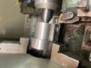

    both body and wedge being machined together.

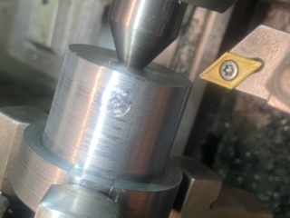

    machined to diameter

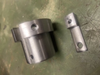

    Taken apart to clarify design.
    Grub screw used to expand wedge.

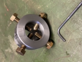

    Finished ready to install.

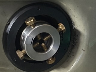

    Fitted to head stock spindle

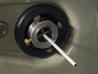

    Supporting 1/4 diameter aluminium tube

    Nice job, indeed. I particularly like the wedge design. I'm going to add that one to my 'appropriated ideas' file.
    And, of course, you realize that you've now made yourself a chuck depth stop. A simple rod will suffice but you can titivate it by drilling and threading the chuck end of the rod so that smaller diameter inserts can be used when the work diameter is less than the rod diameter. (If I were doing it I'd make the rod about 3/8" diameter.)

    great idea, and the wedge system is quite clever. I can see a few other applications of this with only a few minor modifications (eg slip fitted plug held in place with the same brass screws - said plug supporting a chuck/ stock back stop), holding a magnet for tacho, etc
