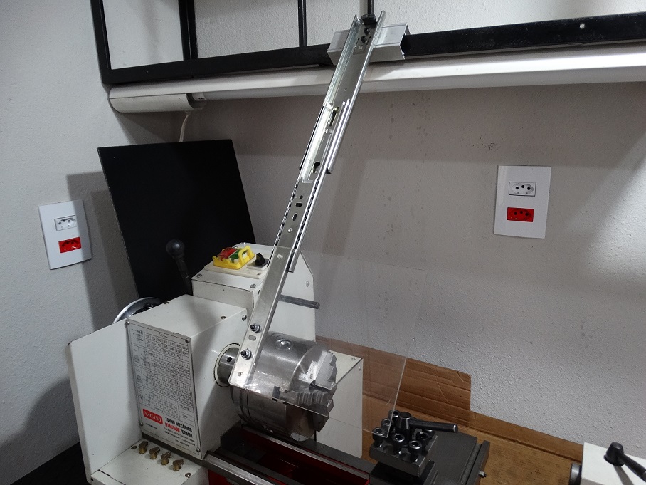

    Ralphxyz, position the acrylic guard with the rail fully open. Change the position as needed. After use, just close, there's no secret, that's all!

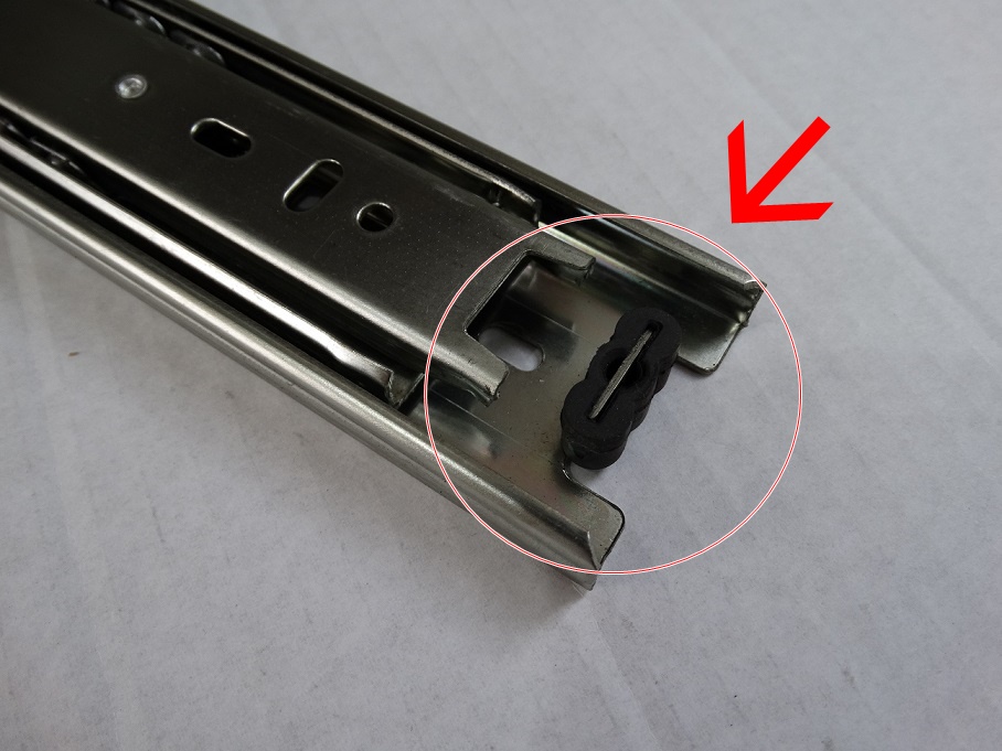

    The working position of the rail is "fully open", it just works like this! The mechanism is so simple that it is ridiculous! Do not remove the locking rubber from the rail, this is how it stays closed and locked!
