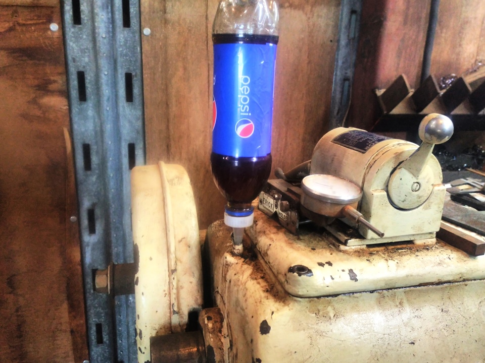

    Old lathes have old ways of being oiled.
    Every morning the first thing I do is to dribble a little oil on the spindle bearings before start up This insures the bearings do not start up dry. Once the lathe has ran for a few minutes the oil will be transported up from the sump by the gears then along the shaft to the bearings.
    Oiling this thing with a plews oiler is how I've done it for years.
    I came up with the idea of how to oil it a little faster than with the pump pump pump of the handle of the Plews oiler.
    What I did was to take a Pepsi bottle fill it with oil than screw on a cap from a Lucas hub oil bottle push the tip into the oil cup and give the bottle a little squeeze job done move on to the next one

    Almost makes sense! Now why didn't you think about this 40 years ago?

    I wood squeze it and...the cap would pop off or split and the lube wood bee all over mee....Ill stick to my leekey oil cans...but I do like your idea.
