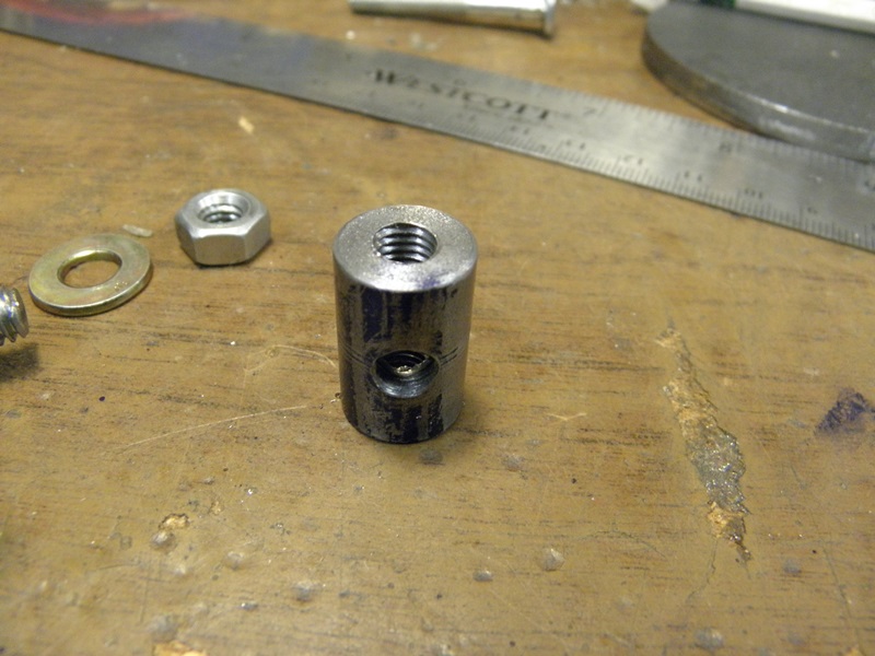

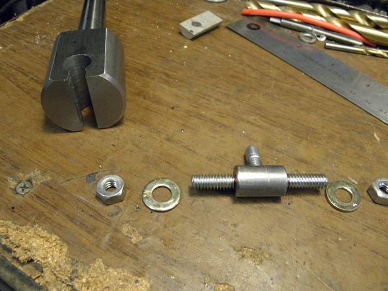

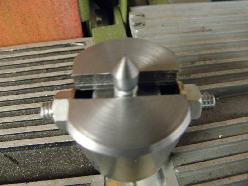

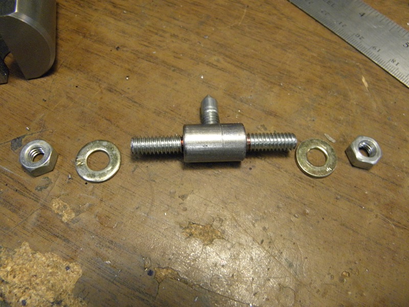

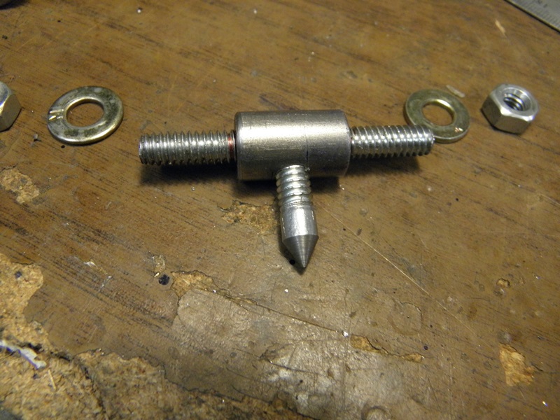

    I will have to make a ball head for his one THANKS for all your input..... :O) Cap.
    Lathe offset tail stock uncenter.-tills-006.jpgLathe offset tail stock uncenter.-tills-008.jpgLathe offset tail stock uncenter.-tills-009.jpgLathe offset tail stock uncenter.-tills-010.jpgLathe offset tail stock uncenter.-tills-007.jpg

    Quite good Captainleeward, replaceable center to boot!
    Offset centers [commercial] I've seen only offer .000 to .025 offset, and they are carbide tipped dead centers. The point carrier sits in a bore, offset from Morse Taper body and clamps in place. Then orientation has to be set horizontal across the ways, it was tedious. Perhaps unintended benefit to correct misaligned center heights, which it could accomplish, IMHO and visualization.
    MKlotz's boring tool [post #9, this thread] idea is good too, not applicable to scale of my work, but offers precise adjustment. And center points would be easy to produce and mount.
