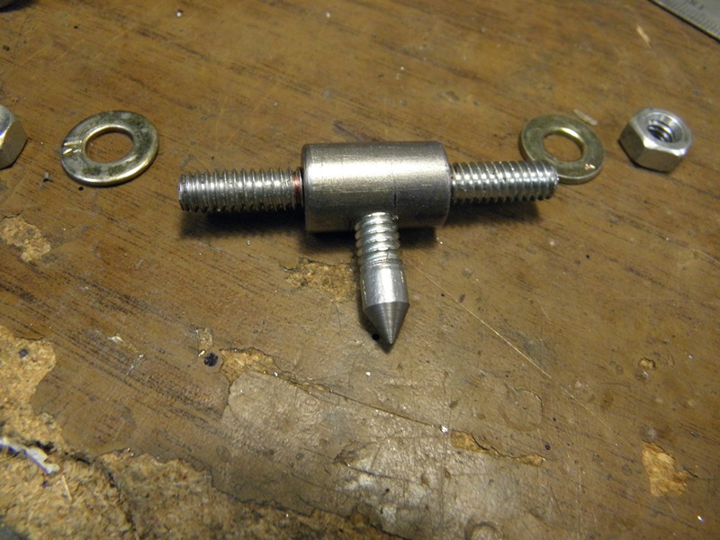

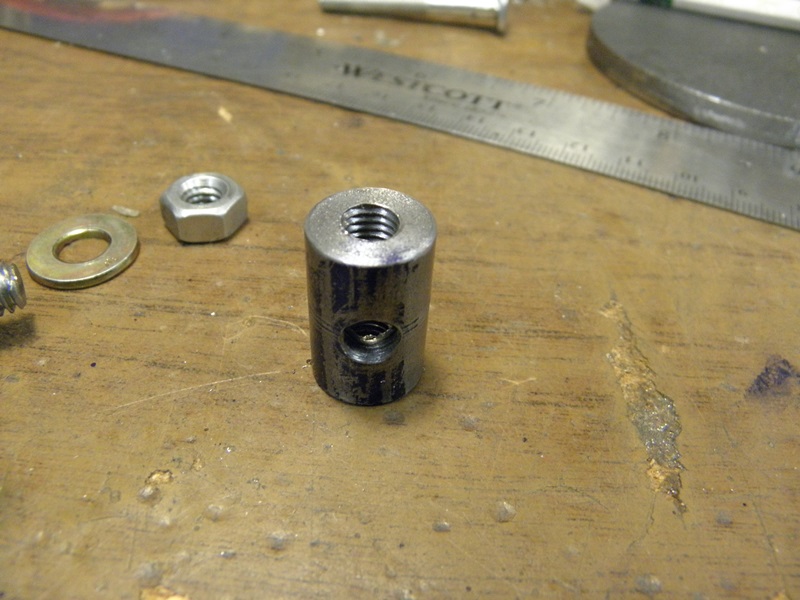

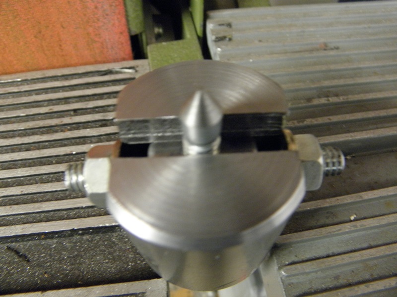

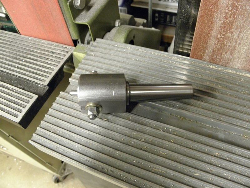

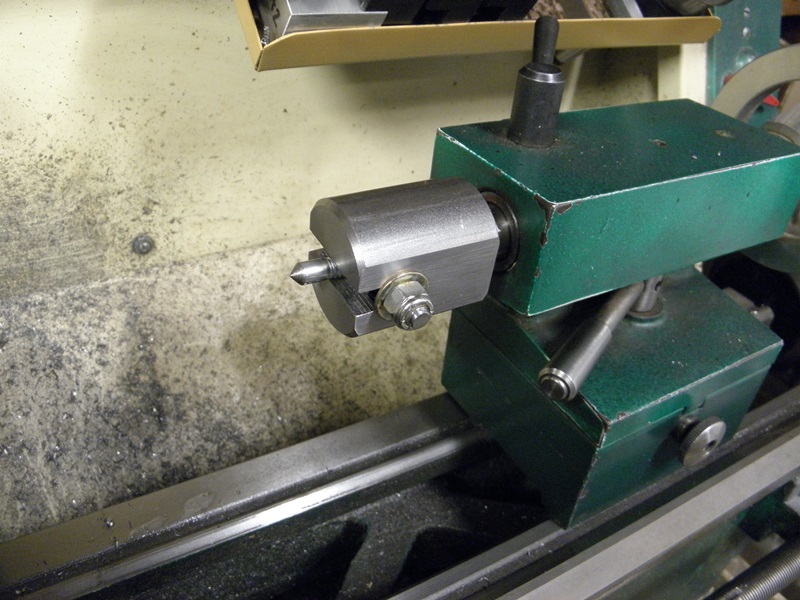

Excellent Cap'n. I'll wager side flats are part of orienting the offset feature?
There have been commercial offset centers over the years, some were high priced, though never seemed to take hold. That always puzzled me.
Dedicated MT#2 is more than just a timesaver in setup and/or return to zero. Having consistency rules even higher.
HI Cap, I couldn't tell for sure but your uncenter looks to be a dead as opposed to a live uncenter. I haven't thought of making one for my lathes since I rarely have a need for turning a long taper any more. I used to have a large one that fit my old Turret lathe years ago but I was making API and tapered Buttress threaded nipples I also had a constant velocity articulating internal chuck that I made from the steering knuckle of an old military 5 ton
I like you's in its simplistic design
Hi Cap, I like your uncenter and the name is descriptive.
I am also reluctant to disturb a nicely set up tailstock, this would save a lot of time and frustration.
As a point of interest I have understood that to get the best result from offset centers they should be ball ended and not coned, or a female centre with a ball bearing in between, any thoughts anyone.

Captainleewards' offset center would attract attention here, due lathe size many have and desire to utilize Morse Tapers in shopmade tooling. Biggest plus, you can compensate and preserve the setting exactly to [U]your[U] Morse socket. That fits in with Olderdans' observation and my suggestions to follow...Most of my taper work been hubs, spindles, pipe threads, and a few mandrels.
Captainleewards thread and responding posts address both taper turning and correction of taper, as there are reasons for both.

Another approach is to simply mount the boring head in the tailstock and insert a homemade center (ball or cone) in place of the boring bar.
It seemed to work fine for the (admittedly limited) occasions I've tried it.
