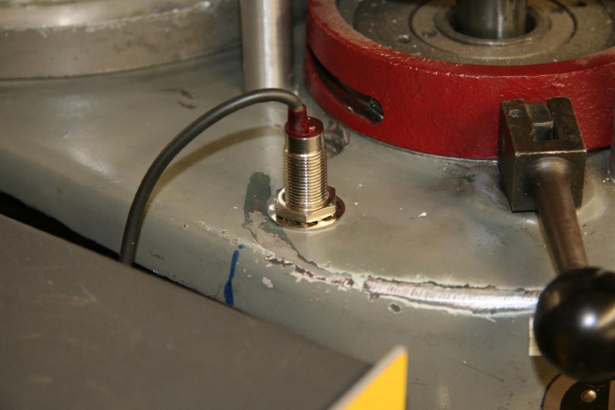

    Hall Effect Tachometer mounted one on the Lathe and one on the Mill.

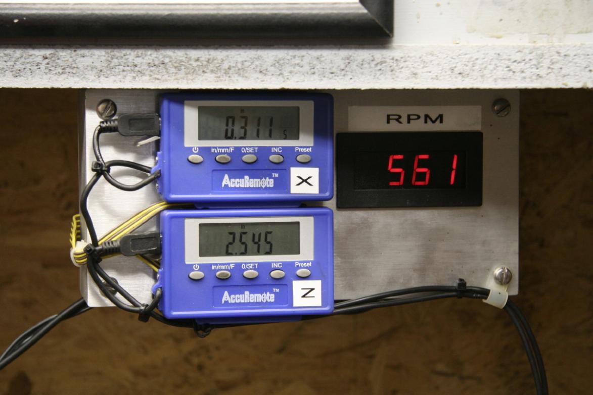

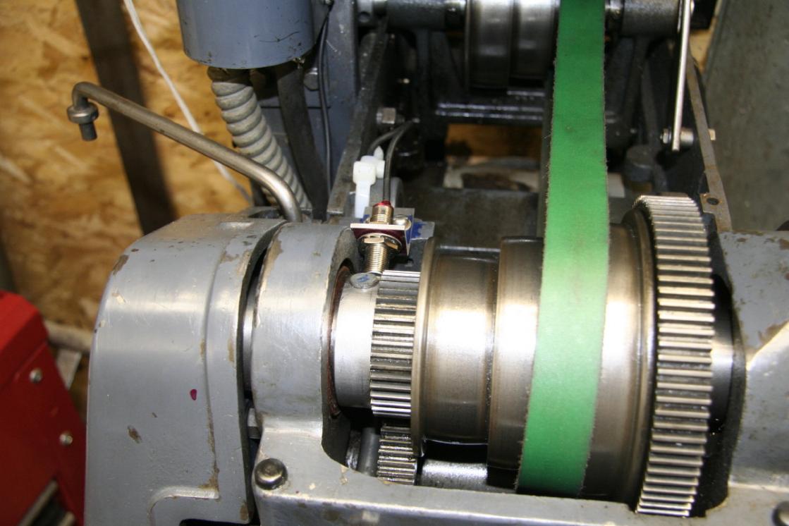

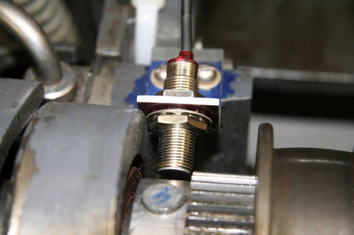

    Lathe Setup with my DRO.Lathe & Mill Tacometer-_mg_1558_1.jpgLathe & Mill Tacometer-_mg_1565_1.jpgLathe & Mill Tacometer-_mg_1566_1.jpg

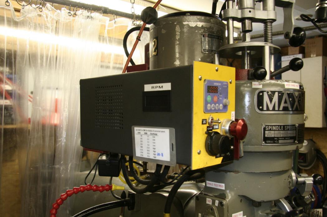

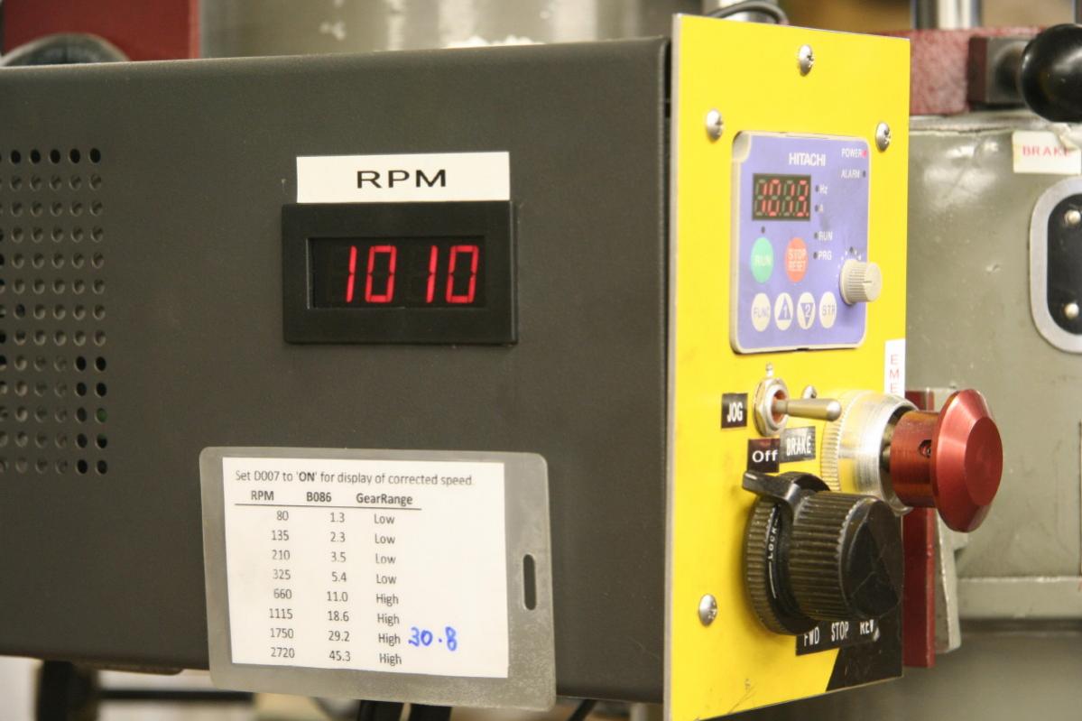

    Mill Setup. I mounted the readout in the same enclosure as my VFD. The Sensor is mounted thru the top of the Belt housing and the magnet is glued to the top of the belt pulley. Direct readout for all high speed operations and calculated for all Back Gear operations. The enclosure was reclaimed from a toasted UPS unit. Lathe & Mill Tacometer-_mg_1561_1.jpgLathe & Mill Tacometer-_mg_1564_1.jpgLathe & Mill Tacometer-_mg_1571_1.jpg

    I have one similar to that on my variable speed Rockwell drill press. I put a magnet on the outside of my rockwell lathe where the collet closer would mount and it doesn't give me a reading I take the same parts and they work on the drill press. I tried manually holding the pu end and nothing on the lathe manually holding on the drill press it works. the metal piece on the lathe is about 2 1/4 in in dia. and the one on the drill press is about 1 in. I can't figure out why it is not working on the lathe. the variable speed lathe is where I really wanted to use it.

    I found that it mattered which magnet face was towards the sensor. I also think that they work better if the magnet is mounted on ferrous metal.
