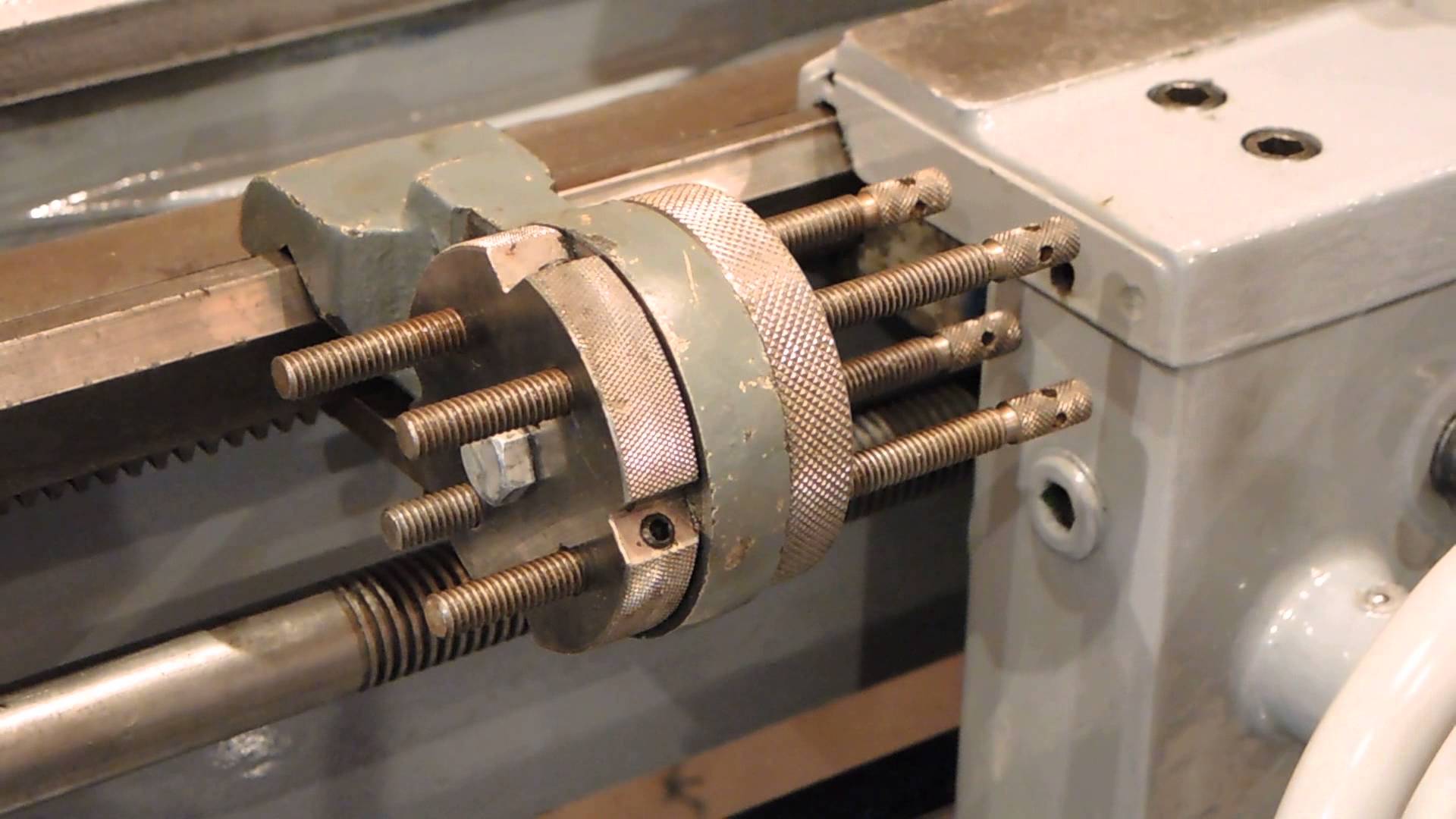

    Here is a similar stop that I used to have it came on a lathe I once owned
Name:	carriage stop maxresdefault.jpg
    I have seen them before but have not made one yet. Big advantage I see is actually two fold.
    One is you have a lot of positions instead of only two. The other is the tail stock is not hindered by the
    outboard carriage stop.
    Thanks for posting that one Frank.
    Cheers, JR
