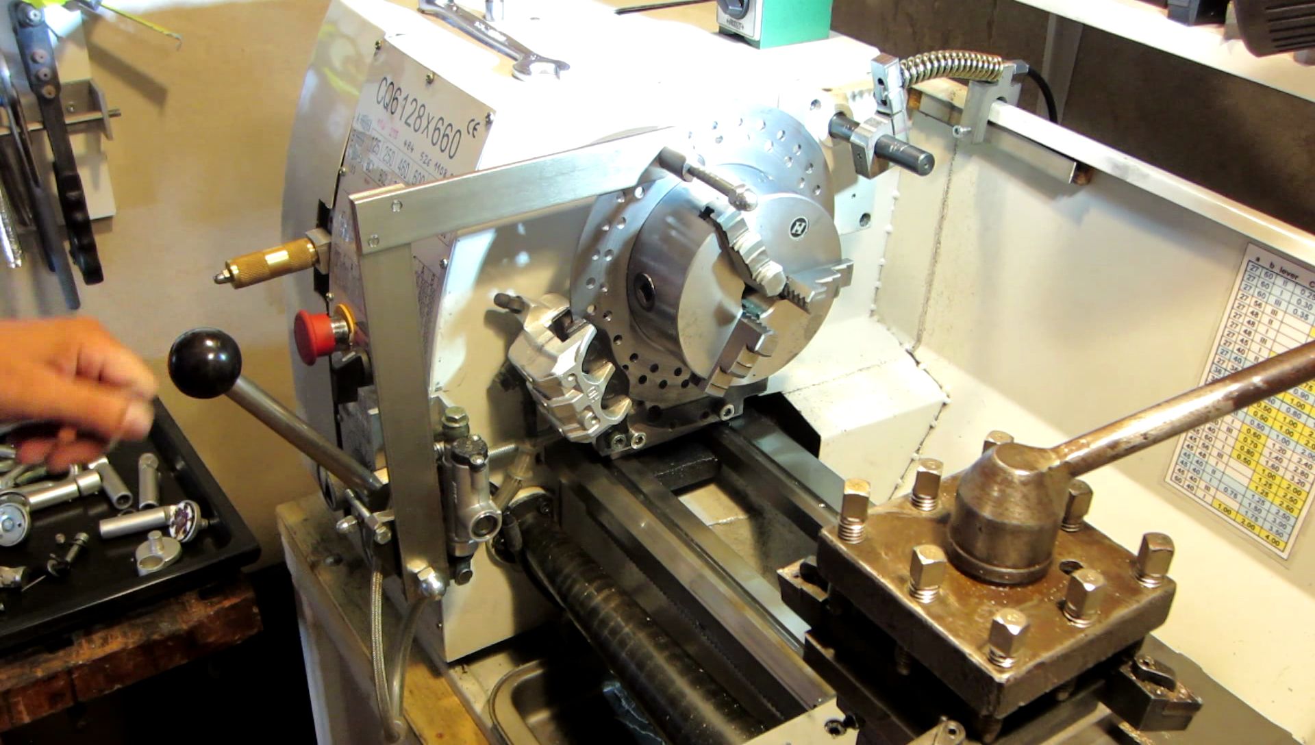

    Hi guys,
    This is just addition to lathe chuck brake, but both combined make perfect tool.
    Consists of the following parts:
    - Lathe Chuck Brake (already described)
    - Indexing disc
    - Bar
    - Indexing pin
    - Locking piece

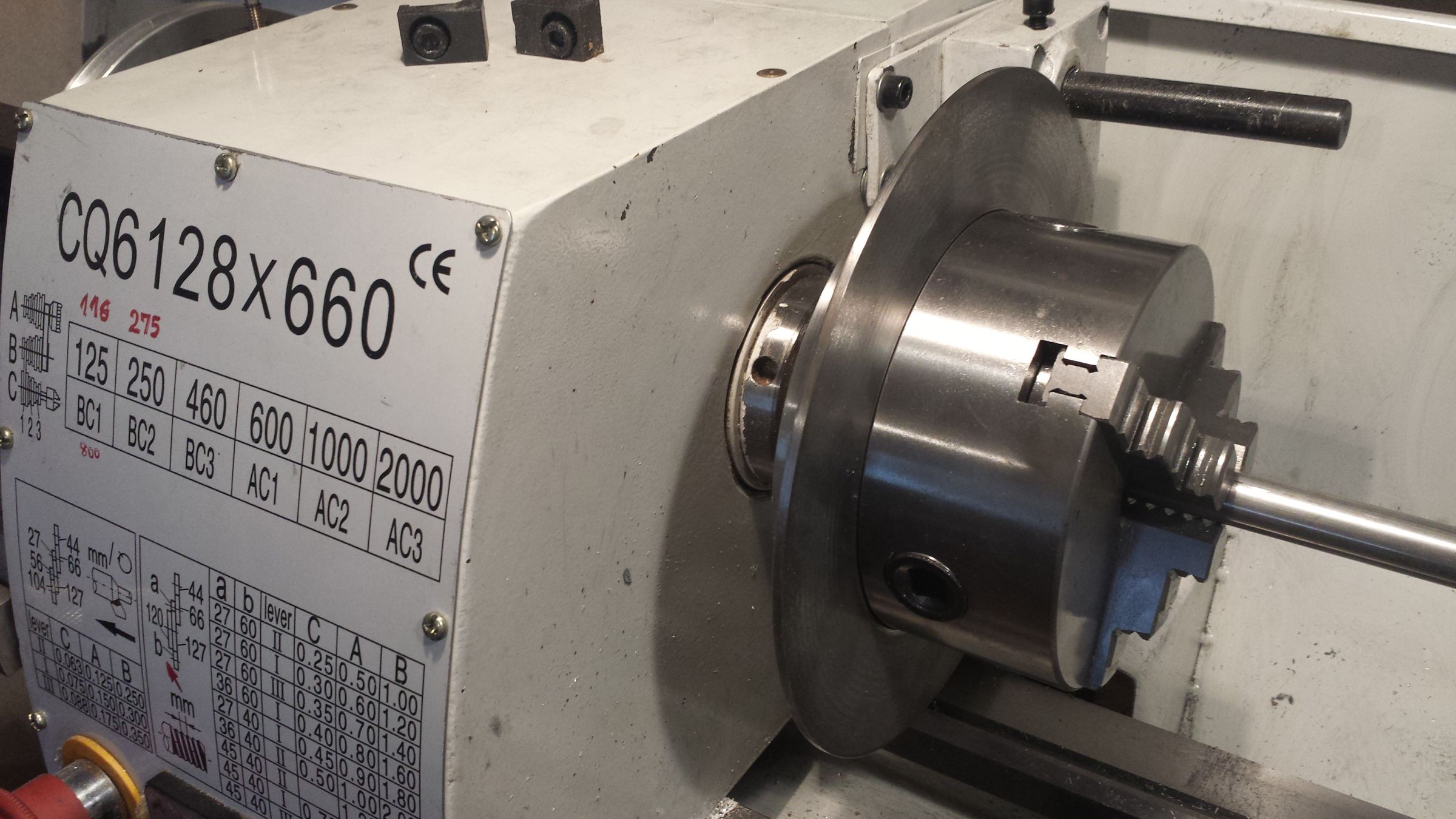

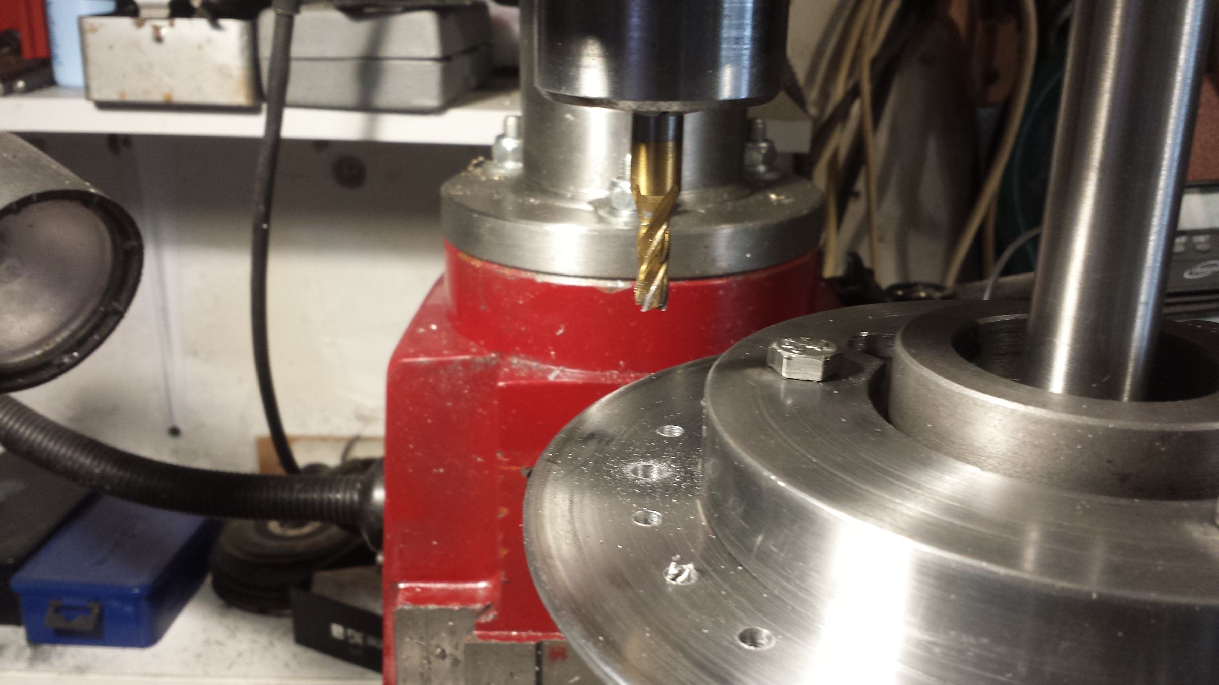

    Indexing Disc
    It is actually brake / indexing disc as it has 2 purposes.

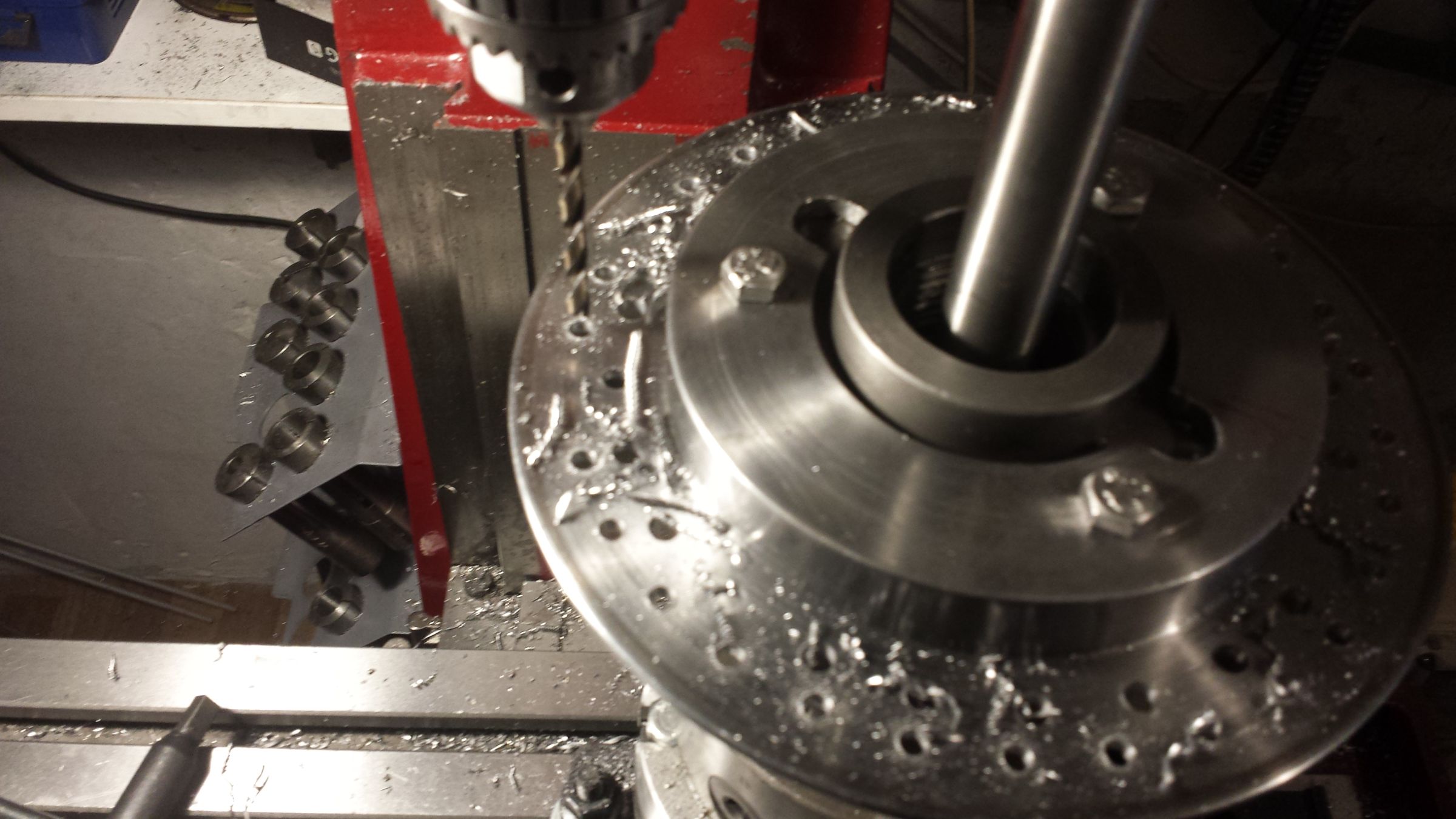

    Making of that disc is described in my post 'Lathe Chuck Brake' and drilling
    of the holes on it was done as follows:

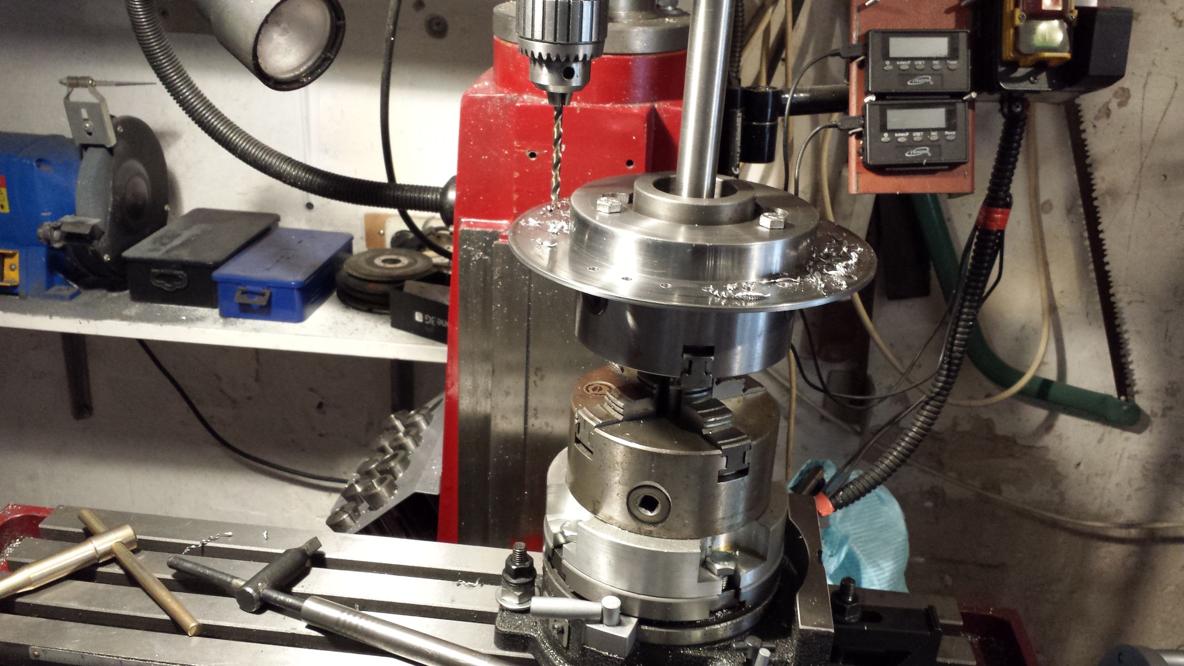

    1. Brake / Indexing disc was mounted onto lathe chuck with three 8mm bolts.
    2. 5" four jaws scroll chuck was mounted onto 6" rotary table. TIR 1/100 mm.
    3. Both chucks were connected with perfectly straight 22 mm s.steel round bar.
    TIR at lathe chuck = 2/100 mm, which is almost negligible for this project.
    4. First I drilled inner circle of holes (24 holes) with 15/64" drill and afterwards milled
    holes with 1/4" end mill. Then outer circle of holes (30 holes) was done the same way.
    With these 2 rows of holes I have the following divisions: 2, 3, 4, 5, 6, 8, 10, 12, 15, 24 and 30.

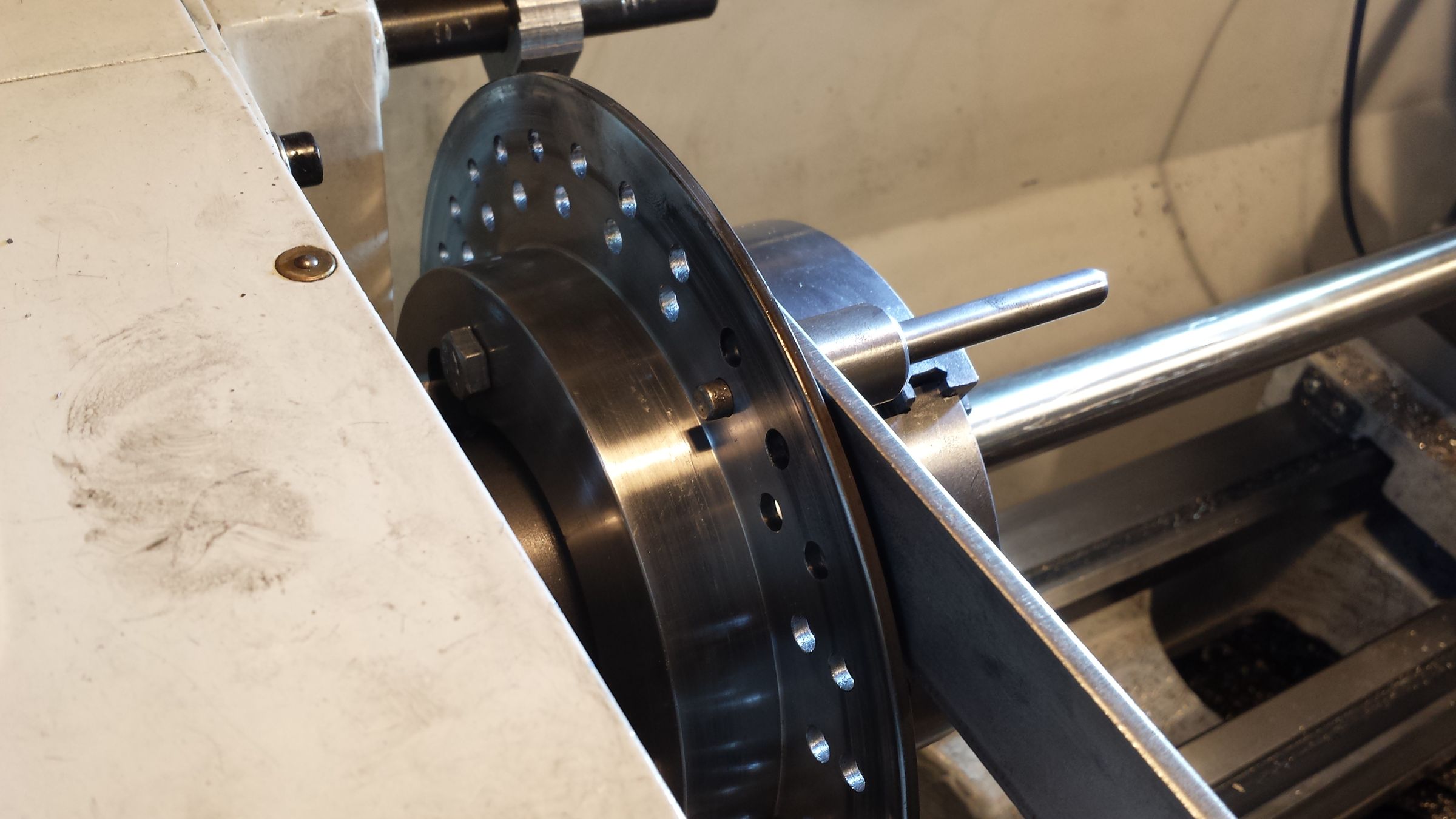

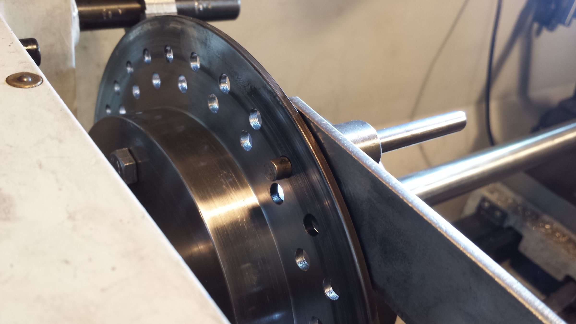

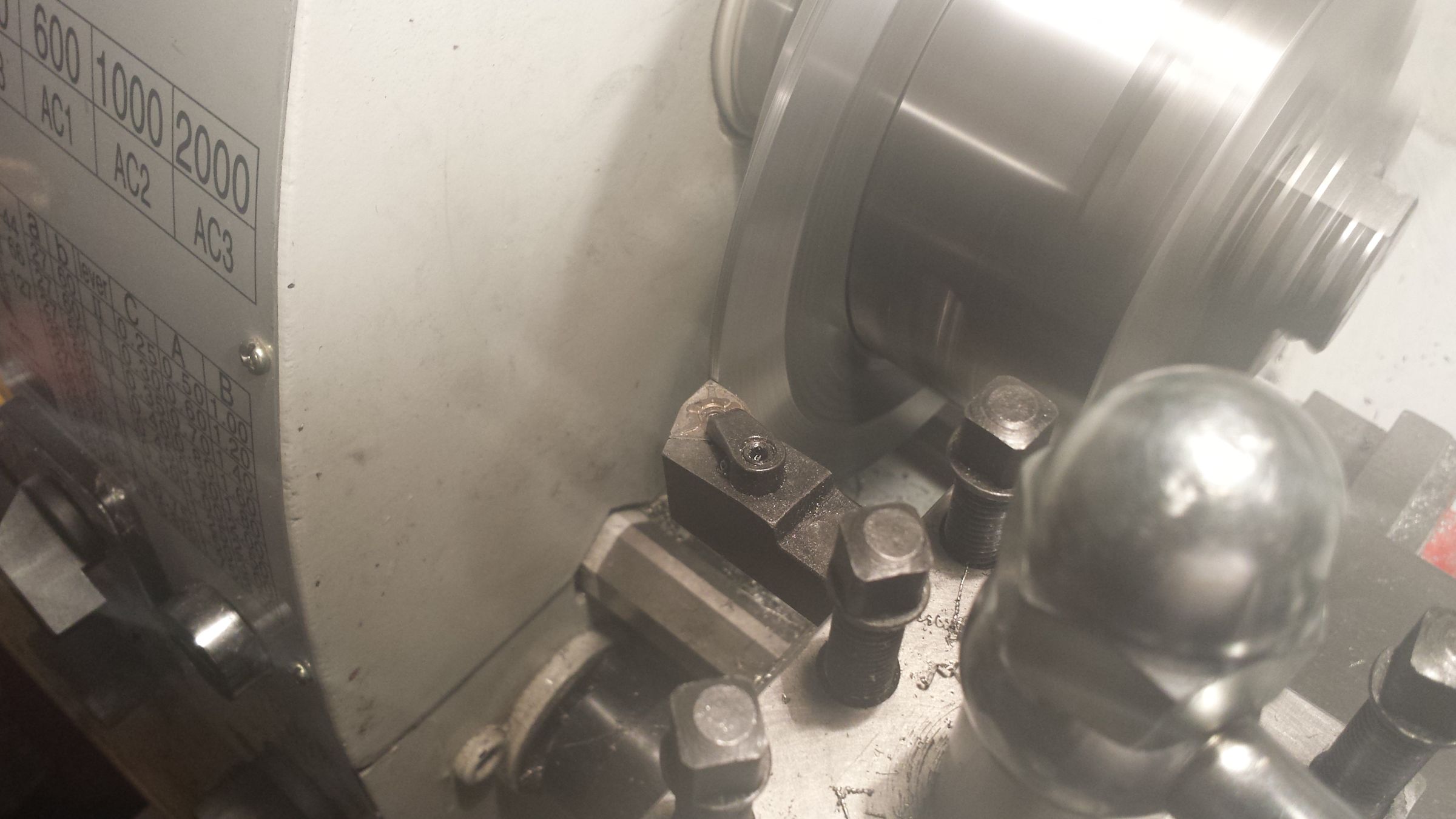

    Bar
    Made from 30 x 5mm stainless steel flat bar; two bars connected at 90 deg angle.
    Guider for indexing pin made from 15 mm s.s. round bar, drilled with 1/4",
    one end threaded with M12 thread and screwed onto flat bar.
    Indexing pin
    Made from S.S. 8mm round bar. Partly turned to 6.35 mm
    Locking Piece
    Made from steel 10mm bolt. Head of the bolt was milled in order to fit behind the brake block.
    And the most important for the end:
    Chuck brake keeps chuck fully locked in desired position.
