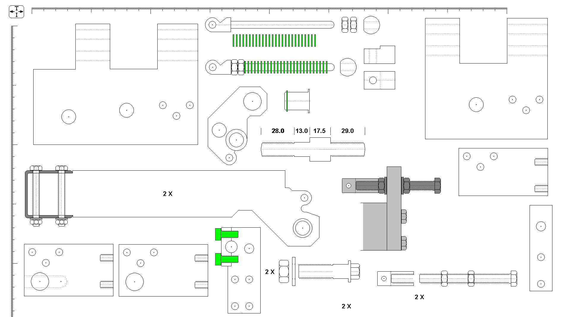

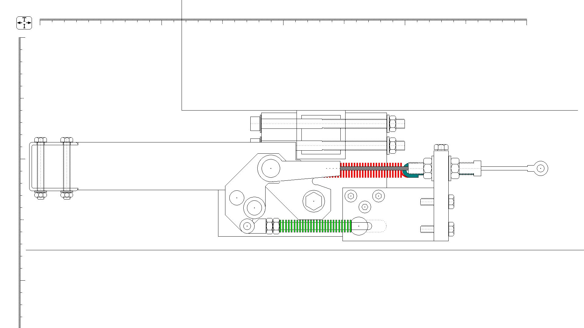

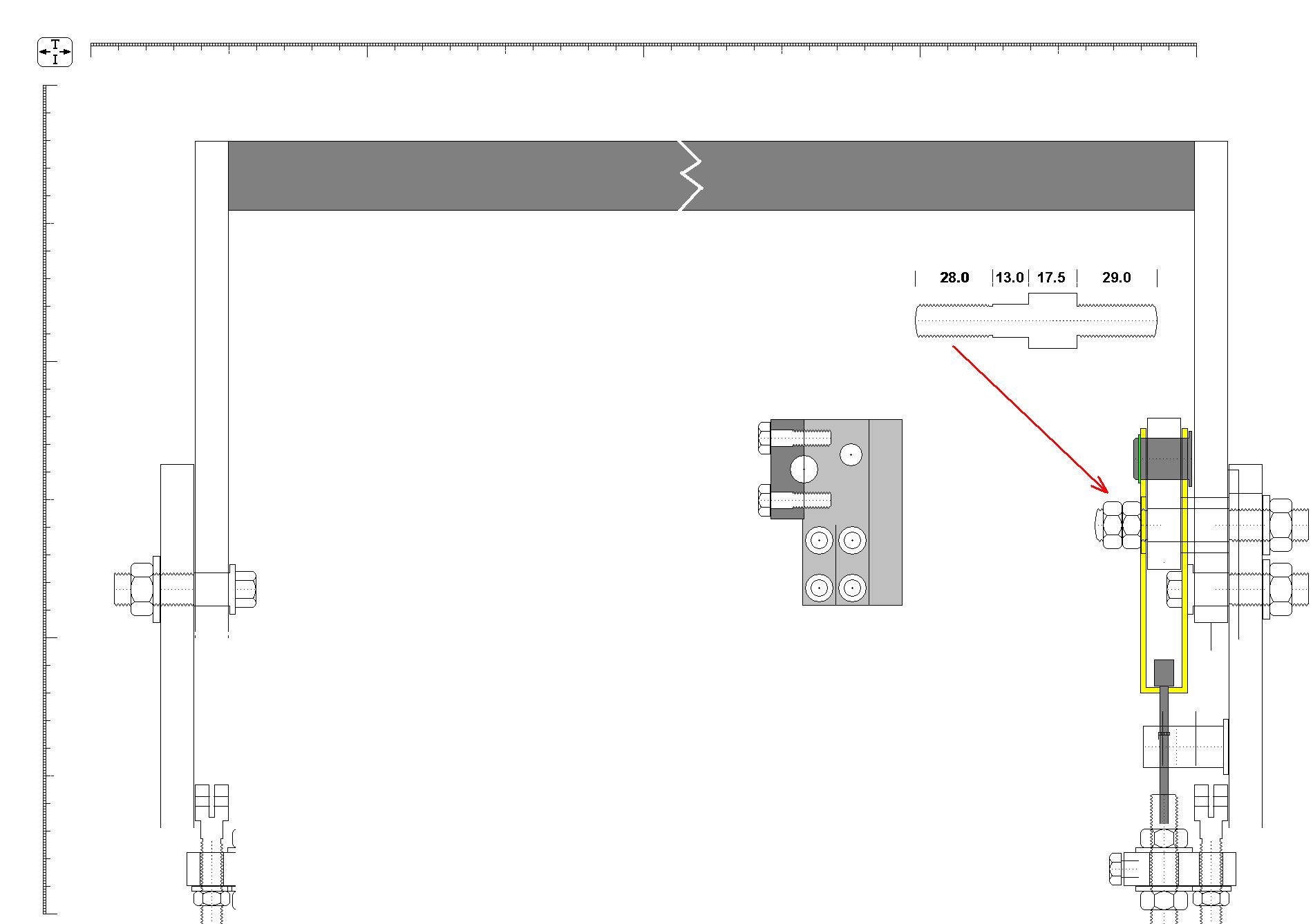

    Hi guys,
    Finally fabricated an addition to existing hand brake ( Lathe Chuck Brake ),
    so now I have both a hand brake and a foot brake. Both brakes can be operated independently of each other.
    Materials used:
    brake cable, dia 3mm, length 2.2 meters, price USD 4 in China
    steel flat bar (90 x 12 mm)
    316 ss square tube 40 x 40 x 2mm
    316 ss round bars, 12 and 18mm
    2 tension springs, 1 compression spring
    various bolts and nuts
    Few updated drawings:
    Cheers
    LMMasterMariner
