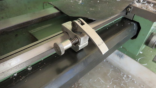

    The carriage stop itself doesn't matter. Do your own design. Which fit best for you.
    Big thing here is the closure system from a bicycle seatpost clamp.
    It is fast and convenient.
    Added a fine adjust bolt and it's a winner
    Attached Thumbnails Attached Thumbnails Lathe fast clamp Carriage stop-24566995253_1646842a17.jpg

    Fantastic idea ! Thx !

    That is a very cool design. Wow!

    Dang !! Now I gotta go and swipe a bike seat
