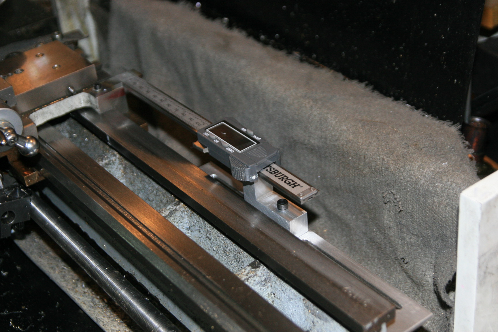

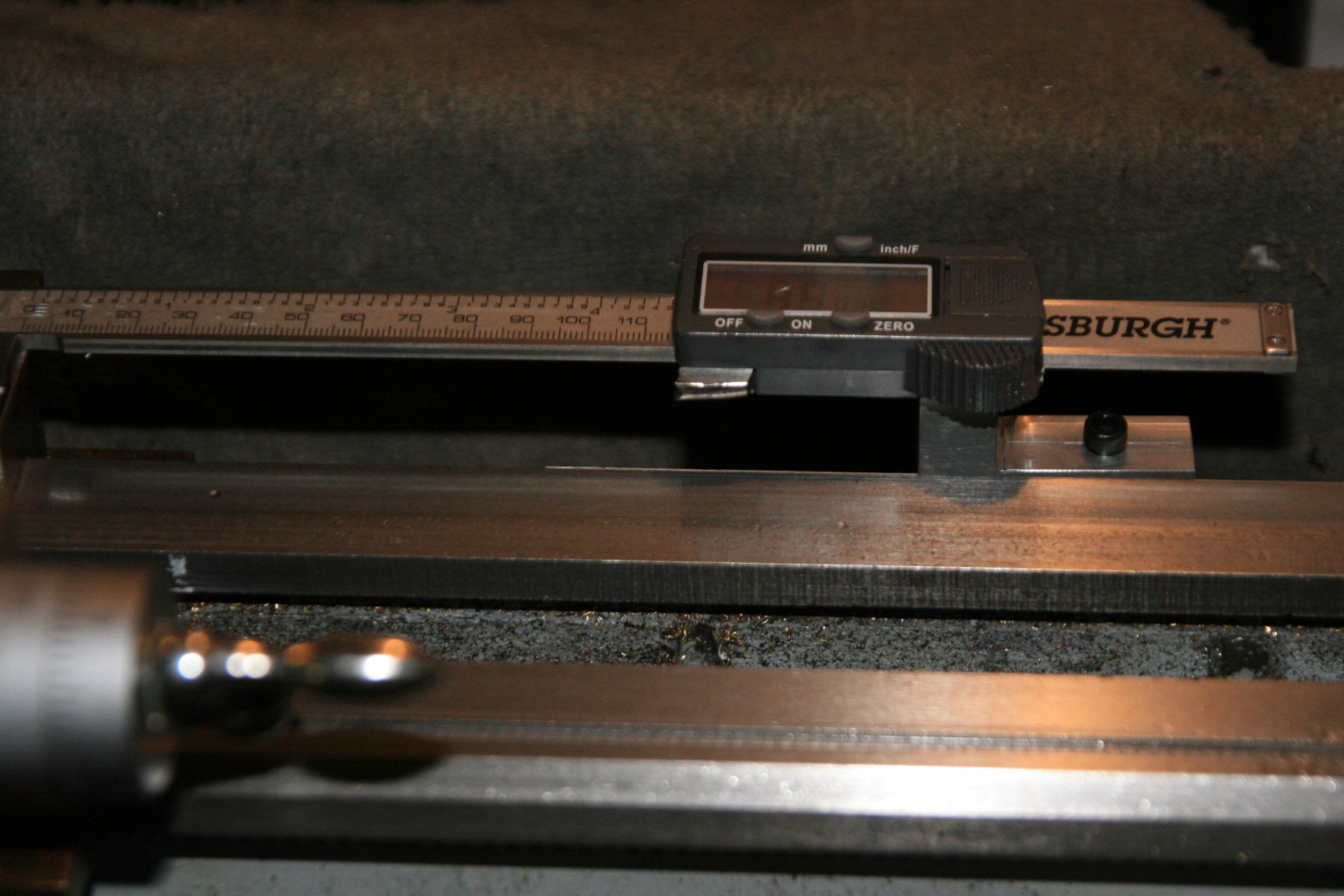

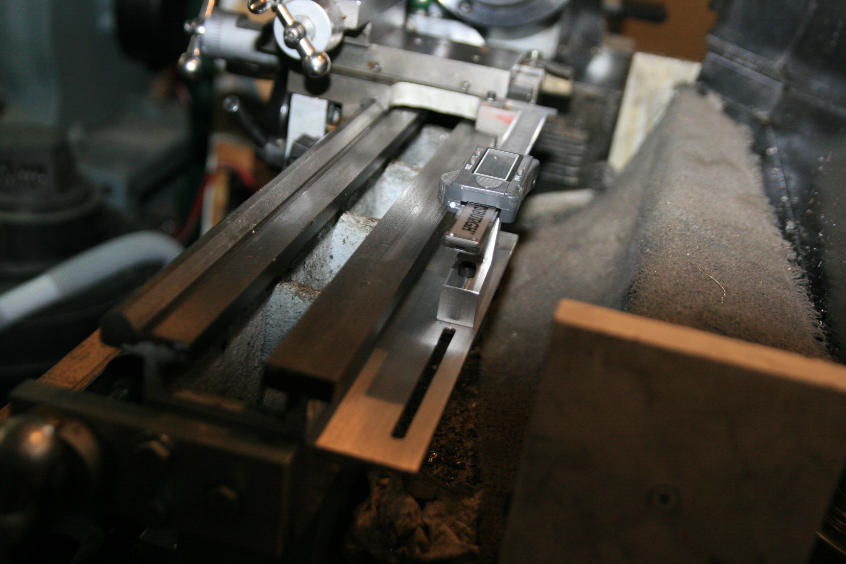

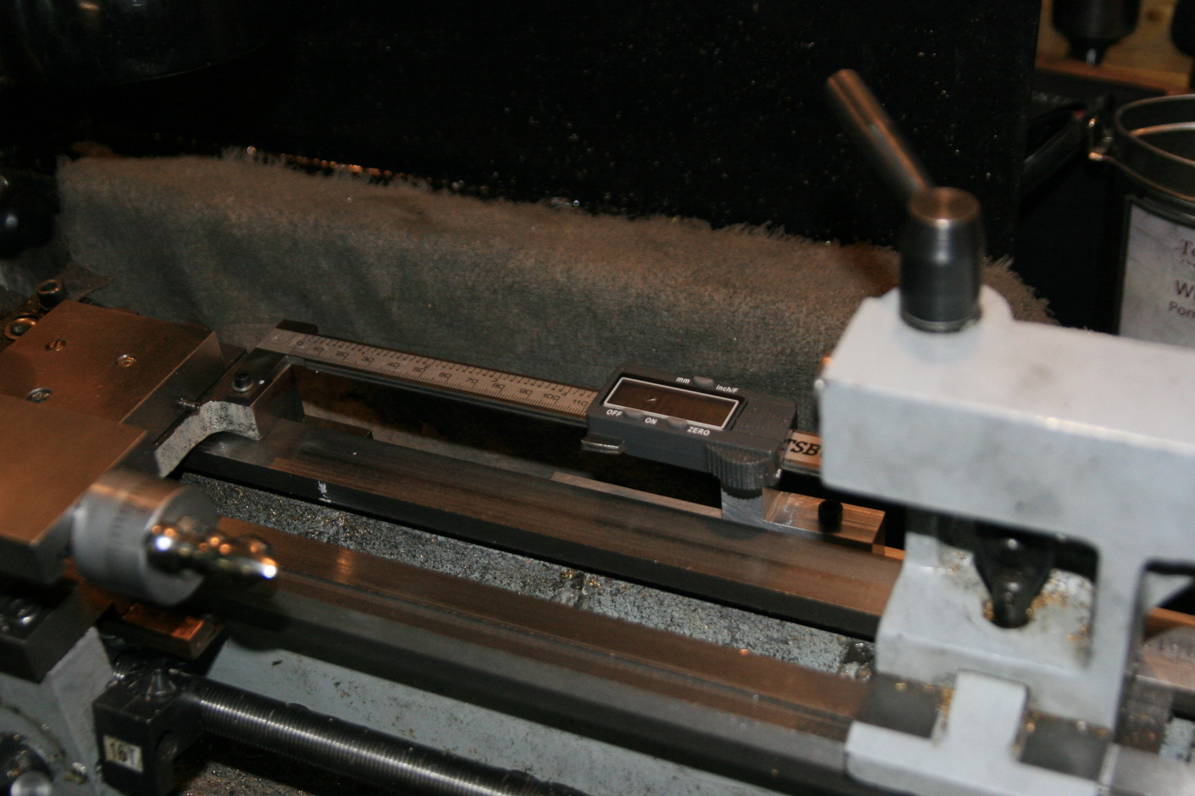

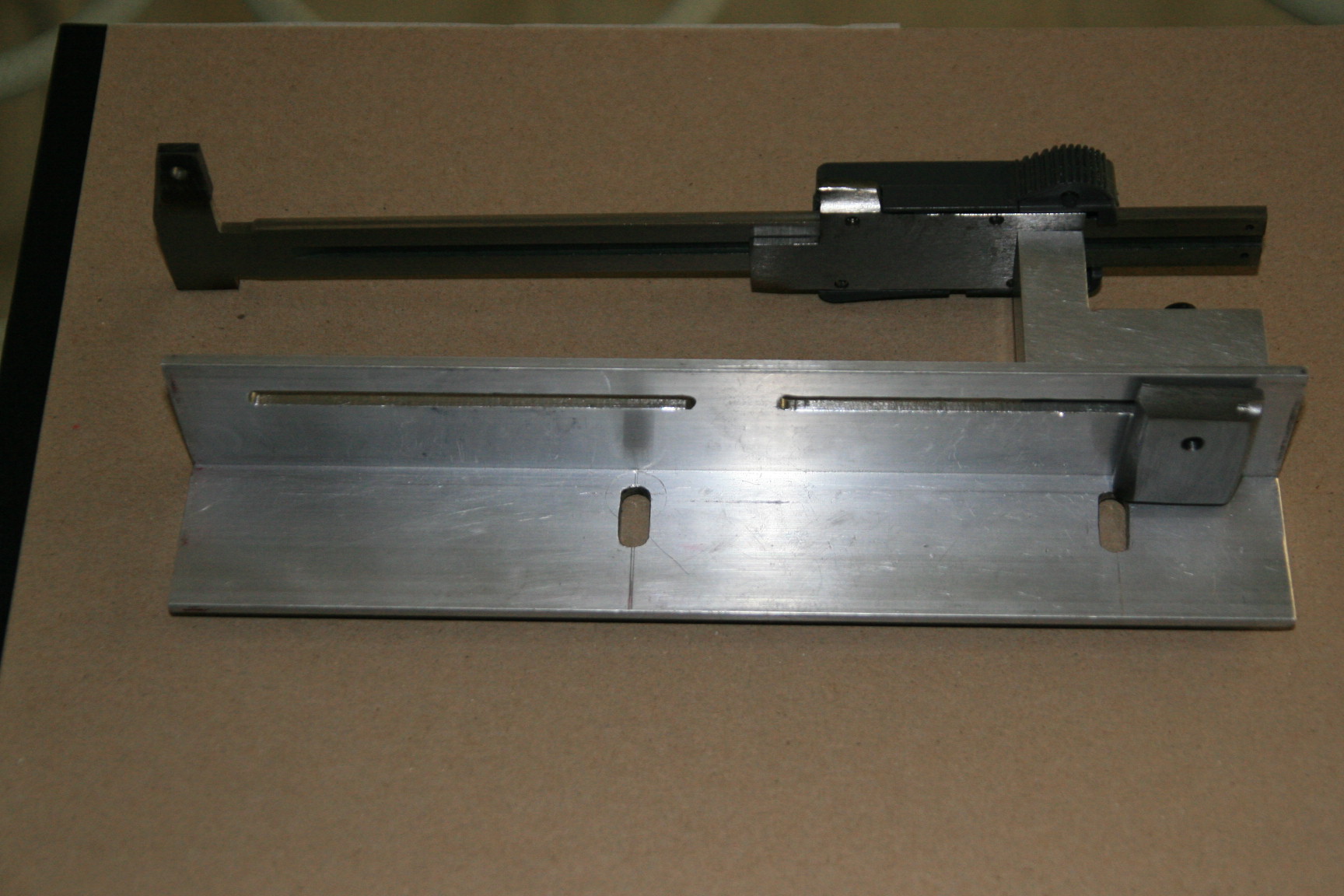

    I was in the process of completing my little steam/air engine and have quite a few
    small parts to turn. I had previously added a graduated dial and handle to my
    lead screw which works pretty good but it is much faster to use a DRO on the carriage.
    Not only faster but easier to set distances to be turned. It does not interfere with
    the threading dial or the tailstock. The only limitation is the 6" length of the caliper but
    the caliper may be placed wherever the 6" of travel is needed. Most of my parts
    are not 6" long.

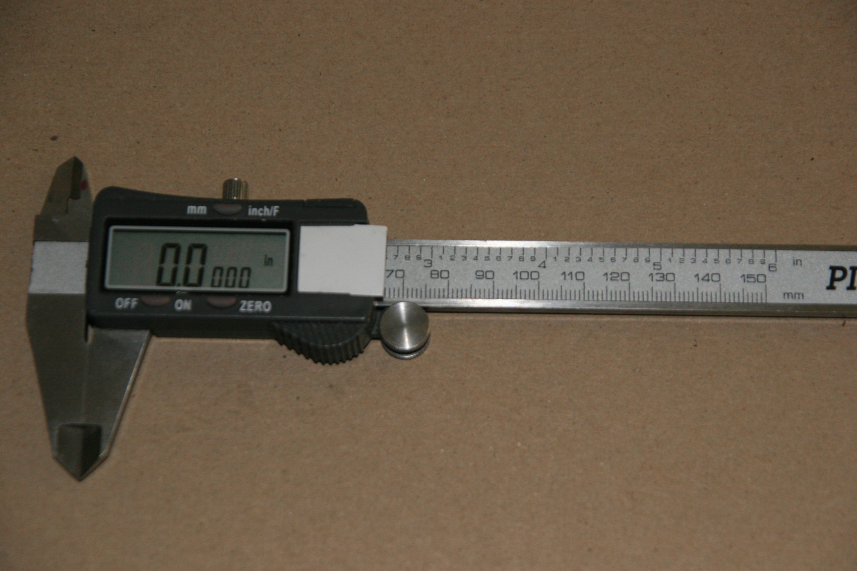

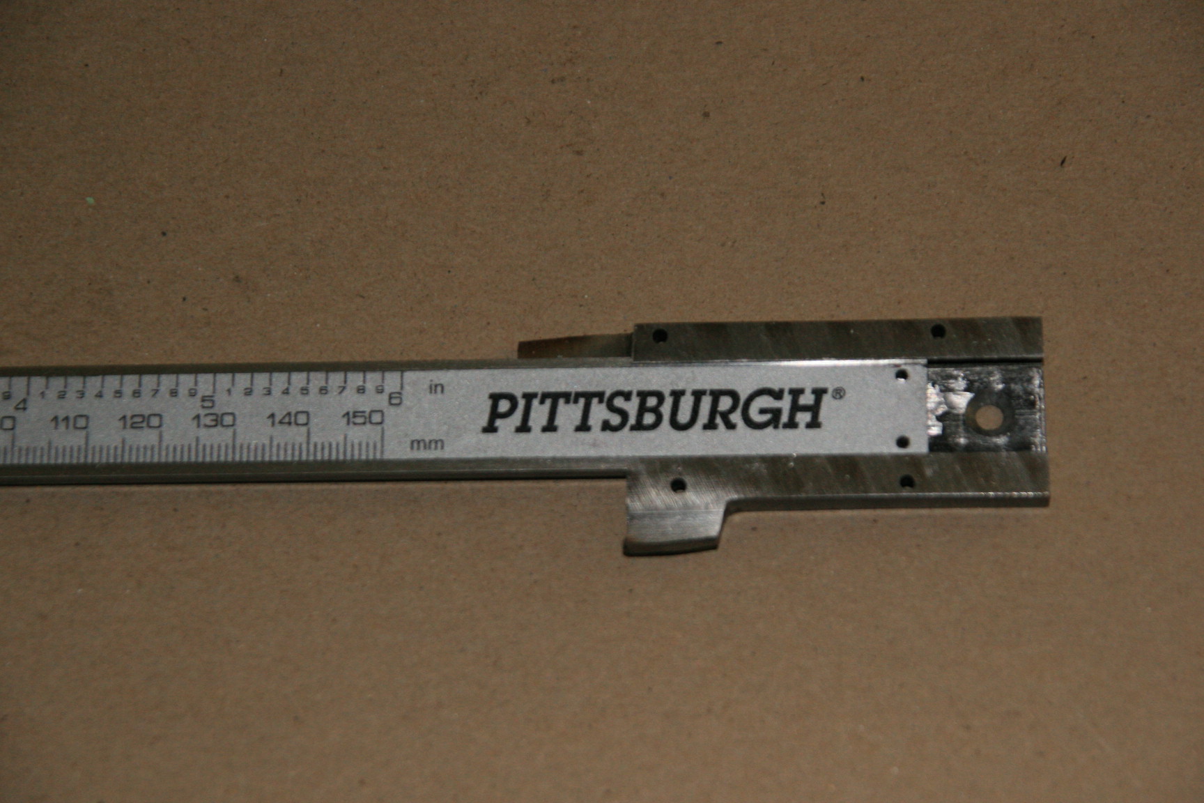

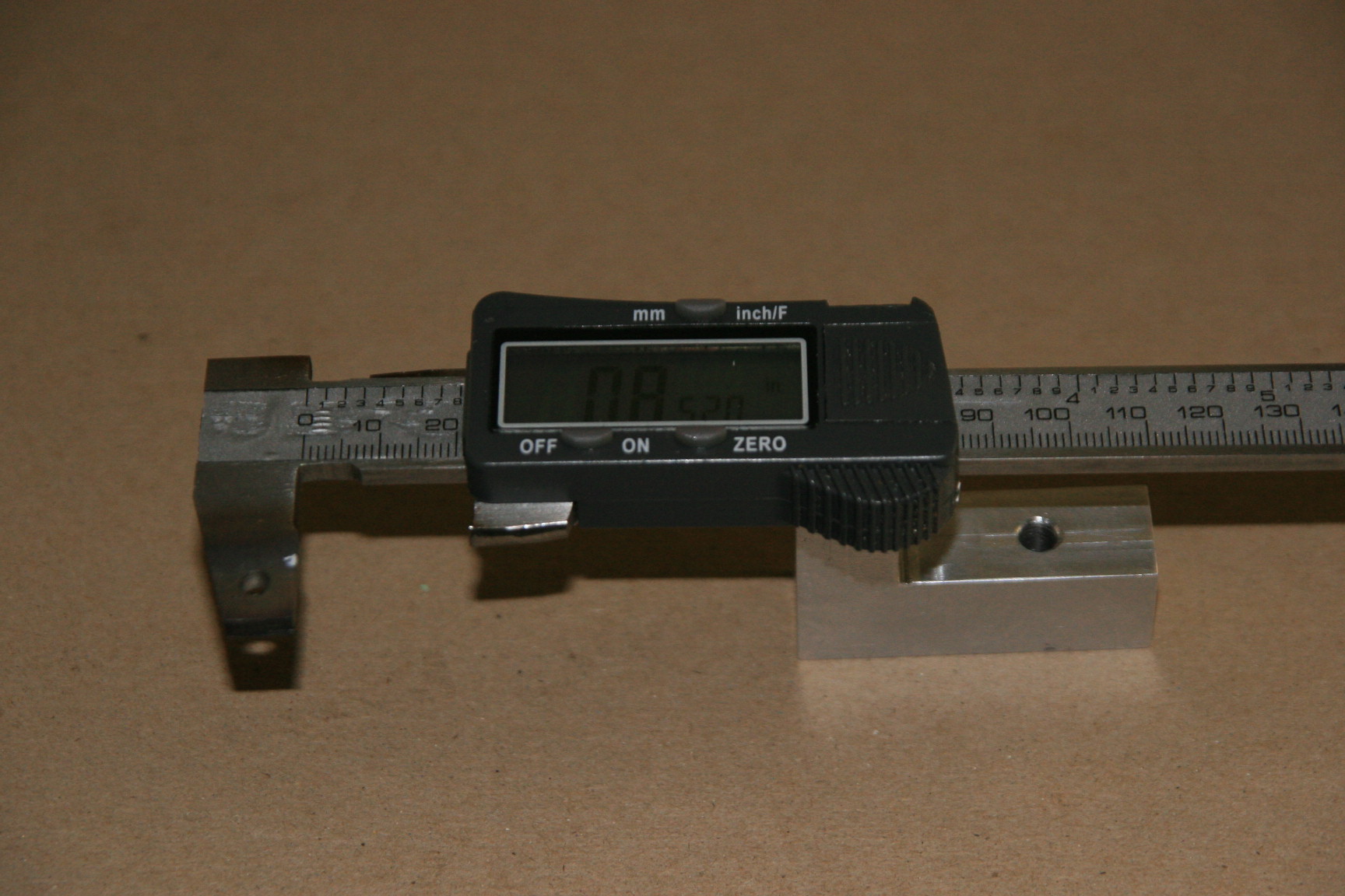

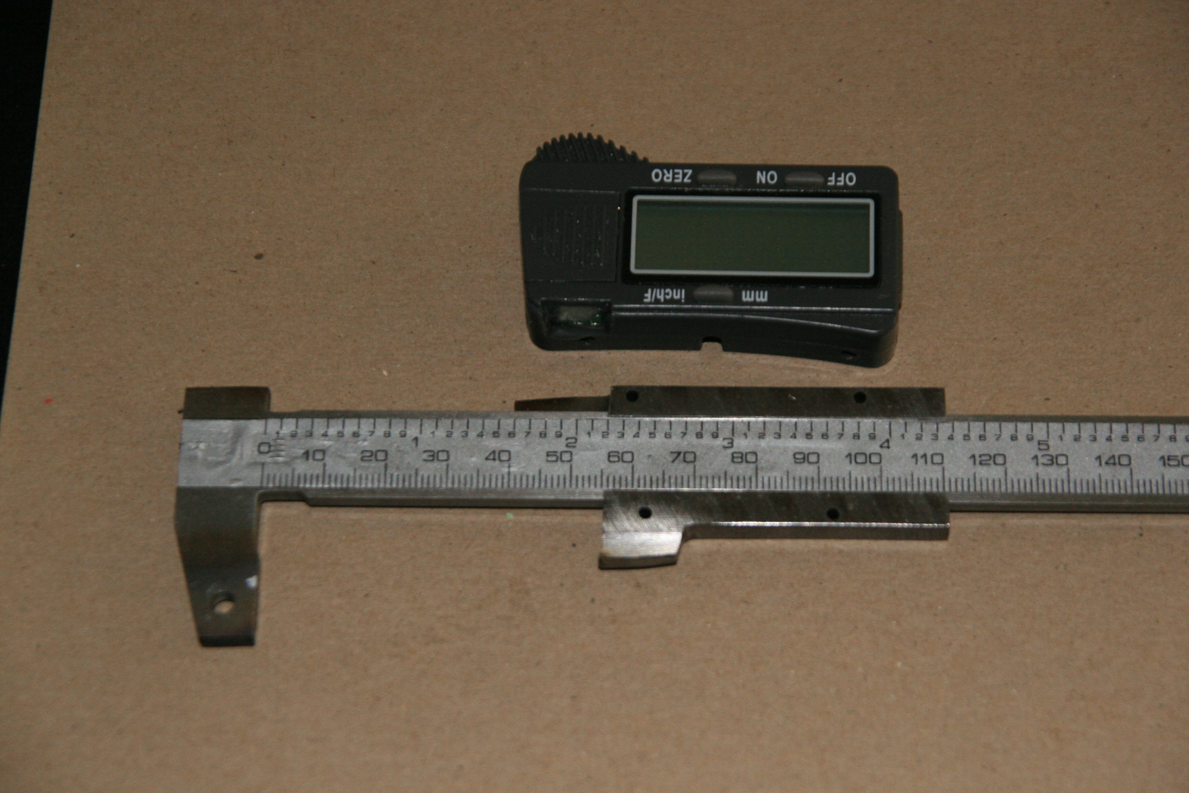

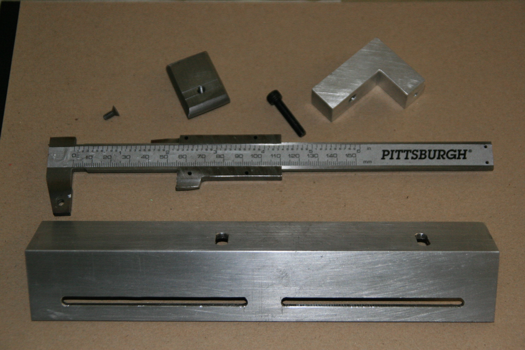

    So off to the shop. I used an older 10 buck HF digital caliper. Cut off the inside and
    outside jaws with an abrasive grinder, drilled and counter sunk one hole in the main
    body of the slider. Drilled one hole in the remaining part of the jaw for attachment
    to the carriage. Drilled and tapped one 6-32 hole in the carriage right rear as shown.

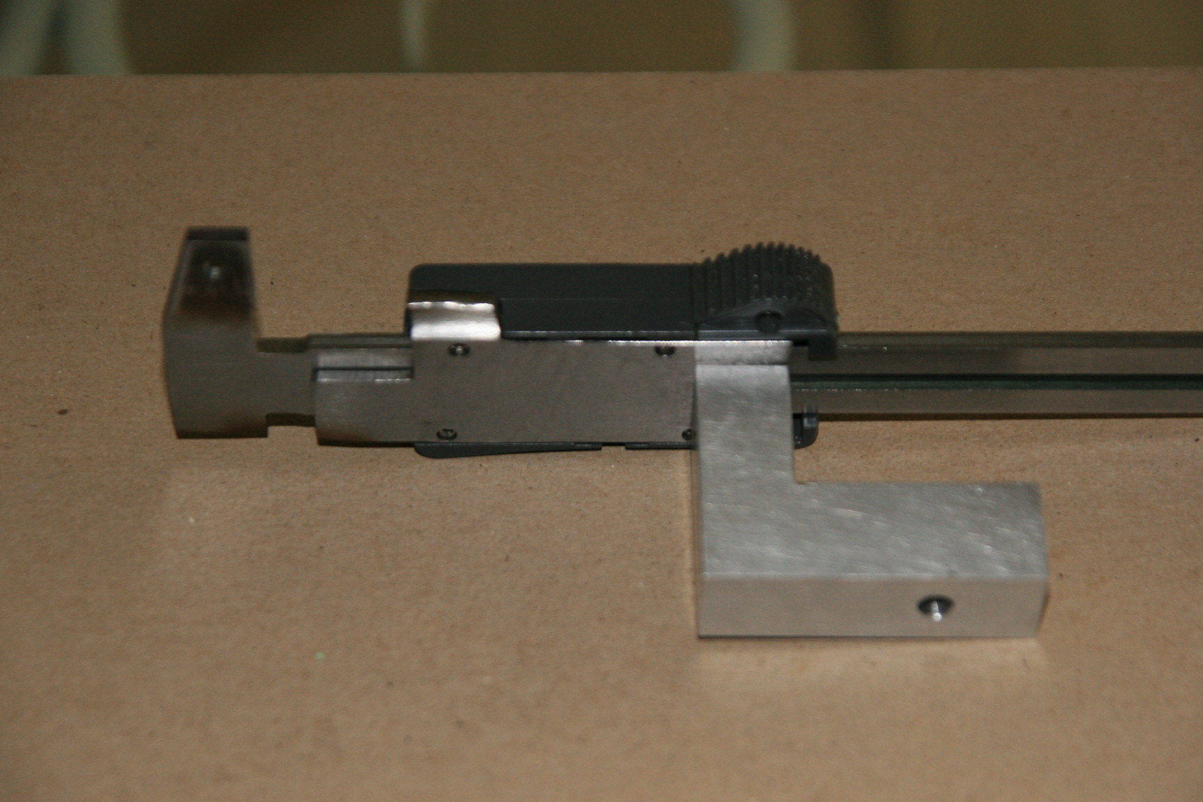

    One hole drilled in the carriage was all that was done to the lathe. The last part would be
    the large sliding nut that fits a 10-32 allen cap screw which holds the main mount and
    allows it to be positioned within the slots.
    Made one aluminum angle for the main mount. This angle has two vertical slots
    that line up with the holes for the rear chip shield that I previously removed and
    mounted on a small frame that sits on the bench. That makes it much easier to
    work with my taper attachment and clean up chips. It has two slots that the mounting
    block for the caliper can be inserted into. This allows the 6" caliper to read the
    entire 16" length of my mini lathe. The main mount may be located where most
    convenient for the part being turned. Six inches of continuous travel is so much
    better than using the 2" dial indicator that I had rigged up previously.
    Here are a few pics of the result of this one evening project:
    Cheers, JR

    Thanks Marv, The steel on the jaws is quite hard. I actually put the entire slide minus
    about 3/4" of the jaw in the aluminum jaws of the vise and tempered it prior to drilling.
    Then I just used a center drill and followed with a twist drill.
    The sliding frame at the rear was not that hard and I just center drilled, twist drilled and counter sunk for the 6-32 screw.
    I ended up distorting the facing on the slide a bit and would use some new smooth aluminum if I
    were to do another one. However I don't see any errors in the readings comparing it to my
    old dial indicator method. Time will tell how long it will last. It is very nice to use.
    Cheers, JR
