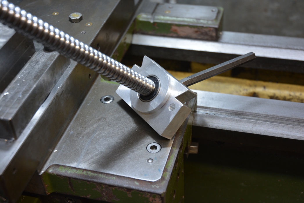

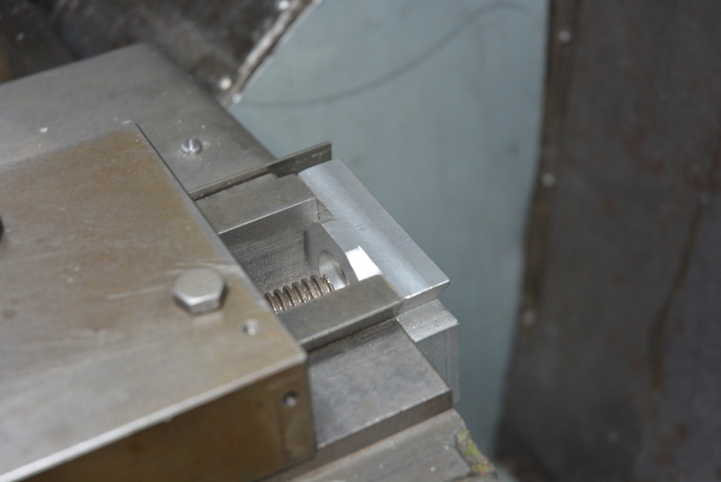

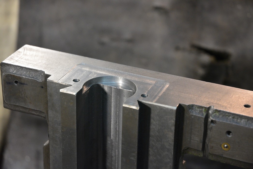

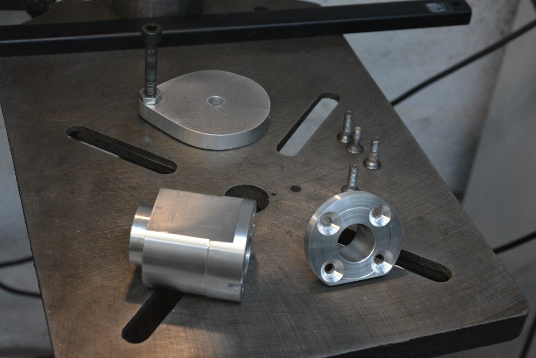

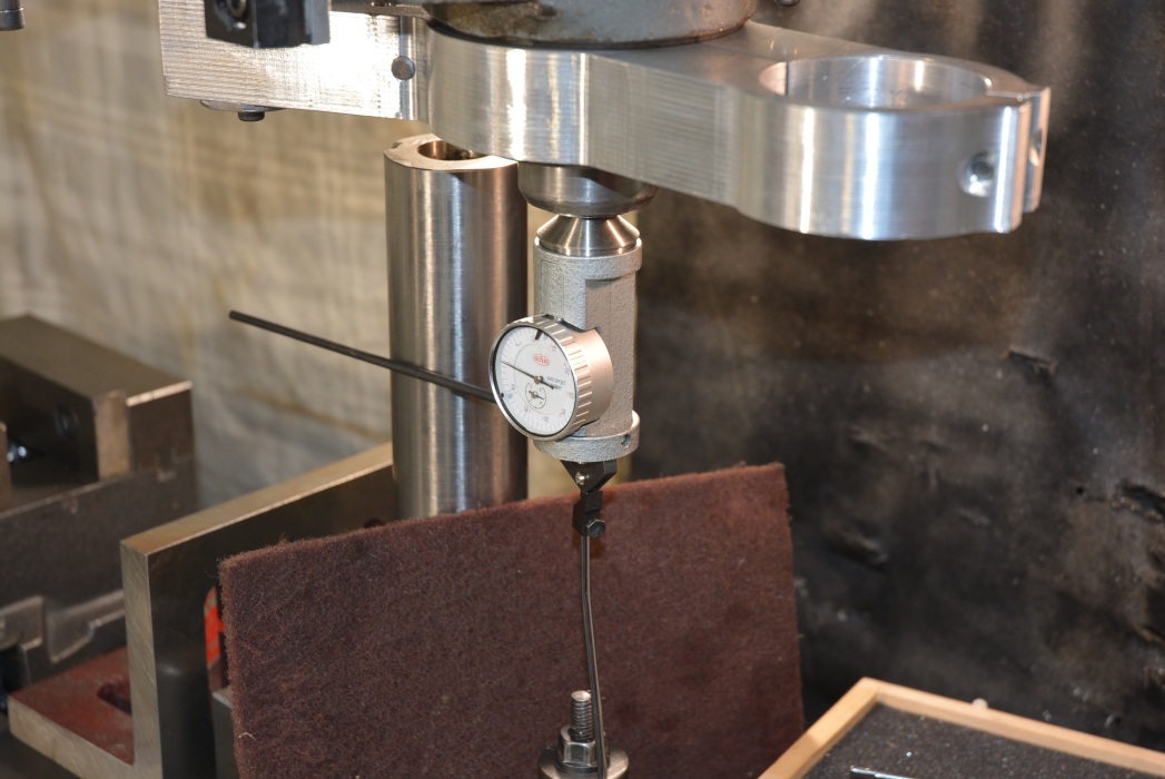

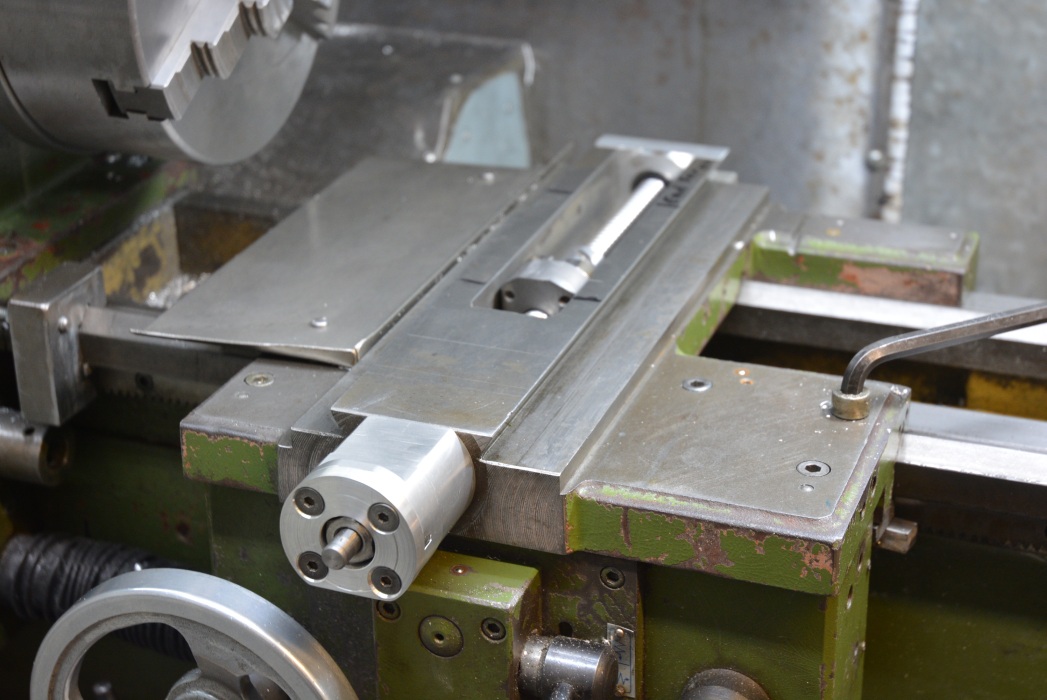

    I had a lot of backlash in the cross slide feed screw, which made it inconvenient to use and difficult to turn accurately. I have had the notion to change it to a ball screw running around in my mind for quite some time and recently I bit the bullet.
    Here is a video link:
    The original lead screw was 15 mm in diameter, the ball screws came in 16 and 14 mm. I choose the 16 mm which was a mistake, you can see in the video how much I had to cut off the ball nut to get it to fit. The 14 mm size would have made that easier and still been perfectly adequate. We live and learn.
    I am over the moon with the results of the conversion and have no hesitation in recommending it to anyone. There were some tricky setups needed to machine things accurately but they are fully explained in the video. Here are a few stills.
    Lathe cross slide conversion to a ball screw-ballscrew_05.jpg Lathe cross slide conversion to a ball screw-ballscrew_08.jpg Click thumbnails for full size.
    Lathe cross slide conversion to a ball screw-ballscrew_20.jpg Lathe cross slide conversion to a ball screw-ballscrew_17.jpg
    Lathe cross slide conversion to a ball screw-ballscrew_23.jpg Lathe cross slide conversion to a ball screw-ballscrew_22.jpg

    Excellent work Tony - and explanations are very good throughout, IMHO.
    For a while I've been on the lookout for LH <12 mm dia ball screws preferably with a ca 3 mm pitch w/o any success...
    Q: Isn't the movement so darned smooth now, that the cross slide will move when turning due to the unbalanced improvised handwheel?

    I have been unable to find a LH version also.
    No, there is no problem with unwanted movements. The action is very smooth but not loose, there is enough friction from the dirt seals to prevent back driving and the unbalance from the handle is trivial in comparison.
