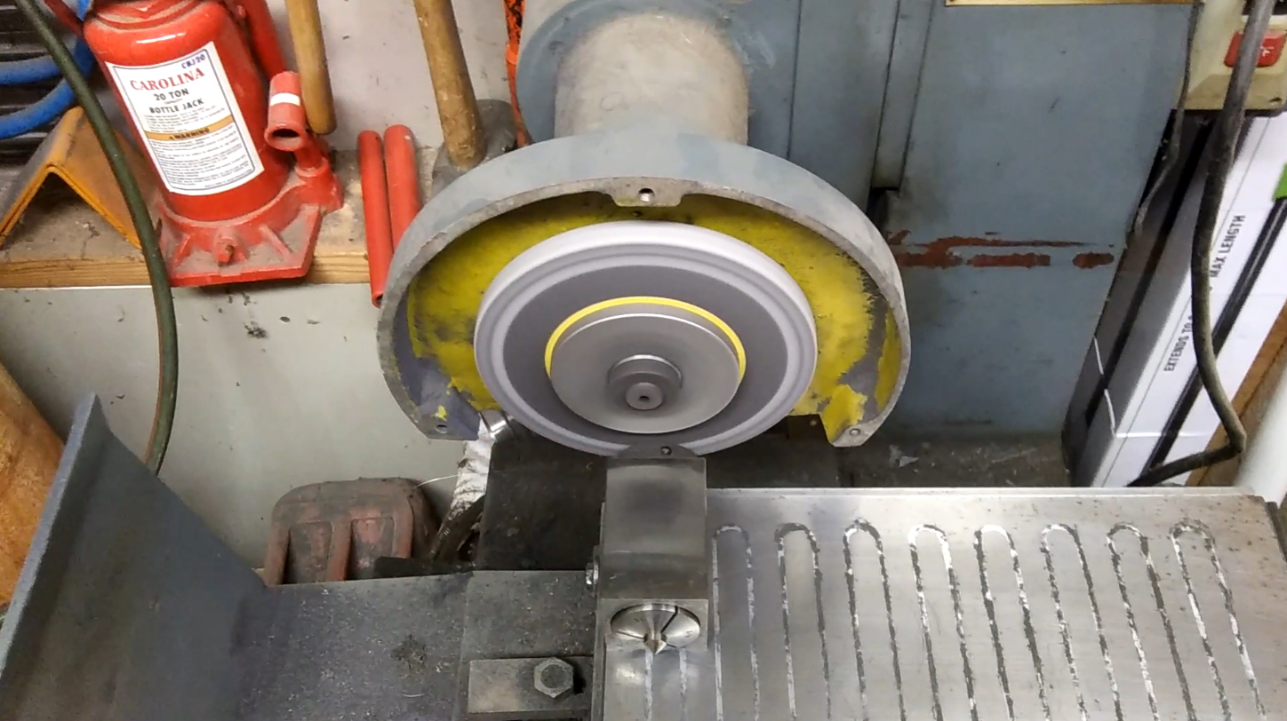

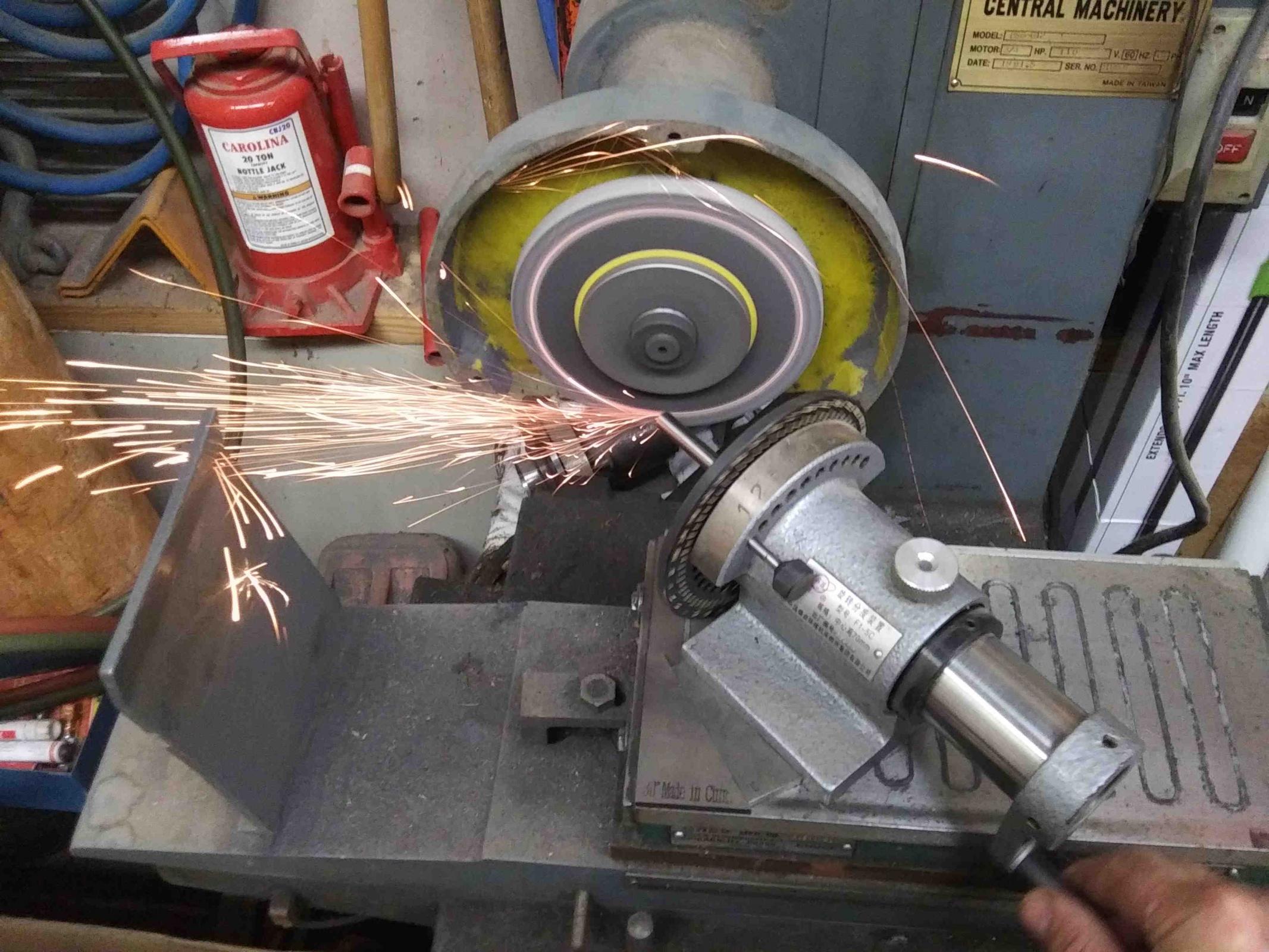

    I procured some HSS 9.5mm blanks from eBay. I used the side of my surface grinder wheel to put the 45 degree point (90 degree included angle).
    I used the 5C spin indexer for this operation;
    Lathe chamfering tool that gets into tight inside bores.-45-degree-point.jpg
    Pretty much I used the same process to grind the cutting edge to the HSS blank using a 5C square block, this ensures both ground cutters are in the same plane so when installed in the quick change holder, I can rotate to square to the work or parallel to the spindle;

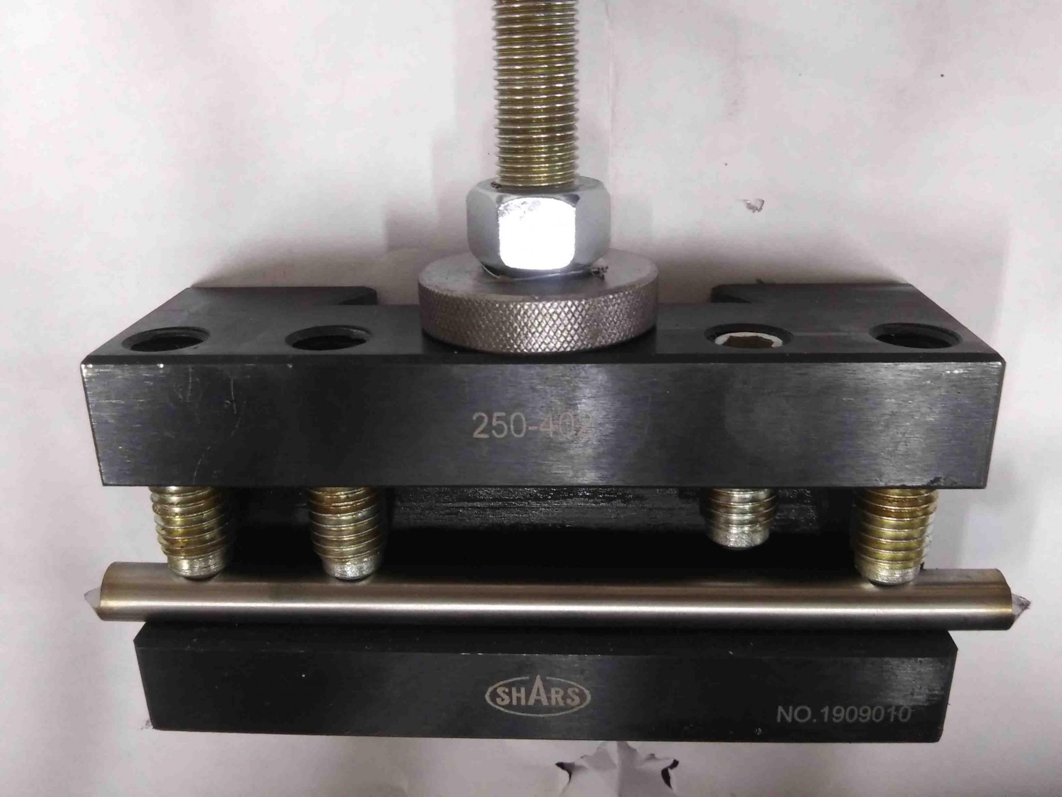

    I use the 400 and 100 series of quick change tool holders between my small and large lathe so I made 2 of these chamfer cutting tool bits.
    Lathe chamfering tool that gets into tight inside bores.-402-tool-holder.jpg
    I'm very pleased with how these work.
