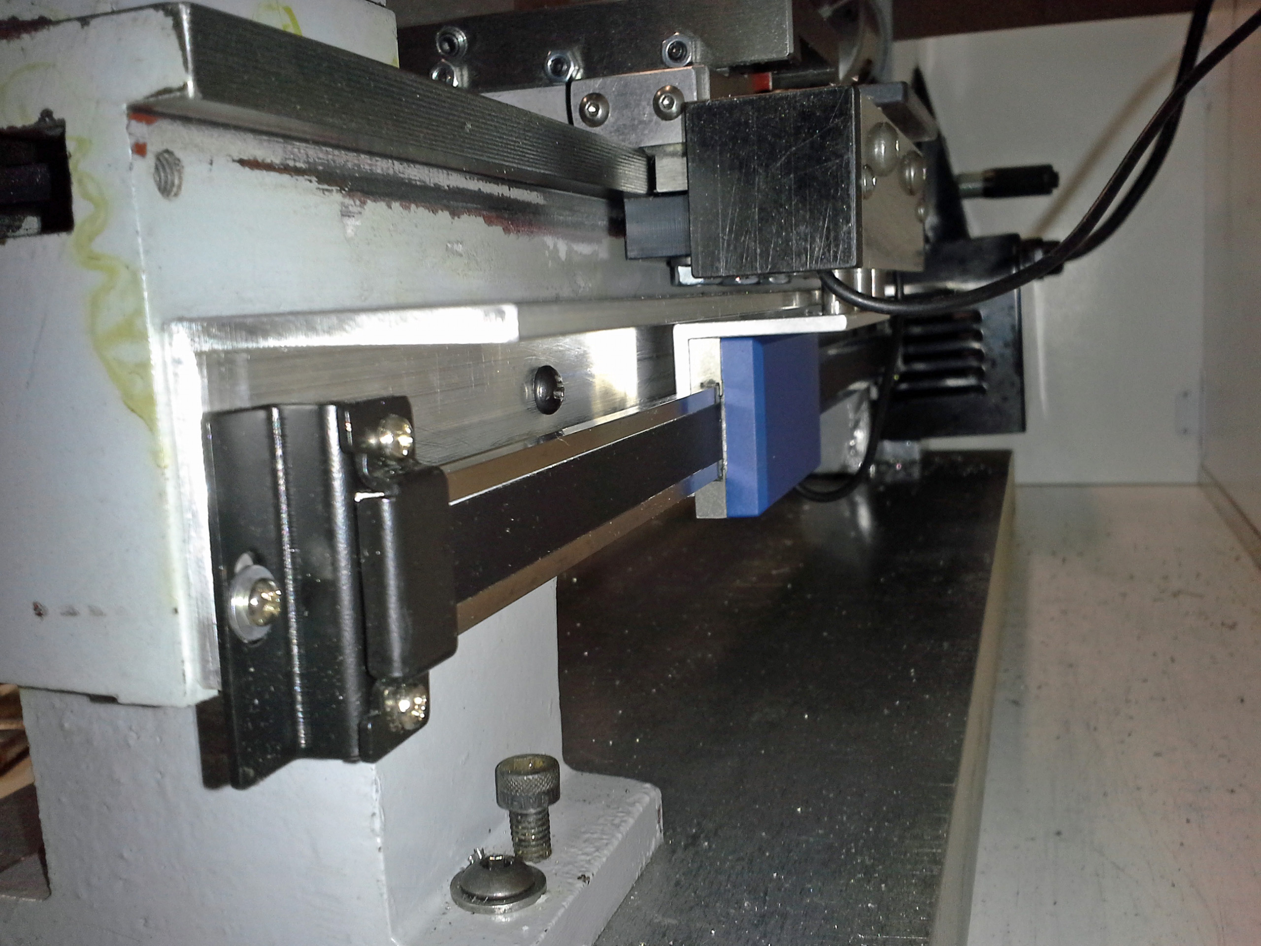

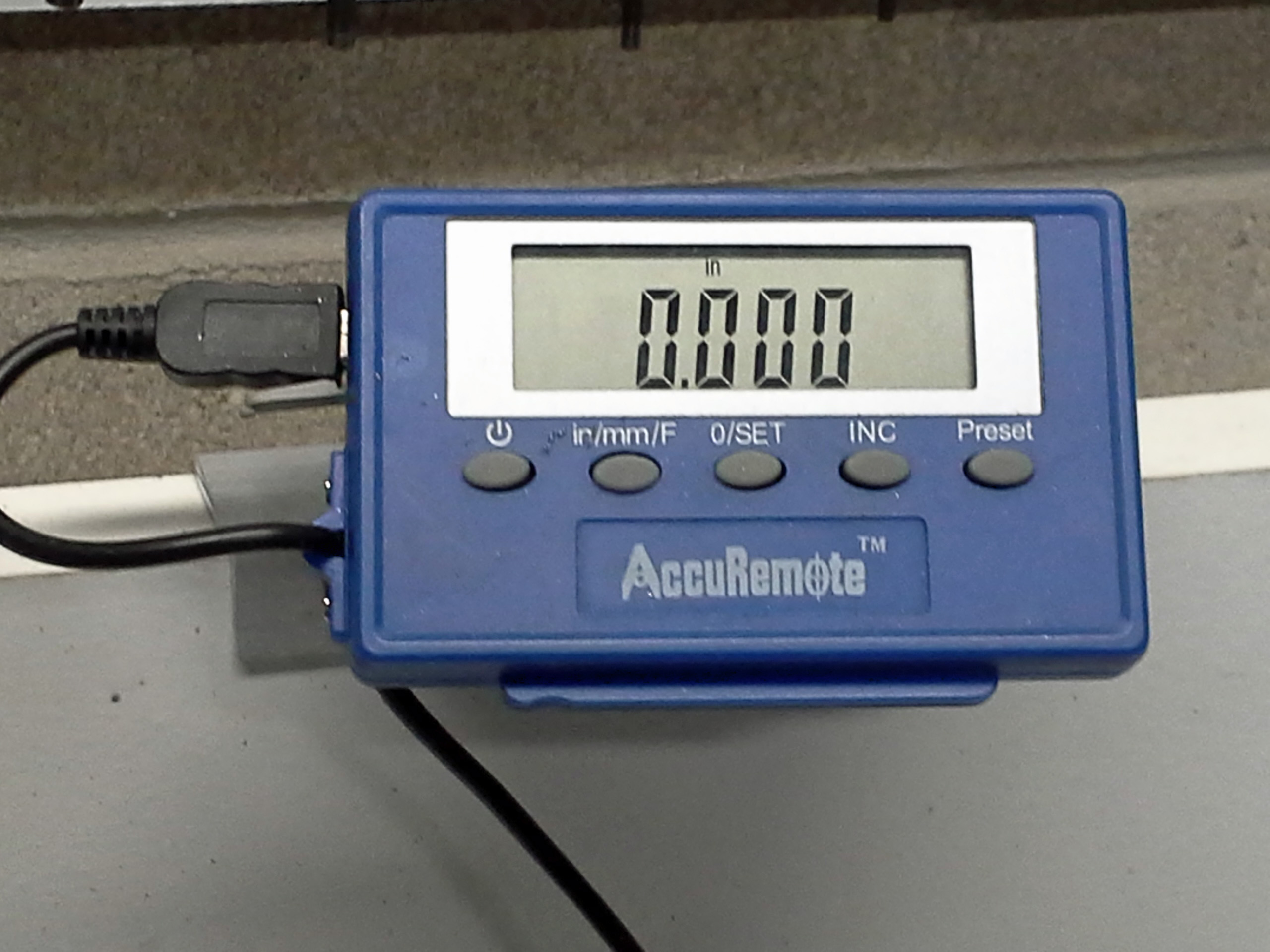

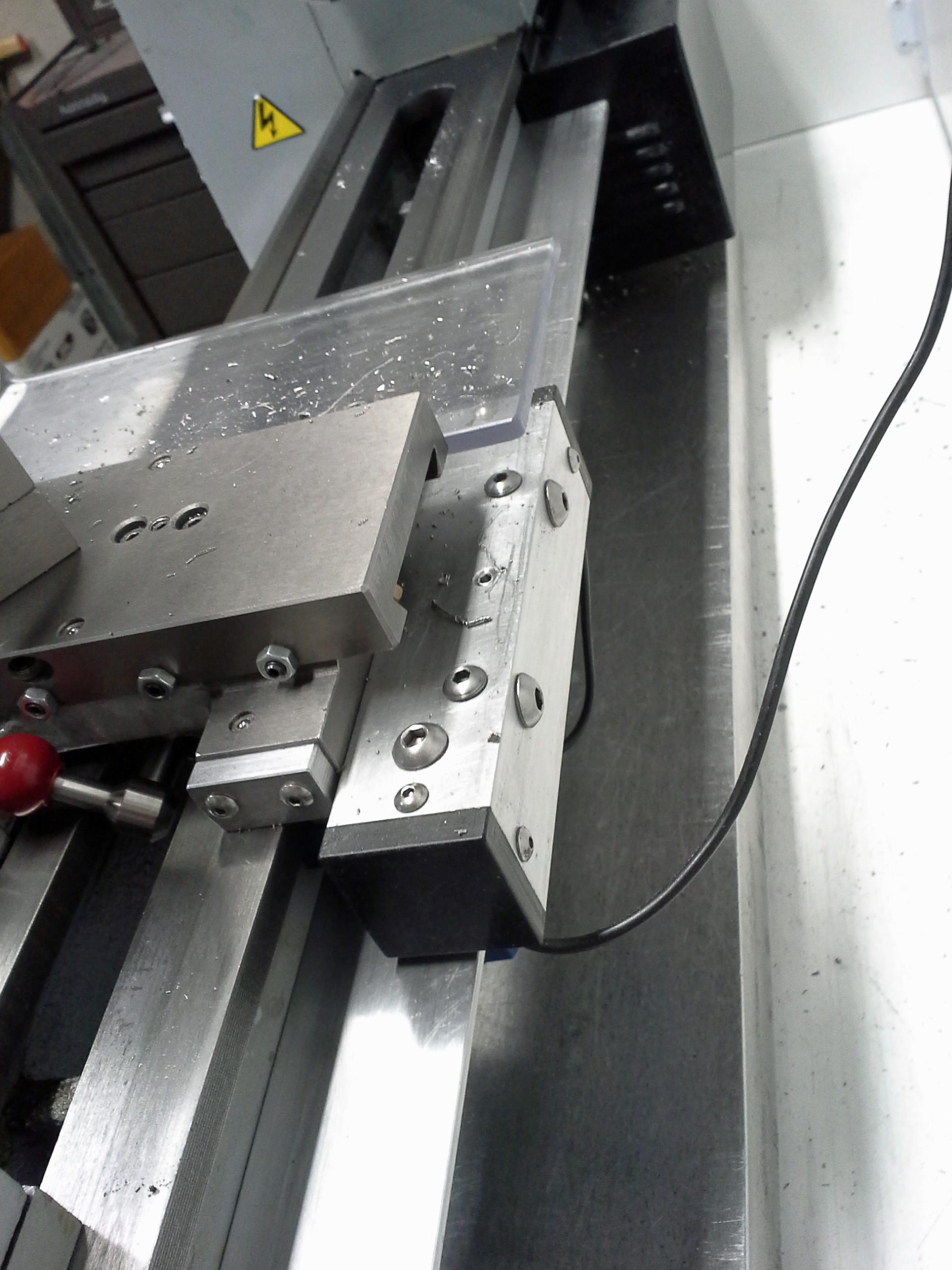

    Do a search on EBay for "Shars Digital Readout". It is just a low priced Shars DRO, but I have had it for over 6 years with no major troubles. The only issue was with fine cast iron dust on the scale and cleaning solved the problem. The one I bought was 24" long and has a scale that can be cut to length. It is fairly easy to install onto the backside of the bed. I installed mine under a piece of aluminum angle to protect it from swarf.
    Lathe Carriage Stop-7-x-16-lathe-dro-b.jpg Lathe Carriage Stop-7-x-16-lathe-dro-d.jpg Lathe Carriage Stop-7-x-16-lathe-dro-e.jpg
    https://www.ebay.com/itm/Shars-24-Di...S4~d:rk:3:pf:0
    I have added a link to the DRO on EBay.
    As for the chamfers on my tools; I mill them using a carbide single lip chamfering cutter of my own making. The chamfers are all the same size for a uniform look. Most of my tools are made from 4140 P.H. steel which finishes nicely using carbide.

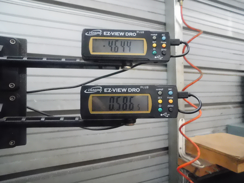

    Here's the DRO setup on my milling machine that I got from igaging, you can buy these individually and the scales can be cut to whatever length, the maximum length scale is 36", you can get these different lengths ready to go but they are still trimmable, 12"-18"-24"-36"
    Doug
