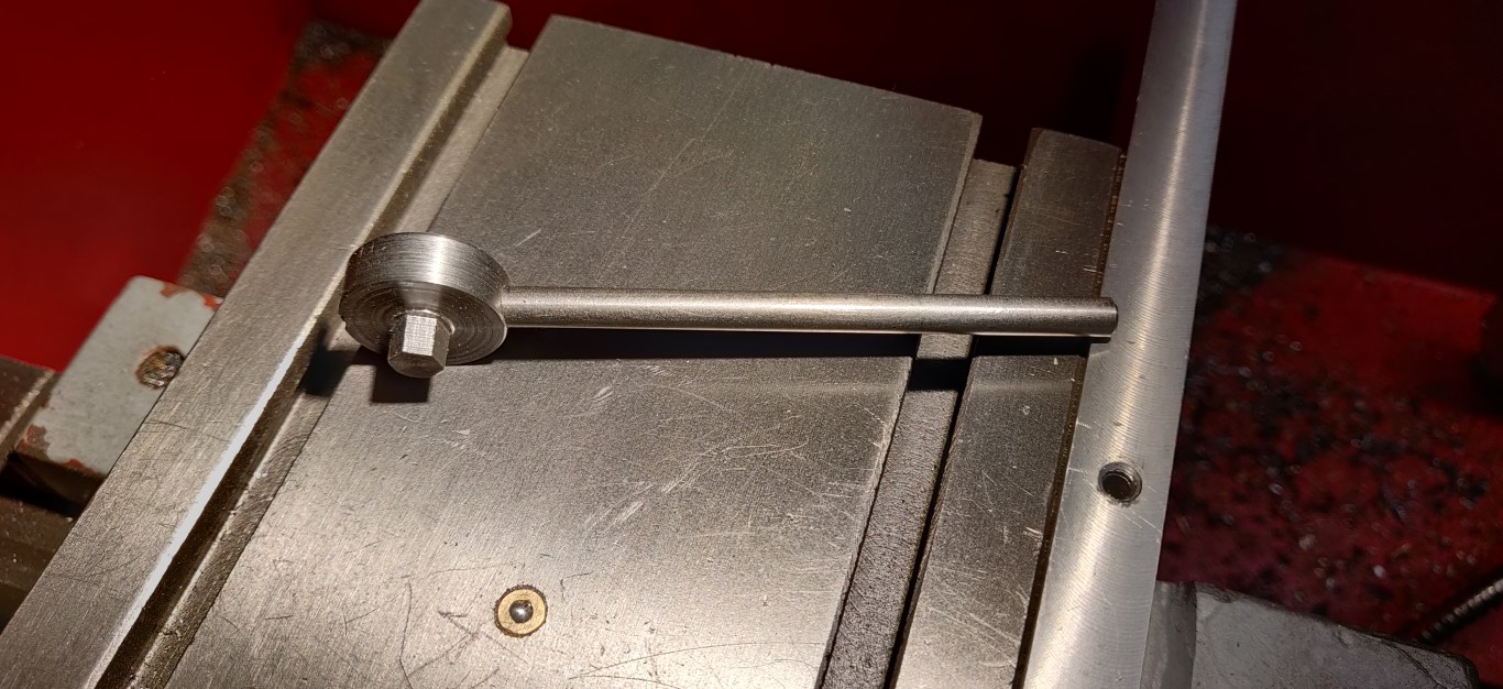

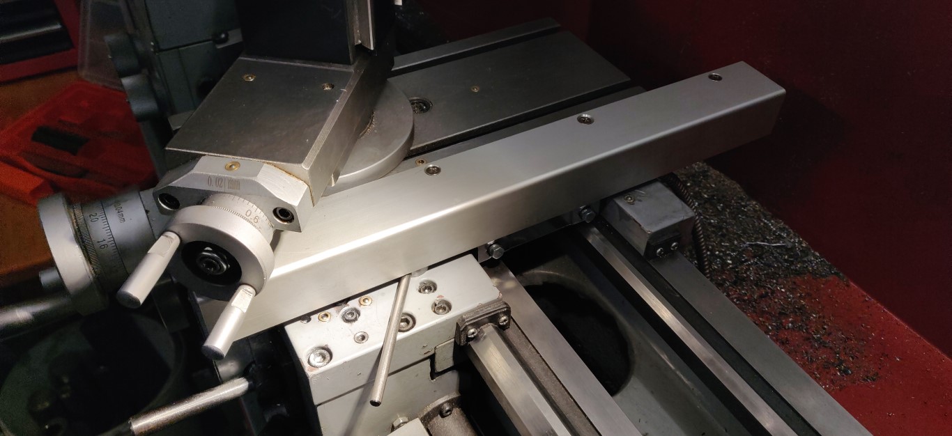

    After having recently installed my new DRO glass scale on my lathe cross slide, I had no more access to the carriage lock screw, which is quite annoying for some operations like parting off.
    So I decided to disassemble the scale and made a small contraption with a milled hex head and a cross pinned lever that could keep below the scale.
    Here are the pictures :
    Before :
    The low profile lever , made on the lathe, milled using a rotary table to form the hex key, lever is press fit in the head.
