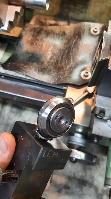

    Saw somewhere a fancy lathe burnisher using a sfere supported by a bearing.
    Sfere was used to apply big pressure in only one small portion of part beeing finished.
    Toll worked very well improving finish and I decided make one.
    but...
    While thinking about how I will do mine realized that I could design one easly if using a special bearing from a car tripoide axle to replace sfere and bearing. This bearing has an curved outter diameter that allow pressure be appied in only one point of part, just like sfere do.
    after a short trip to a junk yard, installed bearing in my boring bar AXA tool and here what I come with:
    Oiled part and first test results where impressive
    Definitly best finish on a mini lathe turning A36 steel I archived.

    Congratulations Cascao - your Lathe Burnisher is the Homemade Tool of the Week!
    This is a clever and resourceful use of a CV joint tripod bearing to create a burnishing tool. Fast, inexpensive, and the finish looks great.

    Quote Originally Posted by Cascao View Post
    but...
    Spherical contact is the most logical. Rollers are used for internal burnishing, dwell time time would likely create tapers.
    Burnishing is just like knurling, pushing instead of cutting material.
    Interested in what feed rate worked, guessing tells me about 1.5x the rate surface was cut, and were there any measurements taken before and after?
    All that questions if set at a slight incline would even work better.
