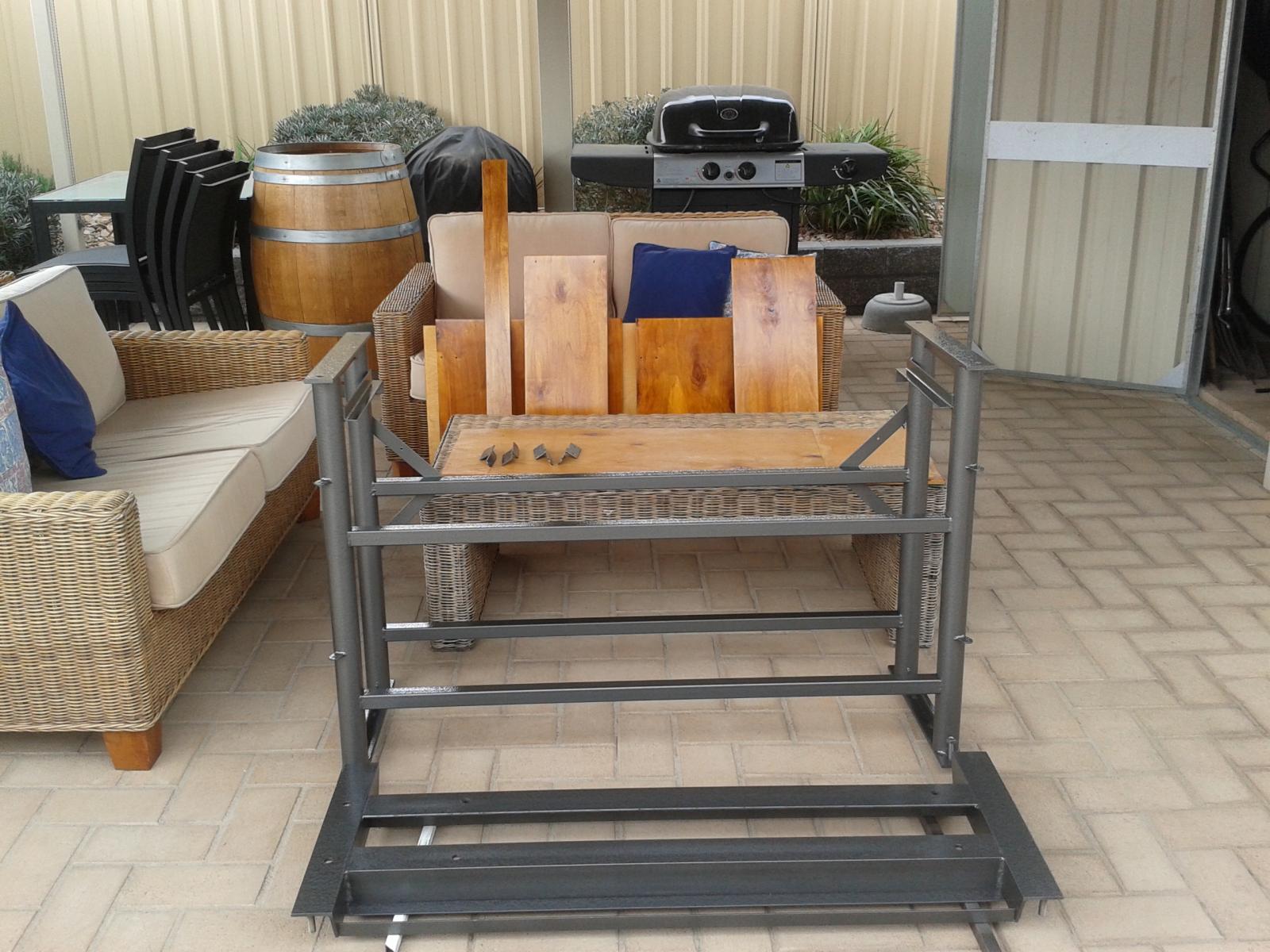

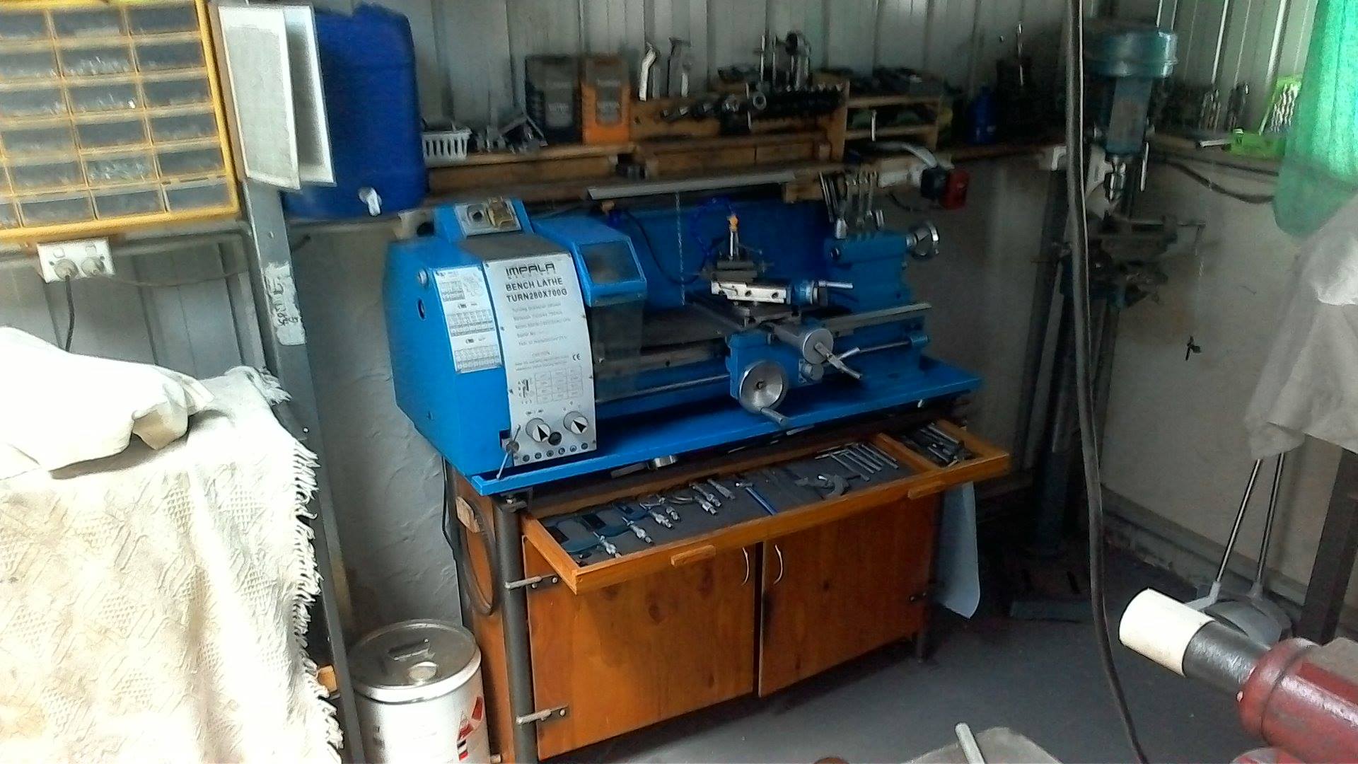

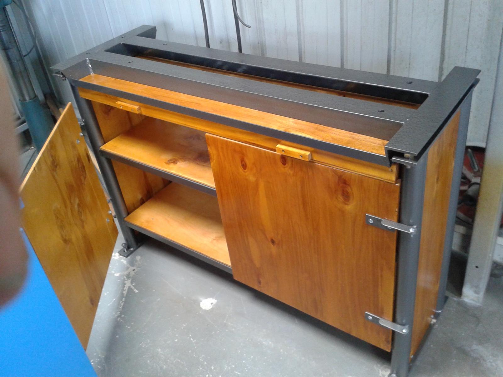

    This is a lathe stand I made about eight years ago, it has a built in system for trueing the bed, takes just a few minutes to do it. The video demonstrates how it works.

    th62,
    Well done and practical to have!
