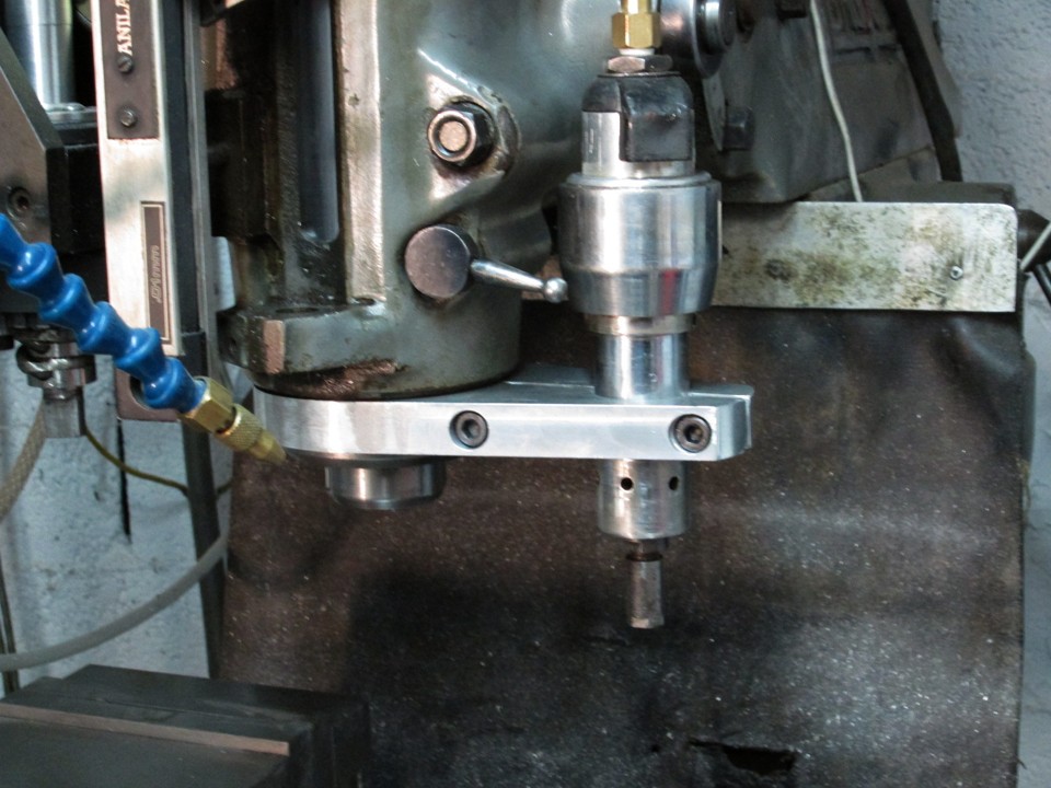

    Not a router but a high speed spindle, runs at 24,000 rpm. In fact I am right now preparing a new post about this subject.
    Here are a couple of pix.
    Laser Printer Toner Transfer With Kitchen Parchment Paper and a Laminator-makingclamp-01.jpg Laser Printer Toner Transfer With Kitchen Parchment Paper and a Laminator-spindle-mill.jpg Laser Printer Toner Transfer With Kitchen Parchment Paper and a Laminator-testingflatness.jpg
    In the past I have made PCBs by etching, by drilling holes from a simple drill jig and using the holes as references to draw tracks by hand with a "resist" pen, before etching.
    That is messy and now that I have a CNC mill I prefer making tracks with isolation milling. This will be clear in the upcoming post.

    I got mine off the Spanish eBay. It is usual to buy a spindle and VFD package like this one
    https://www.ebay.es/itm/UK-2-2KW-ER2...6Y19:rk:3:pf:0
    However, I bought mine separately because I wanted a more powerful VFD to drive the 5 hp main motor on my mill. http://www.homemadetools.net/forum/h...idgeport-56661
    Currently if I switch between the main spindle and the high speed one then I have to reprogramme the VFD to change between 0 - 60 Hz and 130 - 400 Hz. It only take a few minutes but it is an inconvenience, VFD prices have come down and I'll probably buy a smaller one dedicated to the high speed spindle (probably when I finish writing this).
    Even with a 6000 rpm machine the surface speed is too low for small cutters in Aluminium so the high speed spindle is a great addition and I am pleased with it. Because it is clamped to the quill of the mill the Z motion is as normal, manual or CNC controlled. It is important to make a rigid clamp. I have seen some on the net that I regard as too flexible. My quill motion is reduced by the thickness of the clamp bracket but that is a small price to pay.

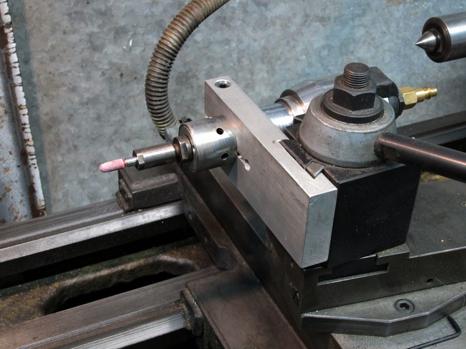

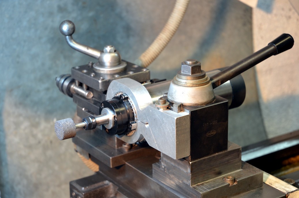

    Before getting this electric spindle I occasionally used a high speed pneumatic turbine, shown next, but that bogged down under load too easily.
    Laser Printer Toner Transfer With Kitchen Parchment Paper and a Laminator-airgrinder-mill.jpg Click thumbnail for full size image.
    Here are pix of each type on the lathe.
    Laser Printer Toner Transfer With Kitchen Parchment Paper and a Laminator-airgrinder-lathe.jpg Laser Printer Toner Transfer With Kitchen Parchment Paper and a Laminator-spindle-lathe.jpg
