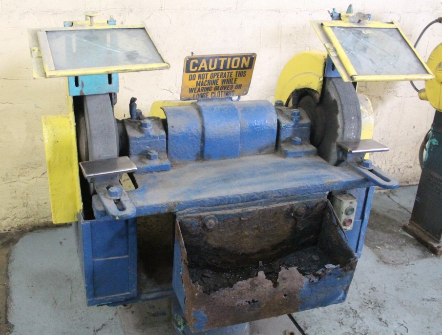

    I Binged double ended snagging grinder found this
    it is called a 34" double end snagging grinder but the wheels don't look anywhere near 34" in diameter

    5,338
    7,048
    Agreed Frank S. Judging scale of Catfish's grinder to face shield hanging on it, might the binged one have 34" between the wheels? Not unless the caution sign is size of a billboard....looks like nothing but big bench model, no pedestal. Even if the wheel guards and tool rests were retracted its not more than 18-20". It's not a motor powered shaft, it looks like the pedestal housed motor and a belt drive. That design allows more clearance inside of wheels, compared to a 6 or 8, armature housings always in the way.
    Anyone wonder how long a grinder gets ignored to rust out the water tray like that?
    Found this fast, nothing in size like what I described earlier post #2.
