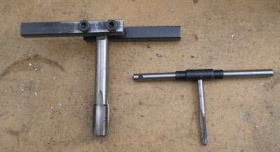

    Large Tap Wrench
    Two square bars, drill through and tap, couple of bolts to hold it together, pretty simple really.
