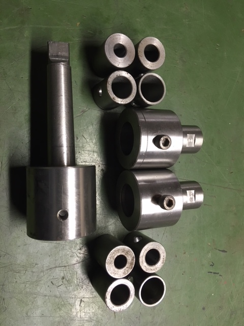

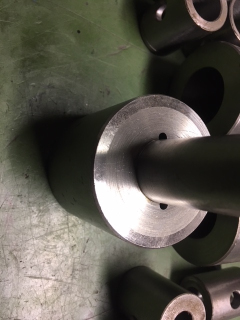

    I made this sidelock collet holder to take slot drills with shanks up to 32mm/1.1/4” diameter with a No. 3 Morse taper so I could use it in the tailstock of the lathe.
    After drilling a blind hole which needs to have a flat bottom, this tool works well to take the remaining material the drill point has left. I find this a lot quicker than grinding a flat bottom drill or trying to use a boring tool to take this excess material out.
    This is handy when several components need to be machined as a large amount of material can be removed ready for finish boring.

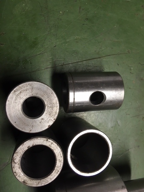

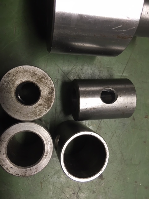

    metric sidelock collets with ring to identify
    imperial sidelock collets
    two holes to push sidelock collets out from main housing

    Not trying to highjack thehomeengineer's post, just donating some clarifying terminology.
    For those on west side of Atlantic Ocean, in Britain and her many colonies 'slot drill' equal our end mill. Slot drill is a more descriptive name than end mill, certainly can drill; guided by a spindle. Drills do not have actual cutting edges on outside diameter, so they can be used in handheld equipment.
    We call these tool-holder bushings. To us, collet signifies retention via gripping fingers, bushing is a cylindrical spacer or adapter body.
    Shop or commercially made, the set screw is positioned over flat seen on end-mill shanks.
    The location is quite standardized by diameter in keeping with design known as 'Weldon Shank' found in my numerous links...

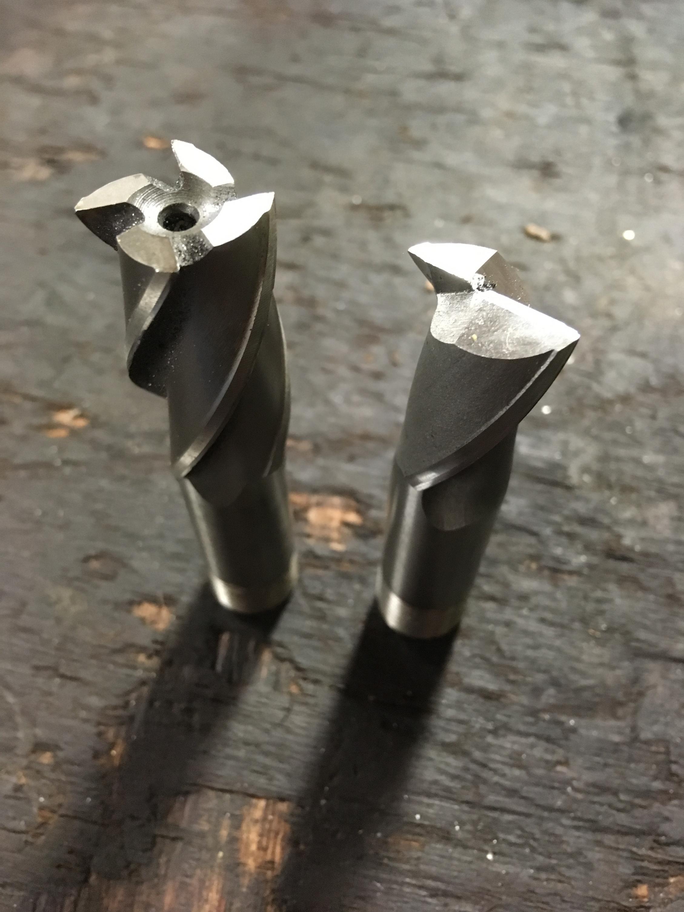

    Thank you and sorry if I have created some confussion. Over here (UK) we use both (HSS) Slot drills and End mills. Generally for milling applications. Slot Drills tend to be two or three flute cutters and have the ability to plunge in to the solid workpiece (drilling) and then travel along the work piece (example cutting a blind keyway in a shaft) as one of the flutes is ground over centre. An End mill generally has more than Four flutes and can not plunge in to the workpiece as the cutting edges are equal and do not cross the centre. (example cutting an open ended keyway)
    I hope this has cleared up any confussion I will post a photo later of the two types of cutter.
    Thank you again

    Here is the photo of milling cutters and identification
    The left in the UK is an End Mill and the Left a Slot Drill

    Quote Originally Posted by thehomeengineer View Post
    Hi Toolmaker51
Name:	milling cutters.jpg
ID:	22509 Yes, partially. In US both are endmills, capabilities ID'ed by number of flutes.
